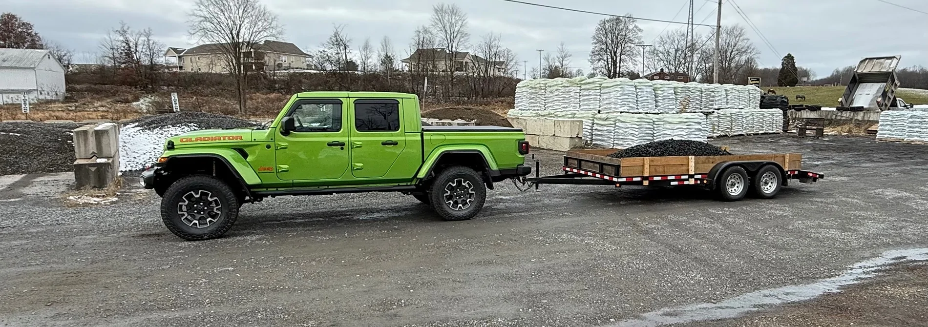

I have a 2025 Sport S Max Tow package with the 4.10 gears, and I tow a few times a year hauling coal to heat my house and I own a 71 Dodge Dart that I haul a couple hundred miles away to a car show. It does the job but not ideal in my opinion.

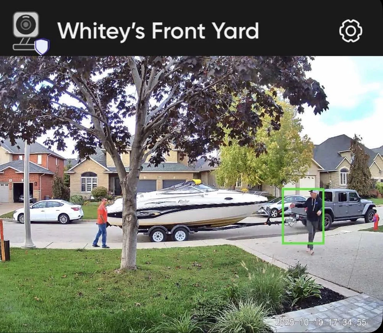

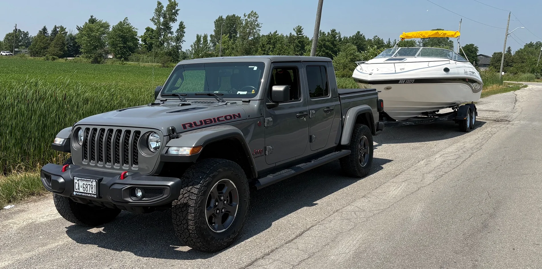

I’ve been pulling our 24’ cuddy around for a couple years without any issues. You know it’s there on a bumpy road but highway driving it hauls along beautifully. I’m not sure I would want to haul it across the country but the Gladiator would do it without issue.

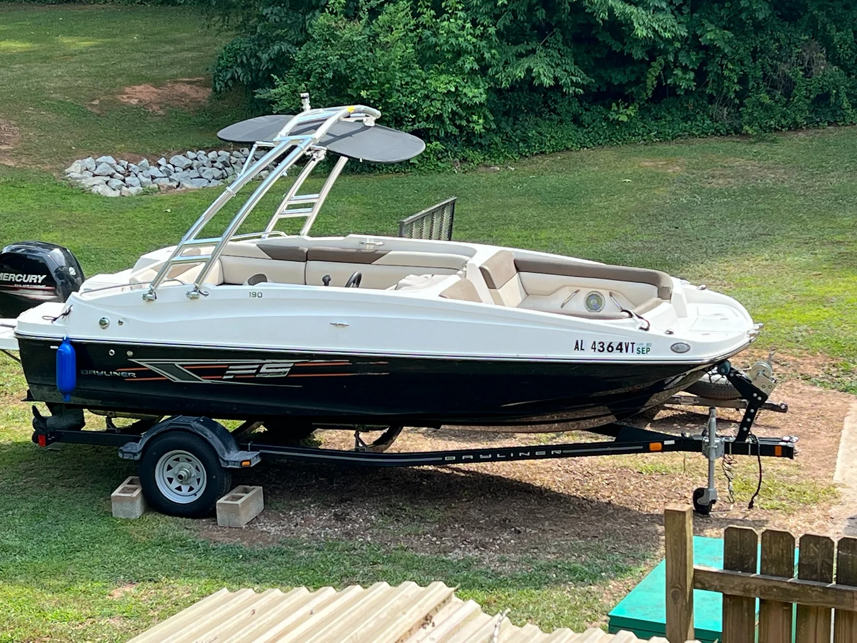

[Forest Gump voice] That's my boat...[/Forest Gump voice]
That's a 5K axle on the trailer, and from what I've seen with fuel and lake toys it's every bit of it. You definitely know it's back there, really gotta get into the engine on hills, but at the end of the day I've never felt unsafe, just inconvenienced. Admittedly I haven't had an emergency stop situation where I had to get on it quickly, but as long as your total package is 85-90% of the actual GVWR of your truck+Trailer combined, I would think you would be okay, but take the free advise for what you paid for it. if you're spending a weekend in that cuddy remember to add all the weight of you, Passengers, Coolers of lake sodas, food, lake toys, ect.... You realize just how quickly you come up on that GCWR.
I am on 37's and 5.13's, it would obviously pull a lot better stock

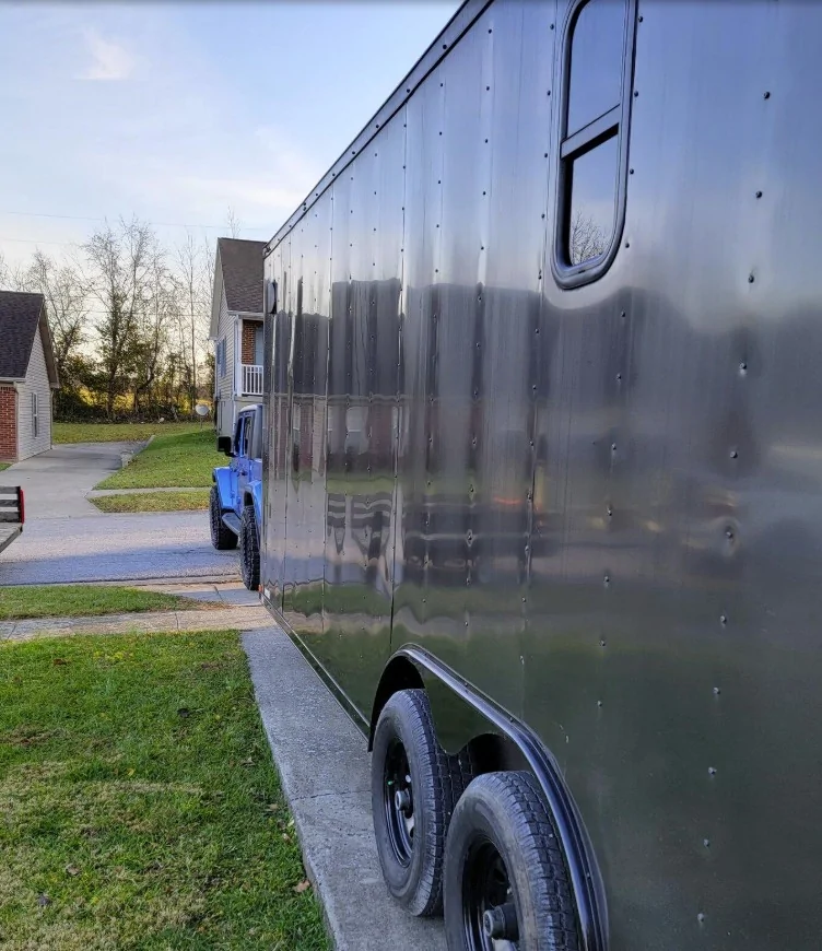

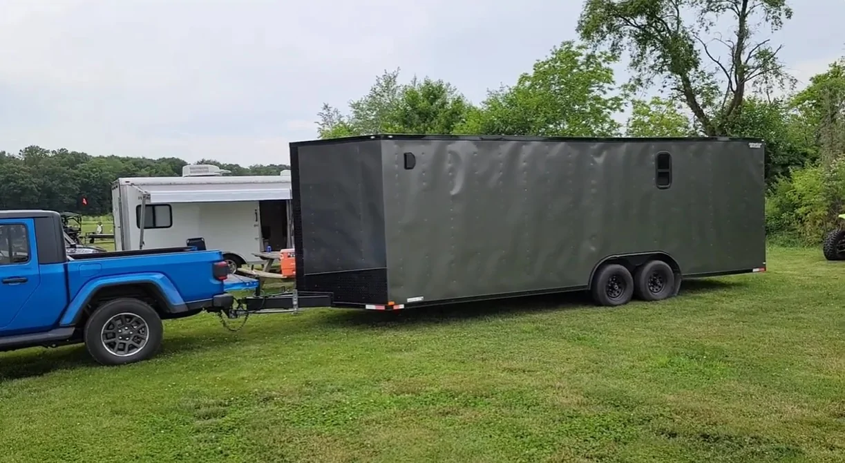

The problem with enclosed trailers isn't the weight so much as it is the lack of aerodynamic profile. I'd drag 7,000 lbs. around with no issues at all, except having to stop at the fuel stations frequently!
