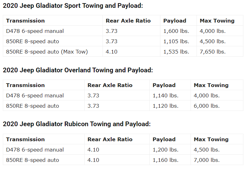

Looking at the chart above @ShadowsPapa posted above:
I get the auto Rubis and Maxtows with lower gears and wider axles.
Buy why can the auto Overland tow #6000 and an auto Sport non-max tow only tow #4500?
Same axles and gears. ???? The manual tow ratings are the same between the two.
What am I missing?

My bet is COOLING - alternator size, etc. for the fans. Of course there's tires, springs and the weight of the vehicle itself as part of the equation. Not just gear ratios and axles.
There were I believe 3 different alternators and fans as well..
The manual ratings would be the same because they are well under what the rest of the truck can do and the cooling system can handle.
I think they could have equipped the autos equally to have the the same #6000 rating.
My mind tells me the bean counters were involved! $$$$

The taller tires on Rubi affect the gearing compared to max tow. Also the Rubi with auto is good for 7000 lbs not 6.

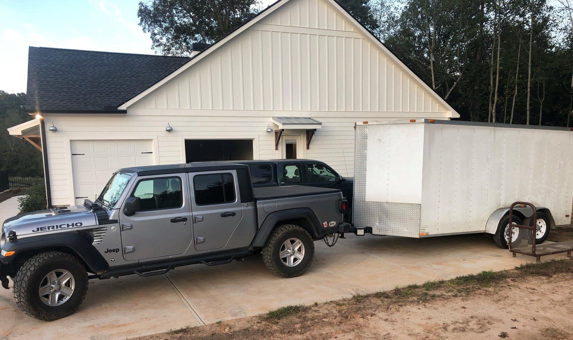

Dwayne Turner
Jun 24, 2019
56
Canton, GA
2020 Jeep Gladiator Sport S
I pulled this trailer from Canton Ga to Charlotte NC and I was very impressed.
