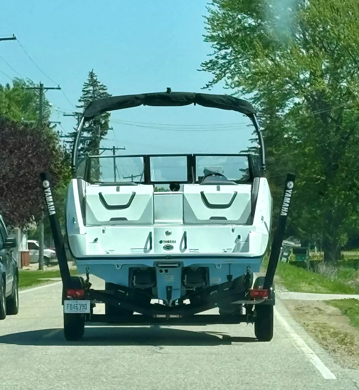

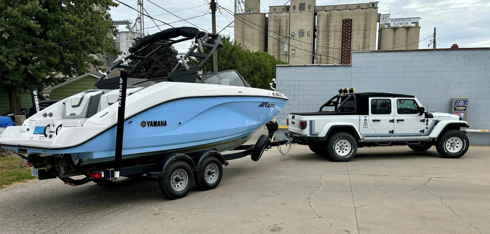

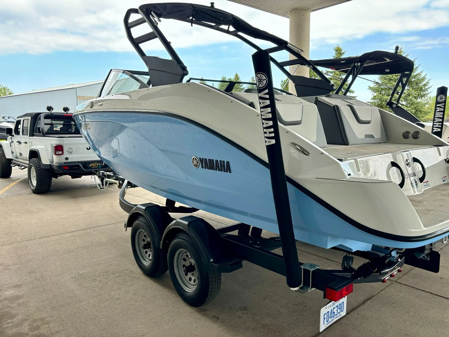

I've hauled a few boats with my 2021 Max tow. 24 foot pontoon's and a 24 foot tri-toon, 18 foot center console, and 2 years ago I bought a 22 foot twin engine jet boat with a wake tower. Its a big boat for a 22 footer, total weight is about 6000lbs. Everything but the new Jet boat was easy peasy.
The dealer was 120 miles away from where I keep the boat. While it pulled the boat fine, I would not want to pull it at highway speeds that far every weekend. Nope.
The truck definitely knew it was back there. In a strong cross wind, it will push the Gladdy around a bit. I try to stay off highways as much as I can when I am towing it.
If your only going 30 miles on flat land and a only a few times a month, should be no problem.
You also don't mention if you plan on keeping the stock tire size of the Mojave / Rubicon or going bigger? I was on 35's with 4:10 gears so I am sure the stock 33's and 4:10's would make it tow better then my set up.

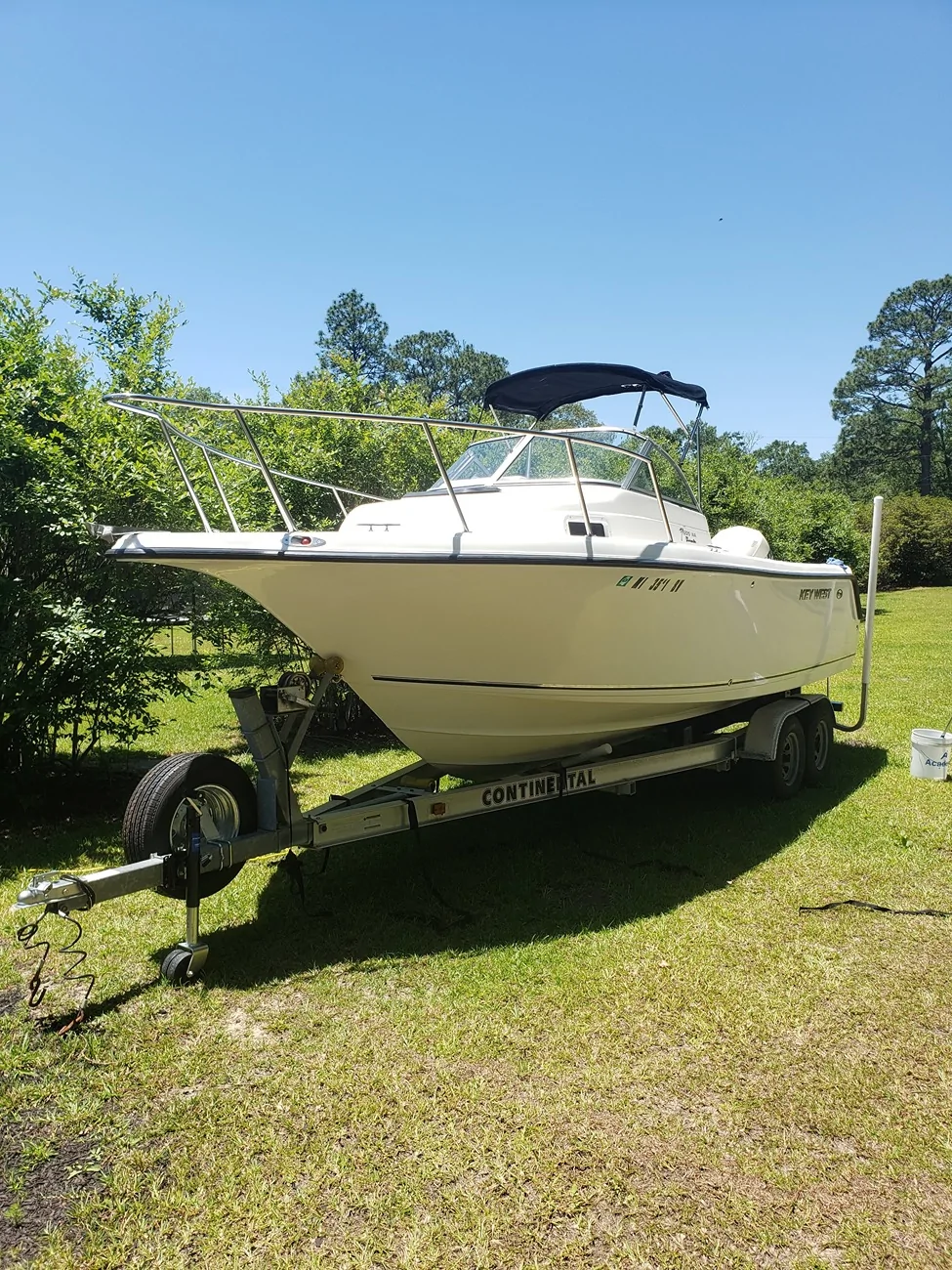

I’d keep them the stock. I like the rubicons and Mojave’s just the way they are. In regards to 4wd I learned my lesson long ago about using it on a ramp lol. Didn’t lose it but damn near did lol. I live in south Mississippi on the gulf coast. It’s mostly a flat tow with 1 or 2 steeper bridges….I’ve dropped a pic of the boat for reference. Also how’s the sag on the backend of the Rubi vs Mojave? I’m sure the Mojave is worse.

Good looking Key West WA cuddy.

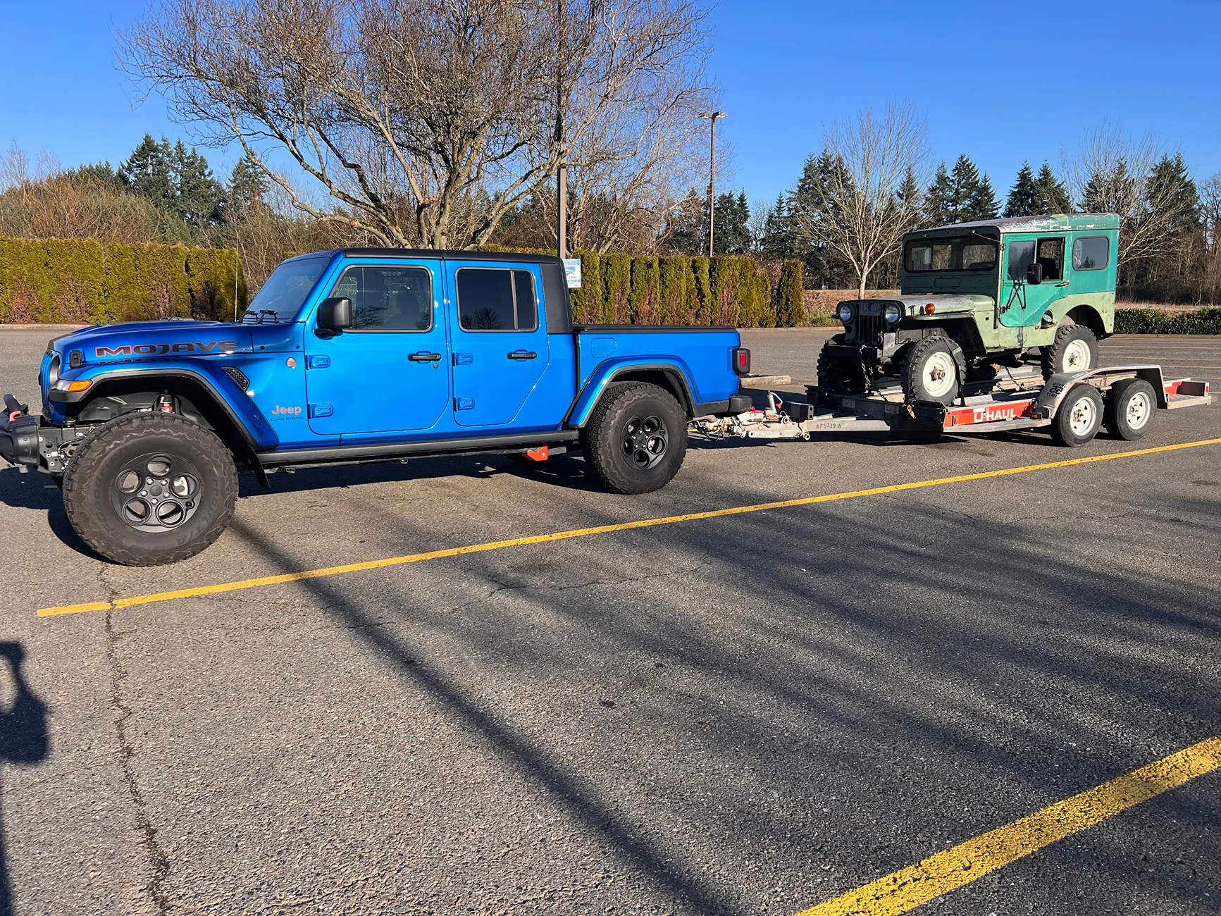

I have a 2023 Mojave on 37s. Just this weekend I towed a roughly 5,000lb car/trailer combo for about 150 miles. There was some modest squat and RPMs were higher than the norm but towing always felt steady. I am no towing expert but am confident to say that if I was going to buy a dedicated tow rig where your number one requirement is great towing then it would not be a Gladiator. If you value all the other features that a Rubicon/Mojave offers (great off road capability etc) and want a weekend towing rig, then the Gladiator should be given serious consideration.

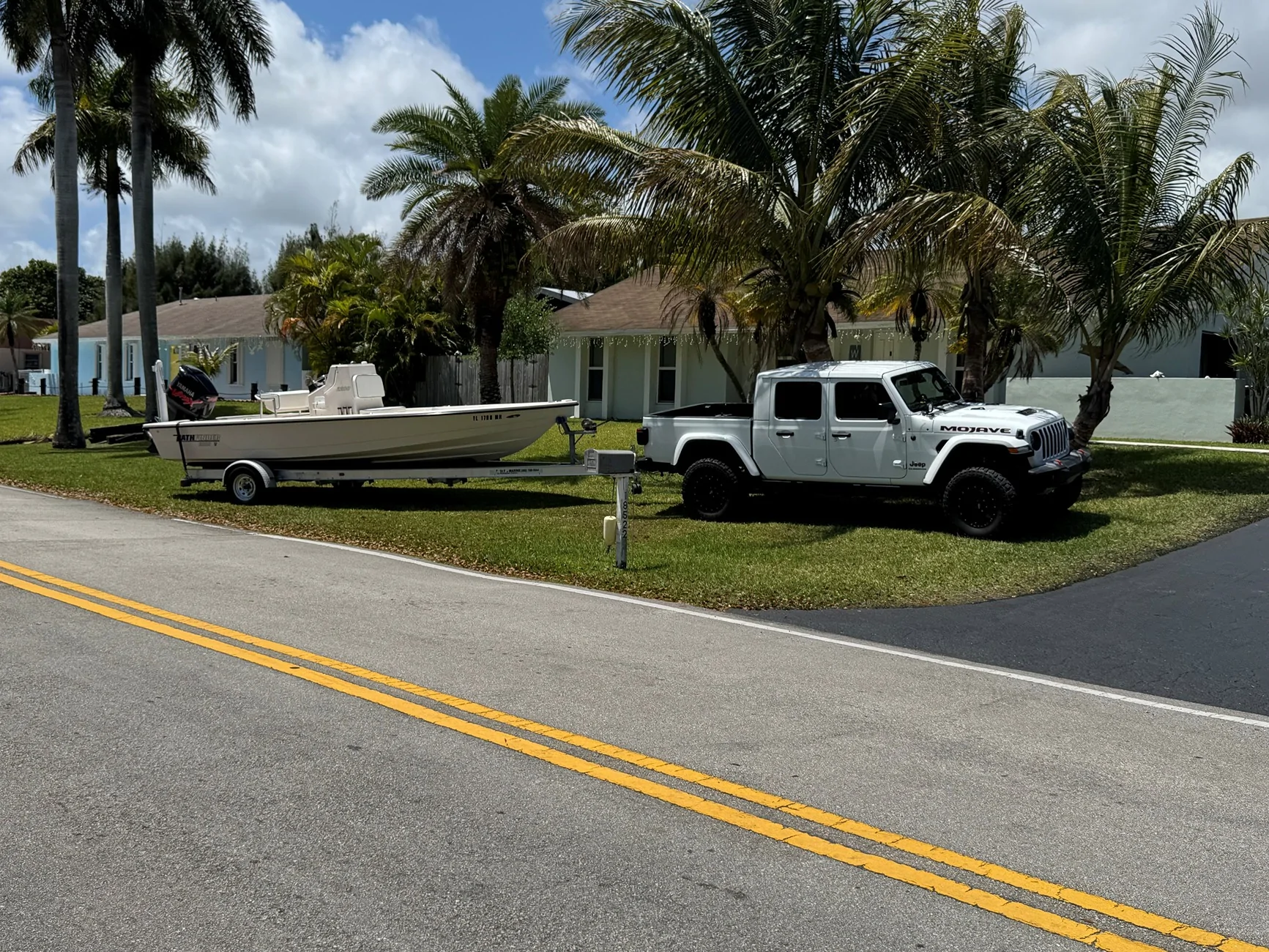

I have a 2021 Mojave with a 2" AEV lift, 35's, and 4.10's. I use it to tow a 22ft bay boat and also a 6x12 open trailer with 6 passenger golf cart. At highway speeds it is difficult to maintain 7th gear if there is any kind of uphill grade or head wind. I mainly drive in manual mode when I tow. I anticipate grades and down shift or upshift accordingly. When pulling around town or to local ramps, automatic works just fine.
It is very stable and planted for a mid-size truck. I feel very comfortable towing a couple hundred
Jeep Gladiator Rubicon vs Mojave boat towing pathy and mojav
miles with it.
