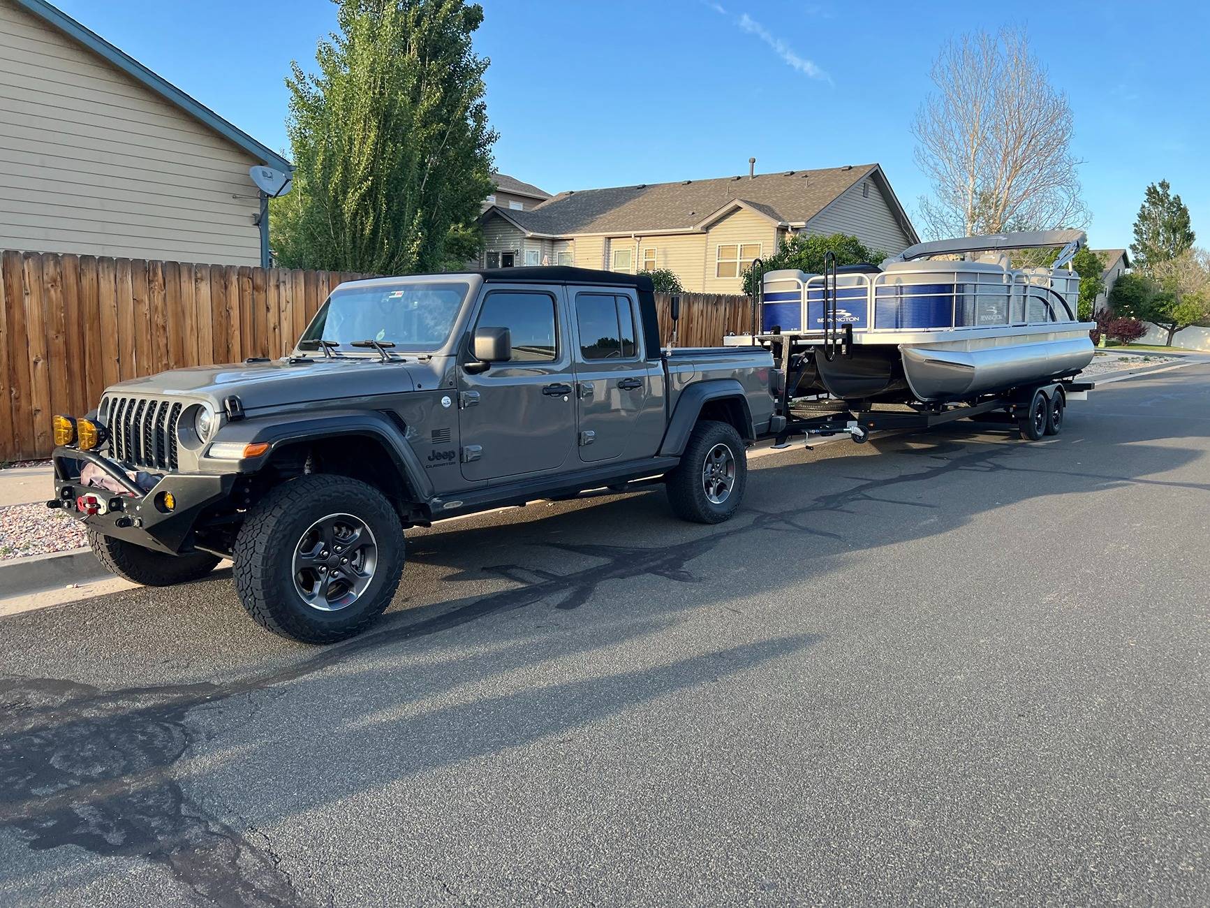

This is my tow, about 3500 lbs loaded (fuel, coolers full) w/ trailer. I live in Idaho, so 3k elevation is no problems, I’m out with it just about every week since retiring, all year long. I can hold about 50-55 mph up a nasty 5-6% grade not too far from home, it’s about 4.5k elevation. Get air bags for rear, it really helps with the extra weight with the soft coil springs. They will really help with your pontoon boat and the wind, keeping it stable. My mileage drops while towing it to about 12-14 mpg, around town empty is 17 mpg on 35” w/ stock gearing 3:73s. Hope this helps…Any other questions on it, let me know.

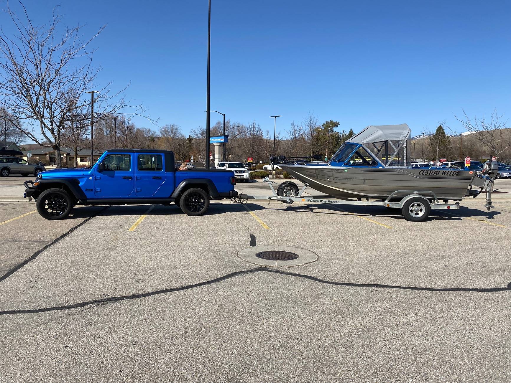

doubt you need a weight distribution and anti sway unless the boat is really heavy. even with mine (2200 lbs) and the dual axle trailer, wasn't required or needed. Also, my trailer had standard 17" rims and normal tires.
