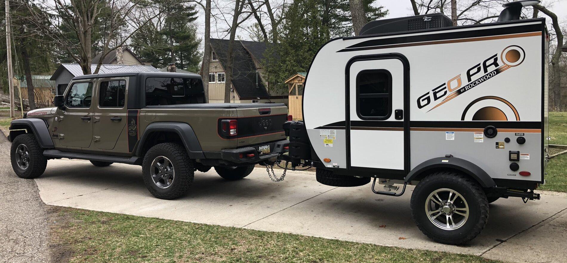

I just got this today and total weight 1300# with no sway or break needed. Having driven big trucks most my life, tow within your means esp as a newbie. Be safe, have fun. Towing a trailer should not be a chore. I have a 2” lift with 33’s And automatic. Don’t even know it’s back there.
