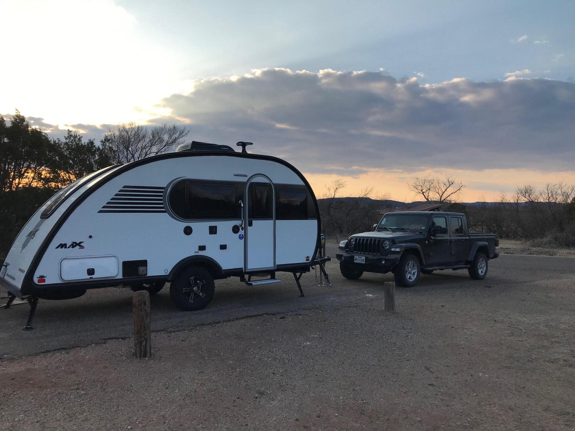

Wanted to share my notes from towing a big trailer with the base manual.
First, the combination of gearing and engine performance isn't ideal for towing. I found myself only using 3rd and 4th gear, and the pentastar seems tuned for horsepower and not torque. It's fun without a trailer, but not ideal for towing. I was able to keep a steady freeway speed, but had to alternate between 3rd and 4th. Never made it into 5th.
I took off Friday with a steady 20 mph headwind and spent all of the trip in 3rd gear at 60-65 mph (3,500 rpm) and got 7.4 mpg. My return trip with no wind was 90% in 4th at 65-70 (2500ish rpm). Truck was very solid and even in the wind I didn't feel unsteady.
Also, used the Curt wireless brake controller, which performed great. Highly recommend.
My main takeaway is that I should consider modifying the gearing at some point. I love the manual and wouldn't trade for the automatic even after towing. Although the trailer pushes the 4k limit on the Sport, other than engine power and gearing it felt fine.
Also, that's a Little Guy Max trailer.

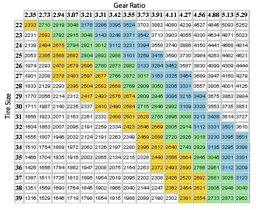

The $2,000 range installed is what I would expect. I think that ratio is reasonable, especially if you tow a lot. Here's a couple of charts to give you a visual:
https://prodigyperformance.com/blog/jeep-wrangler-gear-ratio-calculator/
How does better gearing work with a manual transmission? I can picture it in my head on how it would feel with automatic but not a stick. Would it make 1st and 2nd gear longer or shorter or the same? I havnt been a fan of how short 2nd gear is on my JT. So say I got 5:13s with my 35" tires. What whould change with my gear ratios in those gears if anything at all? I have a 40 minute commute to work and I never really need to shift to 4th except this one stretch for about 45 seconds. I'm in 3rd pretty much 90% of the time from 1800rpm to 3krpm.
You'd likely be using higher gears on your commute, and might find yourself taking off from (all but) a stop in 2nd.
Gear shifts will be shorter and you will use need a higher gear sooner at the same speed. Right now I'm using 5th gear at 70mph. After a regear I'll be spinning higher rpms at the same speed allowing for a higher gear to be used.
