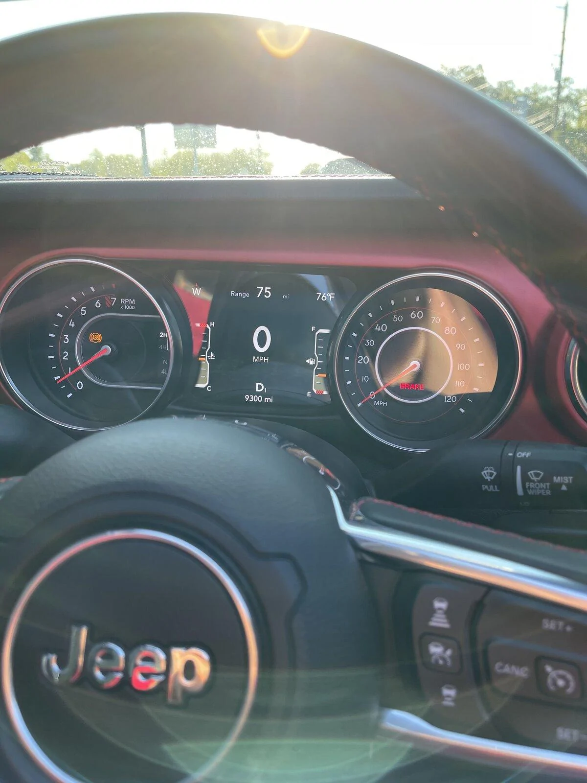

Installed the Mopar trailer brake kit last week and had the Christmas tree dash when I activate it, early 2019 build. Took the truck in for an oil change today and they did the TSB update on the ABS for the trailer brake kit. TSB 08-102-20. Trailer brake kit is working good now however. 3 separate times today while sitting at a stop with my foot on the brake, the pedal went all the way to the floor and the BRAKE and ABS light lit up on the dash. After about 15 seconds they turned off and the pedal felt normal again.
Anyone else had this happen? Not happy right now. This has never happened before the TSB was done today.

I would give it 24 hours and see if it continues to happen. If so, give the system a full reboot (disconnect both batteries) and give it another 24 hours. If it continues, take it to the dealer and see what they can find.

Thanks for the replies guys, it’s the tazer mini causing it. There is a setting in the new firmware called brake hold. I turned it off and the issue is resolved.
If you push and hold the pedal to the floor when you release the brake pedal it holds you in place. New setting in the tazer menu that was automatically on after firmware update. I always take the tazer out and update it before a dealer trip, so the timing of it was perfect lol

Thanks I just had the same issue read your post and disable the brake hold, problem resolved.
