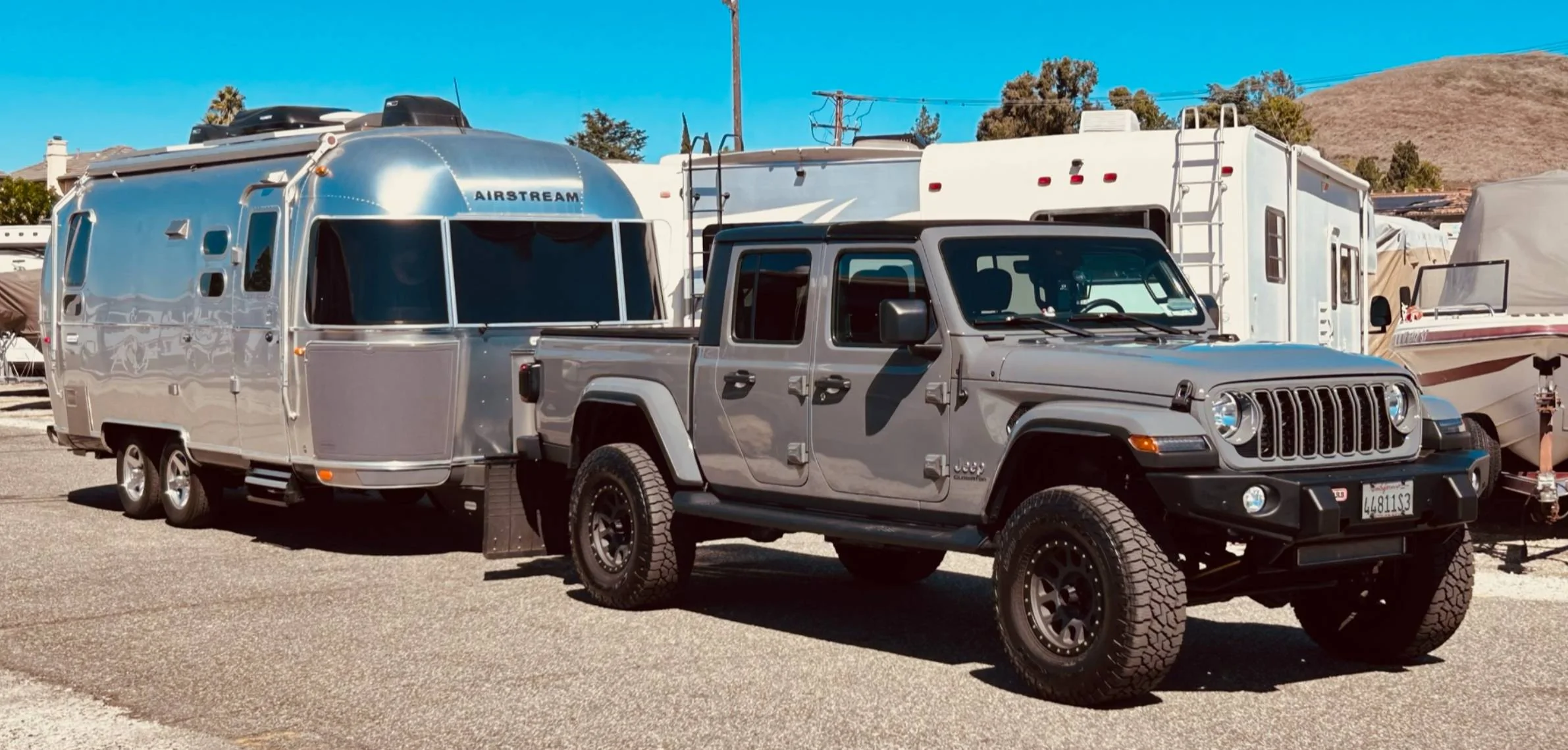

Mopar controller works fantastic for us — also matches the design motif of the dash.
Jeep Gladiator Brake controller IMG_8405
