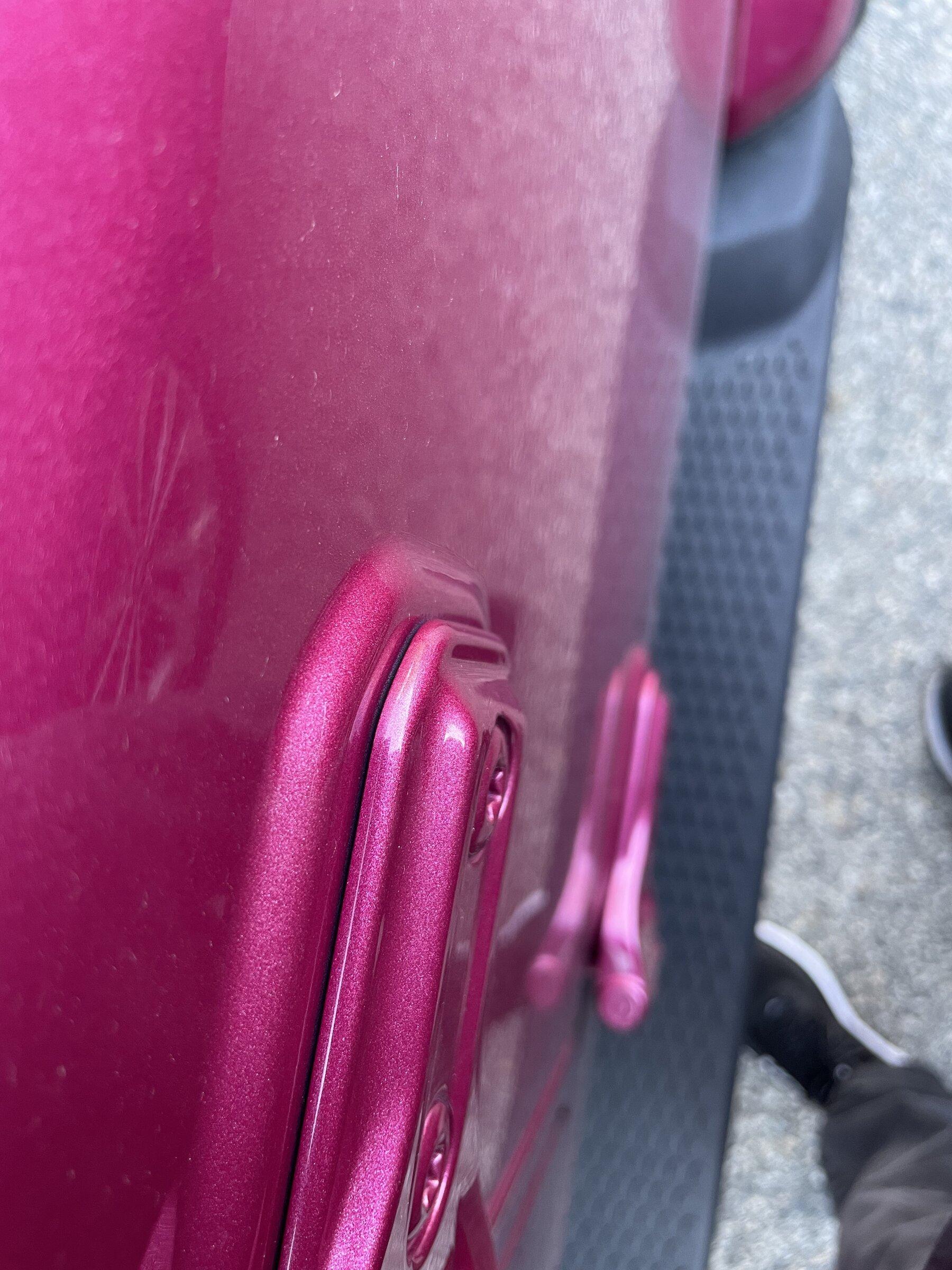

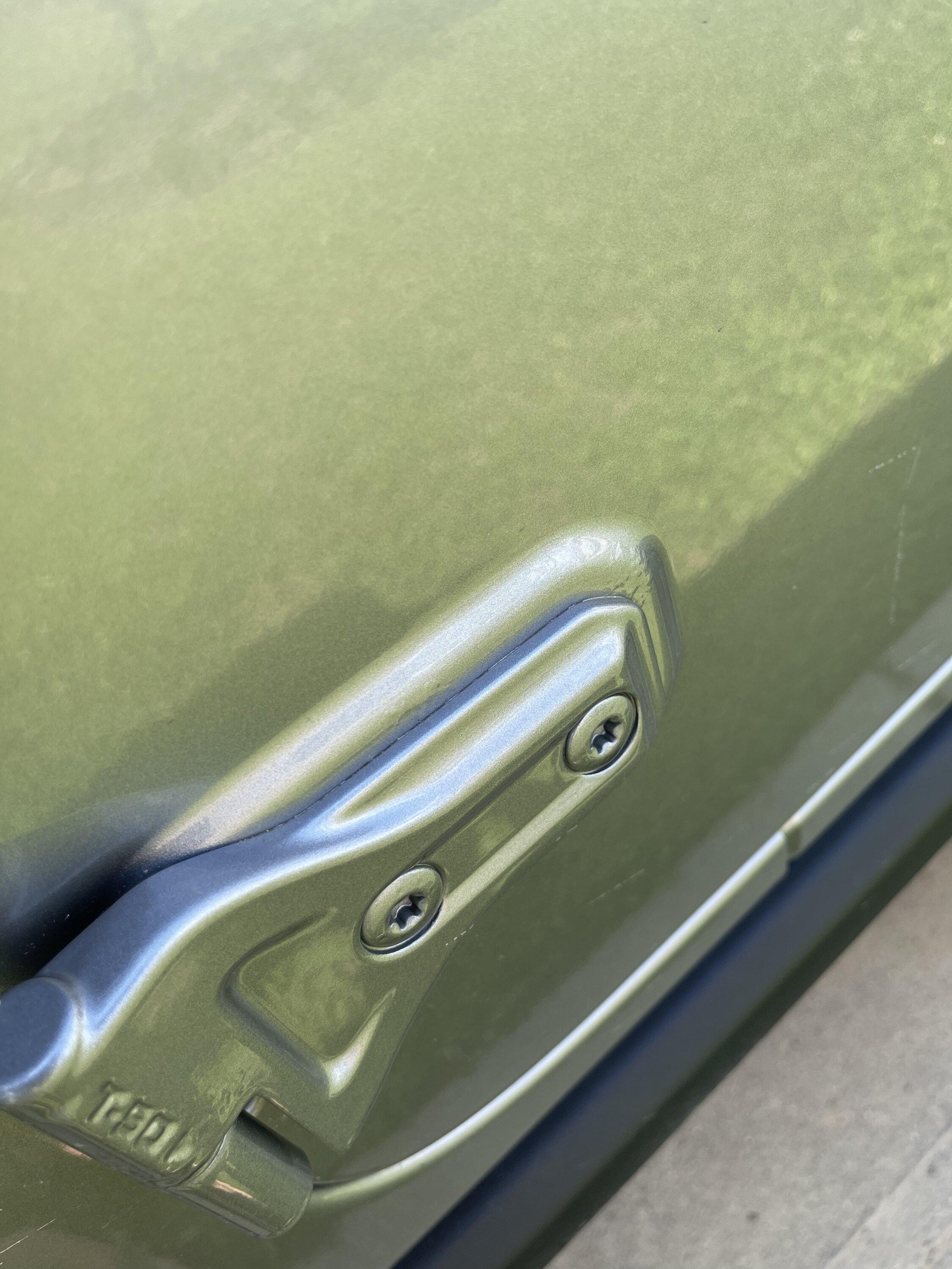

Mine is a 2020. I can say from detailing it every year I do not remember ever seeing it to this extent. One back hinge ( from the body ) was a little rough but it appears more wide spread and the others outer hinged sections were smooth. I have an appointment this week so I will find out. Right after I ordered some new upgrade parts.
OK, so you had a baseline to compare to - they weren't this bad (or at all) in the past.
The pattern is weird looking at it on a different screen - not like drips or sags or runs.
Aluminum takes different care to prep for paint, and it oxidizes very fast unless treated.
Looks like the AL panels and parts didn't get treated properly. Door panels, hood, and hinges are all AL.
Or are the hinges an alloy, even of magnesium? I would have figured they'd have come up with a better hinge material since this sort of thing has gone on for over a decade........
And - there is a law suit covering 2020 and 2021 mode Gladiators as well as Wranglers for this exact thing...... but it's more about this - rust, weird. That has to be the PIN rusting, aluminum doesn't rust.

I can confirm mine is 100% corrosion after seeing the Dealership. They said they just did two Gladiators and have four more 21s and a 22 ahead of me. Now I have to just stare at it until December..
Update: I was speaking to my father about it as we looked at the truck and he said " you mean like this on the hood hinges and around them " my heart just sank. Yes...the stupid hood hinges and the hood have the start of it. This may be the end for her.
R.I.P. I looked elsewhere as I waxed today...under the hood edges, driver door inside lip, passenger rear door and front inner lip. I am not going to repaint almost all of the vehicle and not even get a loaner just for this to keep happening. I loved this thing but I think Jeep topped ford this time with bad aluminum prep.

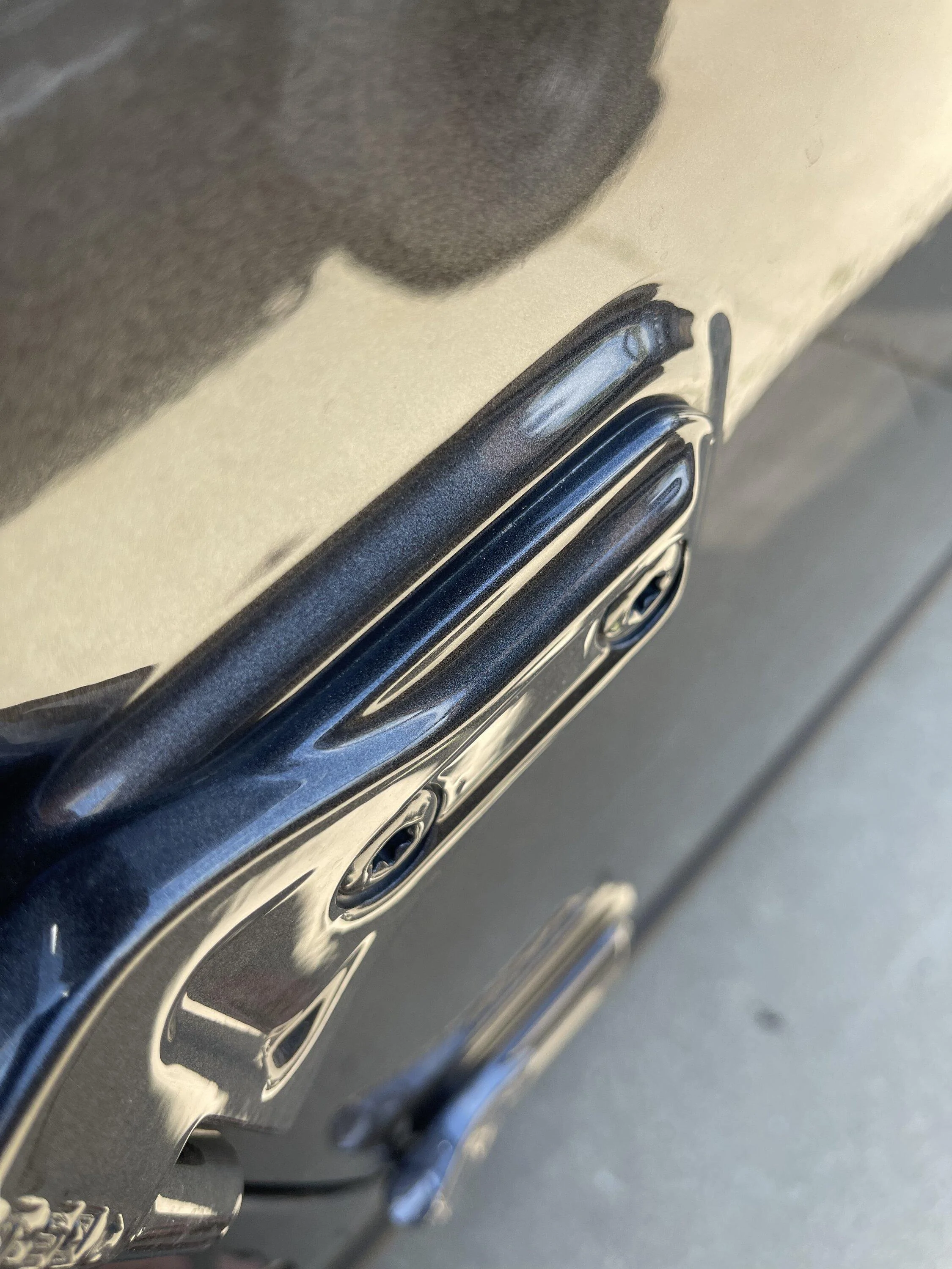

My previous 2016 JKUR had the exact same thing ( bubbles) on all 4 hinges after a year.

I just noticed yesterday the paint around the bottom of the hood hinges is coming off I may get some hinge
covers to try and hide that but that’s the only place I have noticed the paint coming off

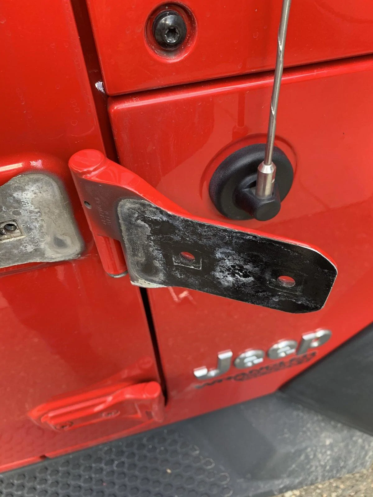

I have seen a few of these apart and it’s definitely raw steel and aluminum under the hinges. In fact on my granite JT you can see some where paint failed reach during the process at the factory.
I will try to find some of the higher mileage JL pics the corrosion on the aluminum door can be seen starting under the removed steel hinge and creeping out.
Maybe it’s galvanic maybe not, but it’s silly to think that metal on metal with no barrier wouldn’t hold moisture.

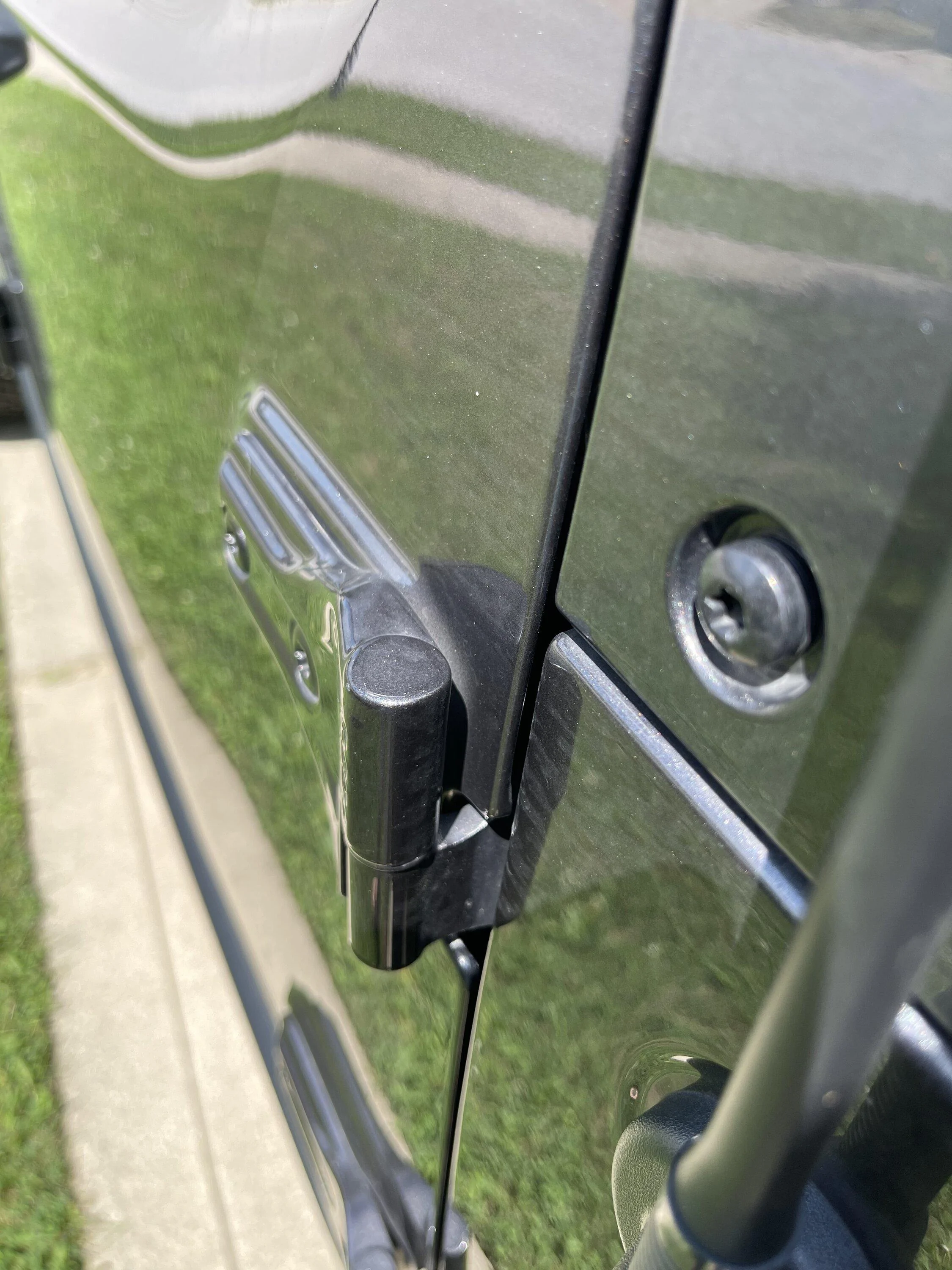

2016 Jeep changed the Wrangler hinges to include a silver isolator pad.

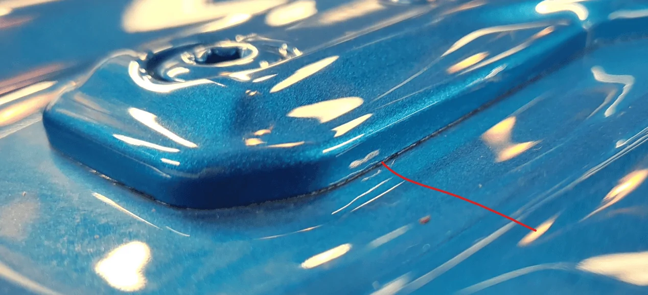

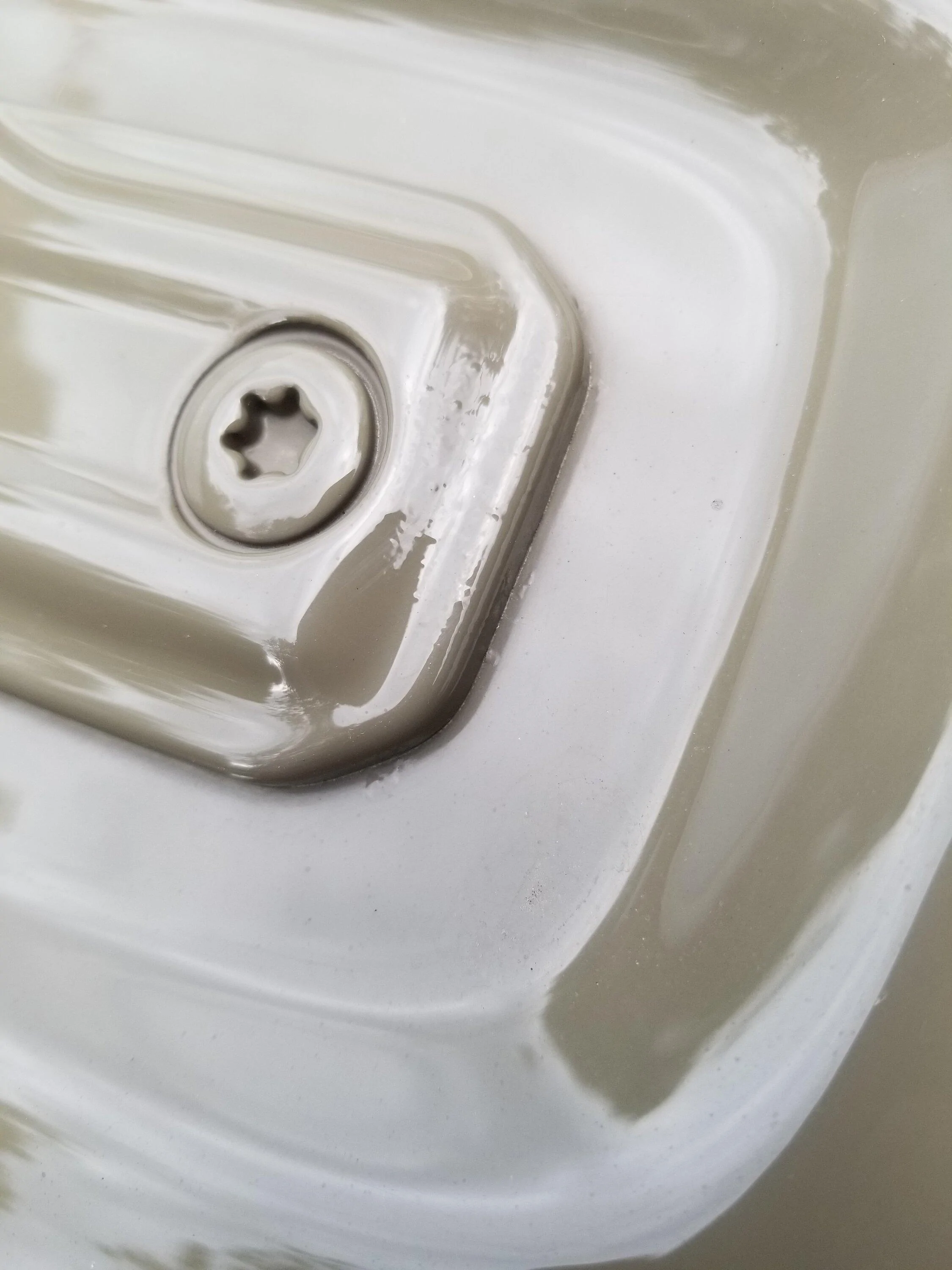

Here's the pad I refer to -
Jeep Gladiator Bubbling paint ! 1658330335511
And here's how there's a gap between the hinge and the door skin - the pad sets the hinge out extremely slightly (only takes a couple ten thousandths of an inch, I have the spec somewhere in my metals stuff)
The change was made, I believe, for the 2016 model year.
Both of my Gladiators showed the isolators were present - even around the bolts on the hood hinges. Wrangler people talk of these pads coming with factory hinges.
Now the gap on mine - there's no direct contact.

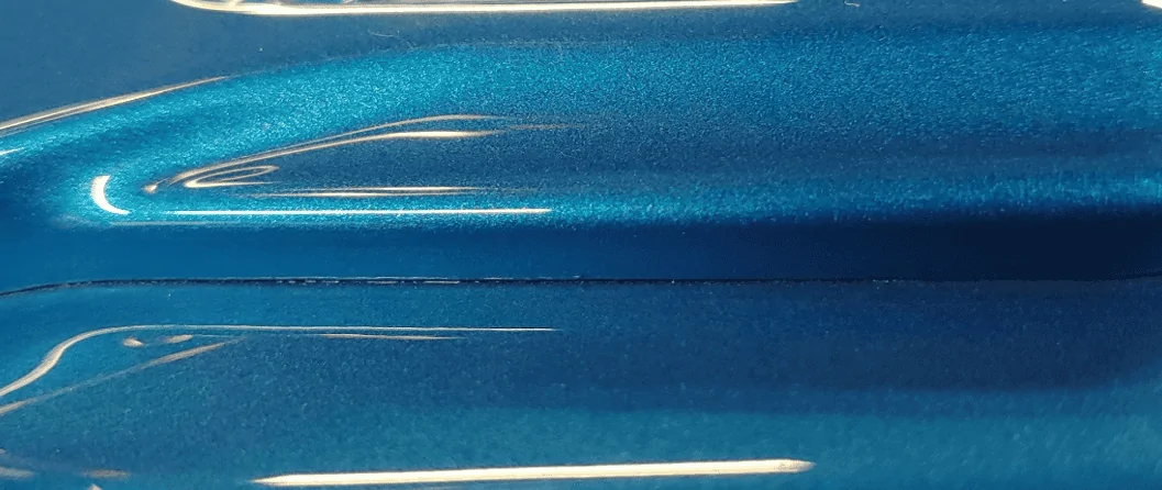

Jeep Gladiator Bubbling paint ! 1658330451545
Looks like an isolator to me...........
Jeep Gladiator Bubbling paint ! 1658330522068

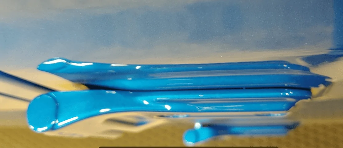

Gap showing pad in place between hinge and door skin -
Jeep Gladiator Bubbling paint ! 1658330606754
Jeep Gladiator Bubbling paint ! 1658330642192

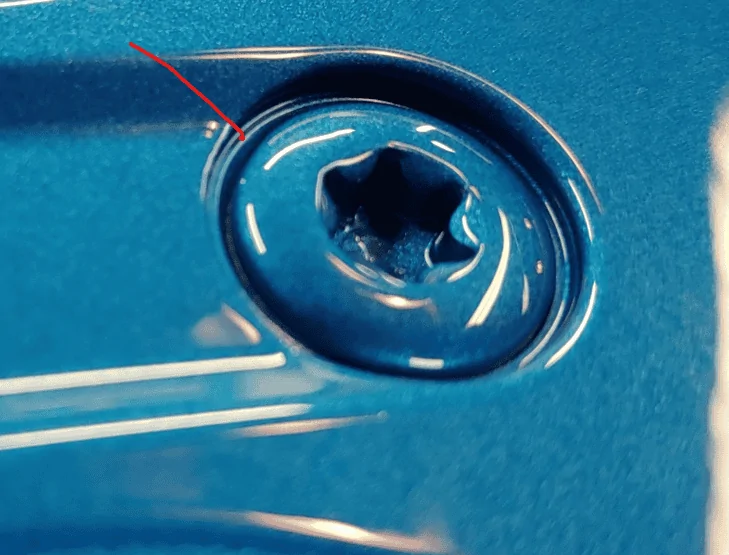

Hinge and door skin don't touch - there's supposed to be a silver isolator pad -
Jeep Gladiator Bubbling paint ! 1658330714255

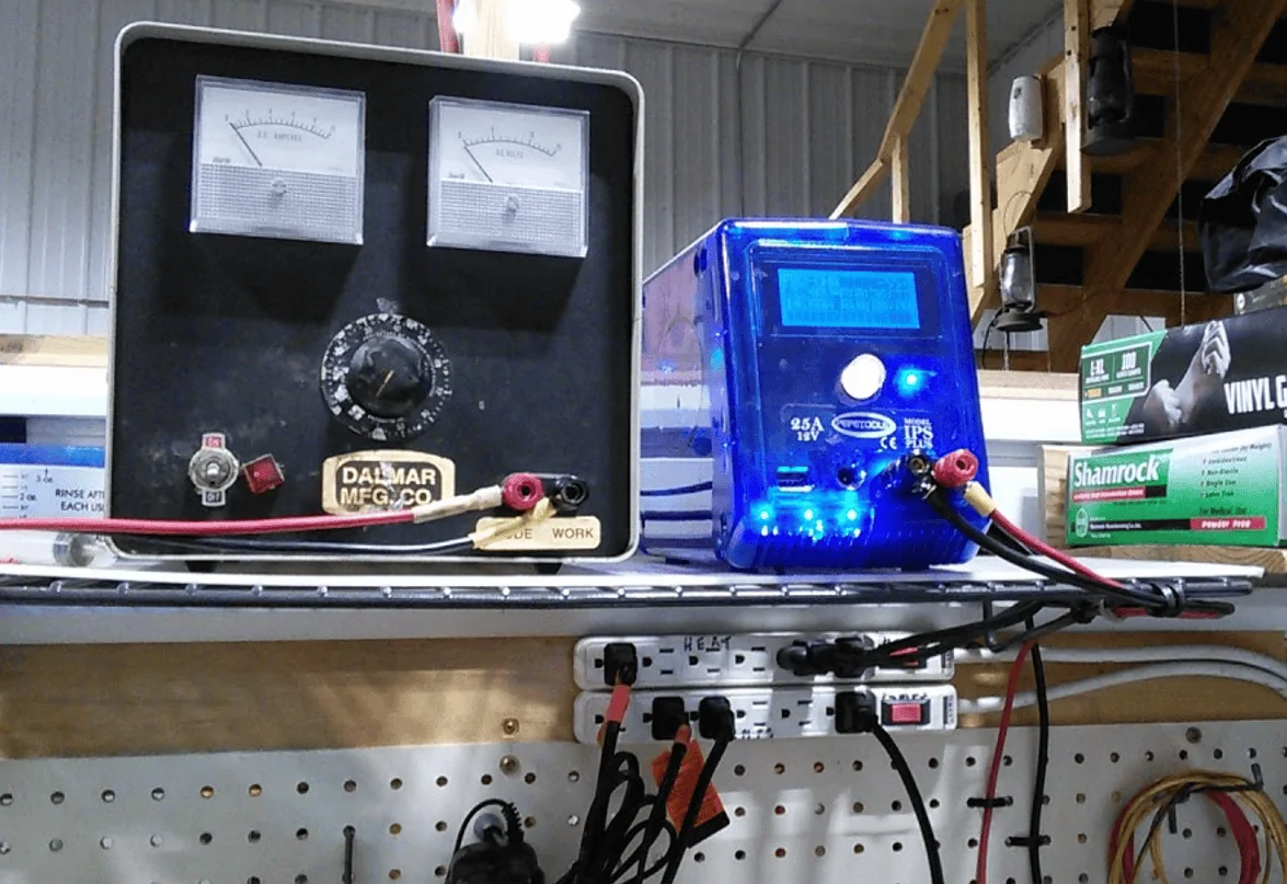

I've been through chemistry and currently do metal restoration and plating.
I did this page in the mid-90s on reversing rust -
https://antique-engines.com/electrol.asp
Jeep Gladiator Bubbling paint ! electrolosys
(for those who want their Jeep bolts and nuts to not rust - I plate in zinc - yellow, black or clear/blue)

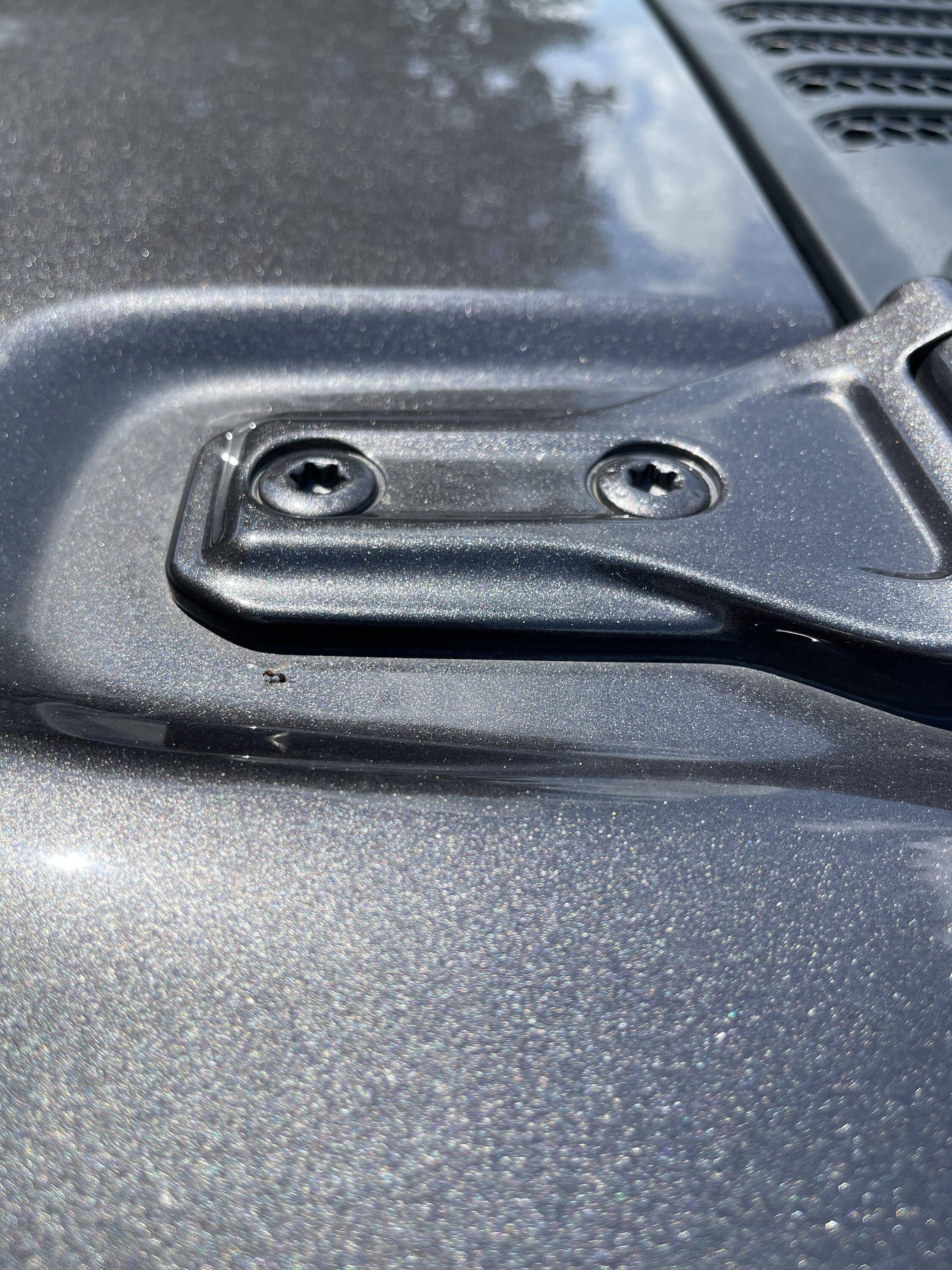

I don’t disagree that much of it has to due with poor prep. I understand the chemistry of it, I have a bachelors in forensic chemistry.
The OP pics clearly show what we are agreeing to as most likely galvanic corrosion. Seeping out from the hinges.
Interesting about the gasket, it appears current builds and repaired ones are starting to show the gap. This was not part of the original design. See pic below. I got to go look at the JT/JL out front. Maybe it was a 2020 change ??
Jeep Gladiator Bubbling paint ! 0E82C61B-9C41-4C89-9637-2F2F6D51F927

Just checked it would appear neither of my 2020s have any gaskets. But the second to last pic clearly shows the a possibility poor paint spray though.
Jeep Gladiator Bubbling paint ! EA49449C-32AB-4B21-999E-125594BC4343
Jeep Gladiator Bubbling paint ! 67618FC4-0C9B-4E28-A9BD-EC2CE8DB12CA
Jeep Gladiator Bubbling paint ! C449CD96-4E3A-472C-A14C-3C239EBC774C
Jeep Gladiator Bubbling paint ! 394DB450-654F-453A-8174-BEF8D76B608A

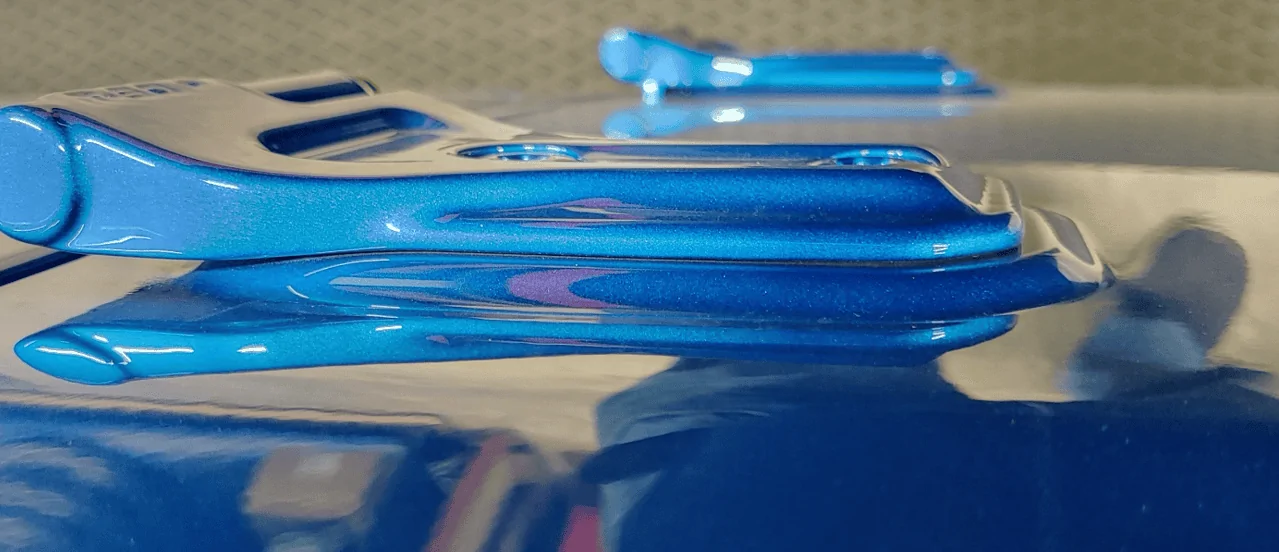

And here is a 2021 snazzberry courtesy of the JL forum that appears to have a gasket. So it would appear the change happened at some point in the 20-21 transition.
Jeep Gladiator Bubbling paint ! CA7D84EF-7E52-4535-9249-A1ED1A86ADAE
