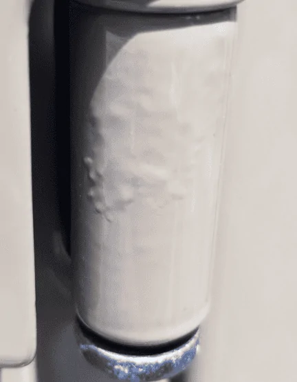

This is NOT galvanic activity - It's where there is no other metal contacting it, and it's the STEEL, which is less active than aluminum. In this pic below that is nothing to do with galvanic activity. It's one metal, it's not a point of contact, and it's not wet AT that point of contact with a dissimilar metal.

This MAY be - but it's most likely under the hinge -
Jeep Gladiator Bubbling paint ! 1658361226552
It impacts the least noble - the most reactive metal.
Dissimilar means two metals where one is more active than the other. Aluminum is slightly more active than steel.

The part of the hinge that has bubbled paint in the later pics isn't aluminum. So that doesn't enter in here. That's a steel hinge or some ferrous alloy) and not aluminum.
As such it won't be impacted by galvanic actions. It's more noble than aluminum.
The spots where the hinge and aluminum meet are where there may be an interaction between the steel and aluminum.

Generically corrosion under a film, such as paint.
I wonder if those hinges were phosphated............
And that's a result of surface imperfections in the material that's been painted - in the case of the steel hinge, it would be corrosion under the paint caused by surface contamination, and that pushes the paint away causing the blistering.

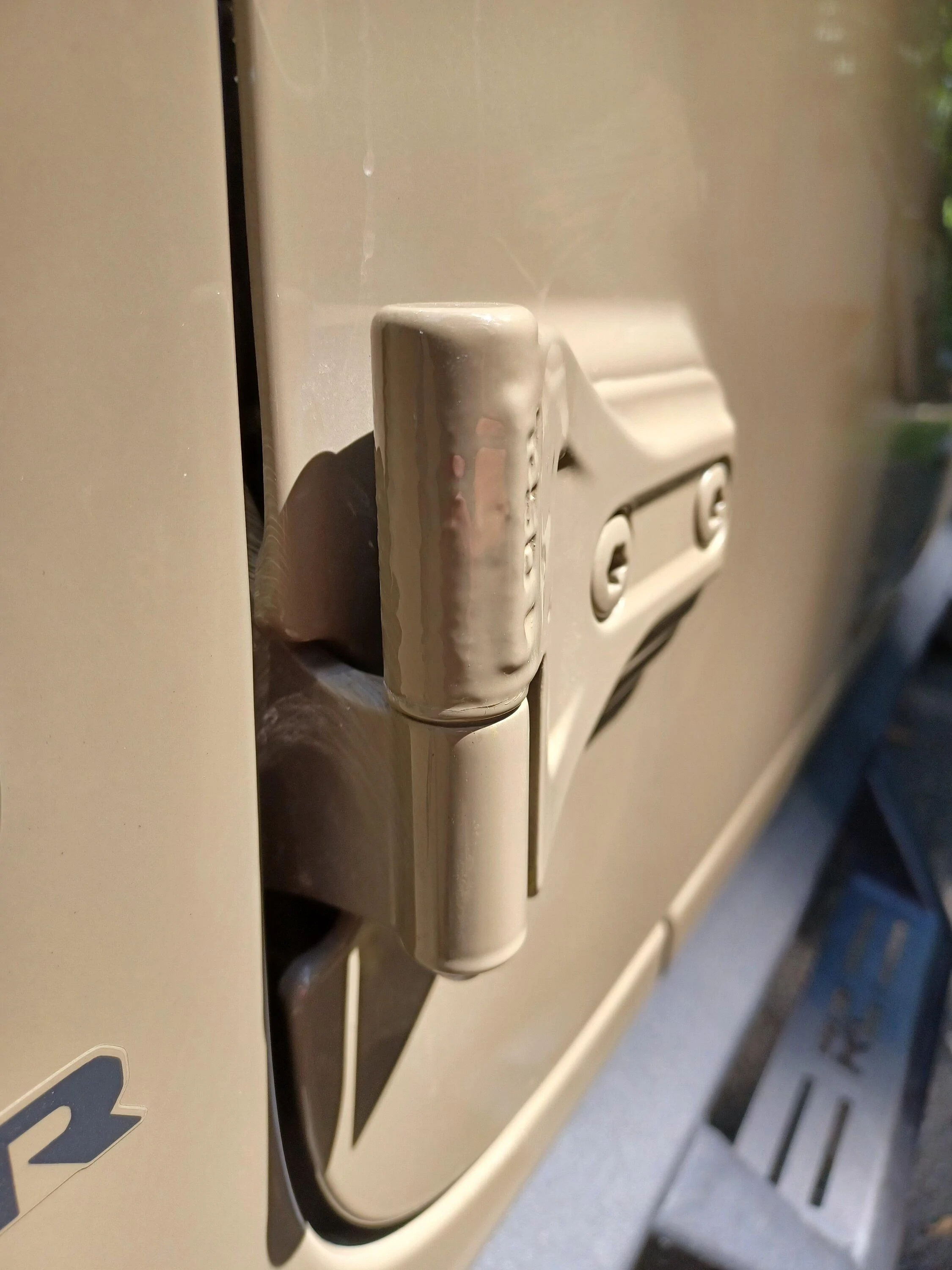

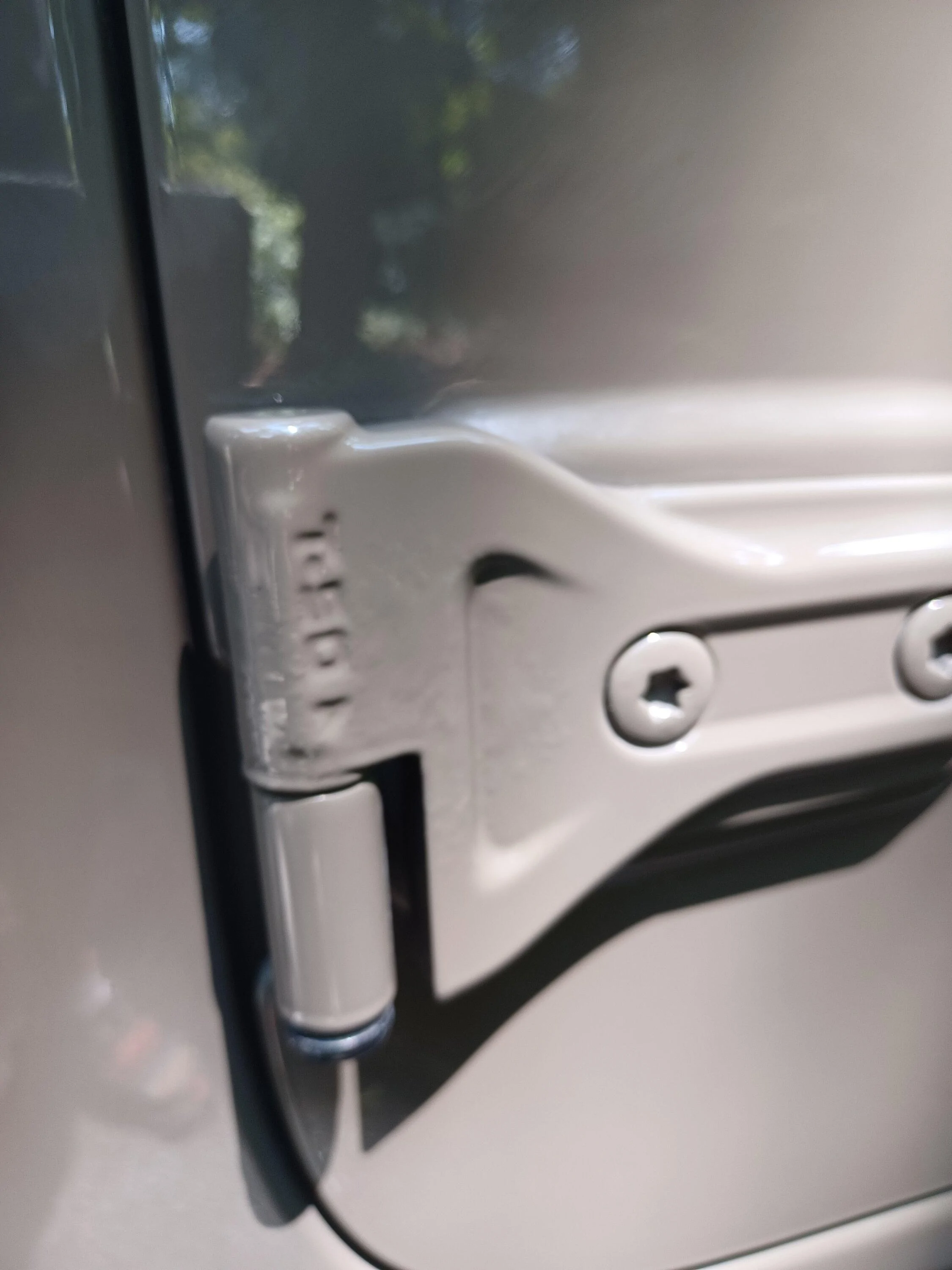

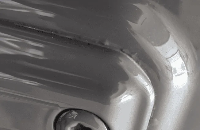

After about a 4 hour detail session over a couple fo days this week and catching up on this thread I inspected the hinges. I'm a victim to the bubbling paint as well.
Jeep Gladiator Bubbling paint ! 20220722_121820
Jeep Gladiator Bubbling paint ! 20220722_121804
2020; Gator. Decided to go to the dealership and get an oil change/tire rotation and see what they'd say. Fortunately, my dealer hasn't blinked an eye when asking about warranty work. The tech actually informed me that corrosion falls under a 5 year warranty. They also have a collision place associated with the dealer which is where I was ultimately referred to for this work, so if this is the situation with you're dealer, you may want to start with the body shop and save a trip.
On the bright side, the rest of my paint still looks showroom after a good wash.
