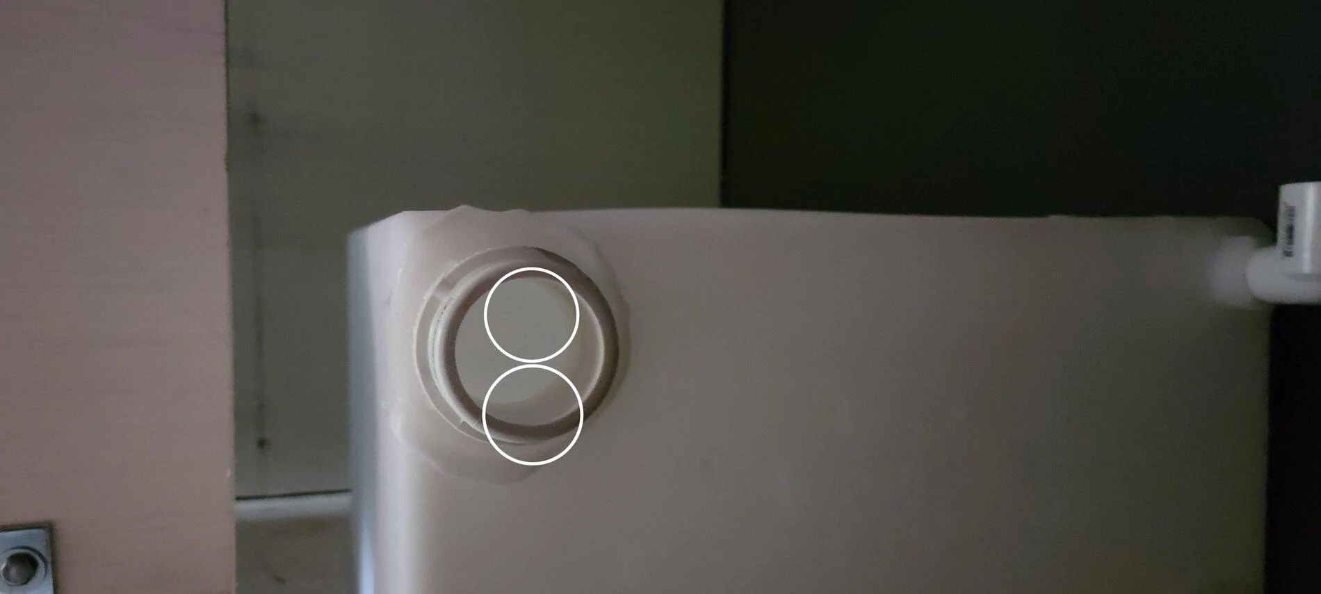

Got the water tank wired up and mostly plumbed. Im trying to consider ways to do the vent for it and the fill.
So you have to have a fill port, an output port and a ventilation port.
What I thought about doing to lessen my plumbing was make the output port double as an input port. Basically I would take the end that plugs into the sink and quick disconnect it, put that line in water then reverse the pump to pump the water into the tank instead of out of it. The vent port remains unchanged. (Im not sure if the pump can even do that, im just cheap and try and think of ways to get mutli uses out of things lol)
My other thought was to make the larger port (its 1.5") double as an input and a vent. Basically I could cut 2 holes into the 1.5" (its threaded but not cut out) I would basically pour water into
an elbow, the water goes into the bottom hole but the top hole is un-used (pouring slowly here) providing a vent.

I used fittings that screwed into the ports, they had barb connectors that I just connected small tubing to the pump then to a quick disconnect then to the sink. I bought too much tube so I just will run the extra section to the front kinda like a fill tube. I figure even though the diameter is small I could still use say a water filter to trickle fill it if I wanted, maybe even while driving... 🤔
you arent supposed to use water hoses or anything with a bunch of force to fill these apparently. basically just supposed to pour the water in it. But everything is tapped the pump is wired and I just have to put the tank back in work out some brackets to keep it from moving around. I went with 10 lbs because I figured it would be close to 70 lbs but as I look at it Im thinking I could have easily gone with a 20 gallon, I may add another 10 on top of this one down the road. I wasnt sure if the pump could be above the tank or if it had to be below it so I just mounted it to the floor close to the output port.

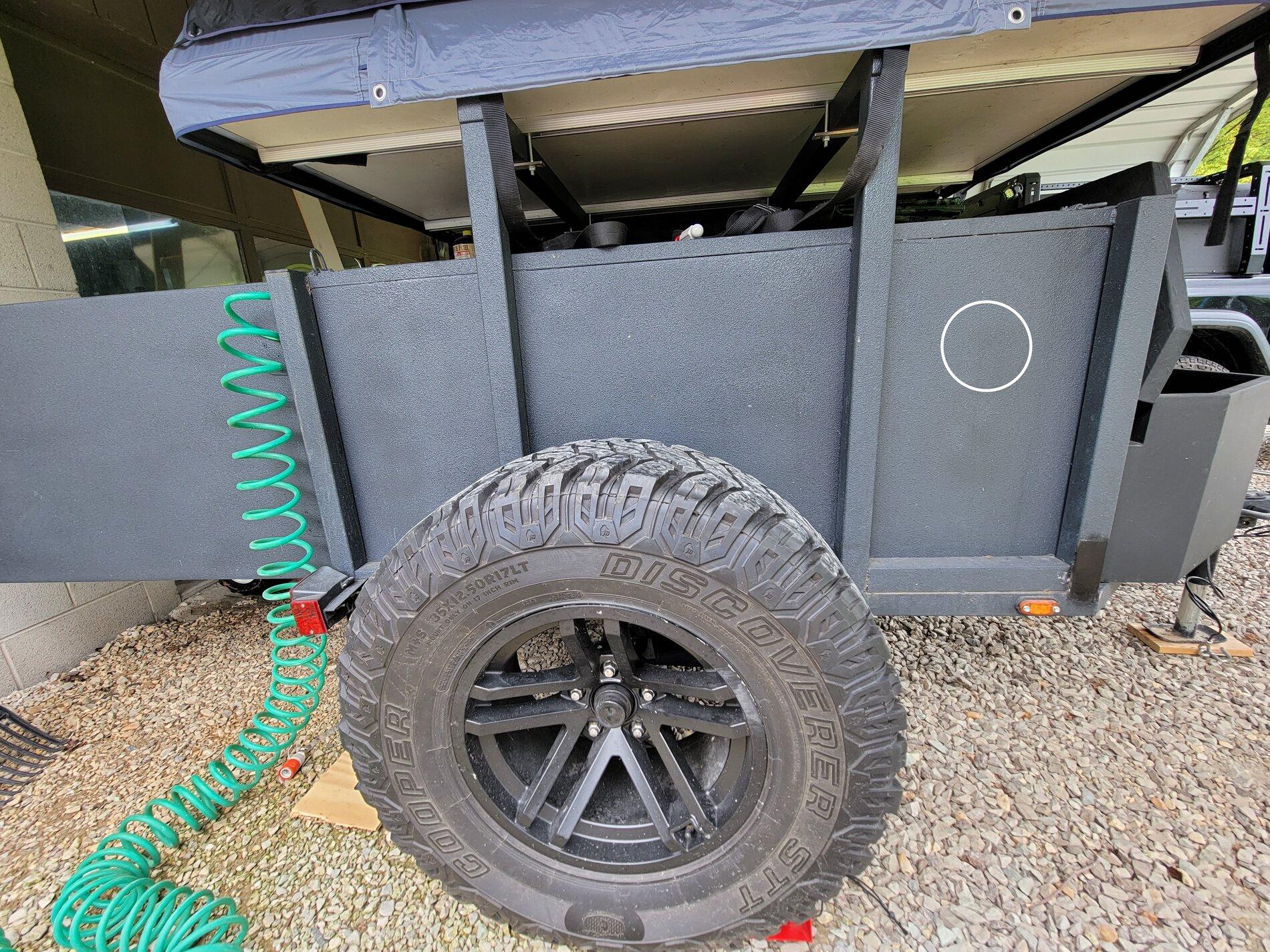

Before I start cutting holes in my trailer I figured I would ask.
I've got that power cord from Amazon (from the other thread) and also a water quick disconnect that will be here in a few.
So the electrical is for charging the setup here at the house or anywhere that has on site power. Just that simple port on the side, but I got two lines for inside. One I'll run to the house charger for the gz and one to a trickle charger (hard mounted) to the house battery (be here tomorrow).
Anything I should consider for my hole locations? I'm thinking right here for both sides. So the green hose will have a quick disconnect end I'll be able to plug it right into that white circle the attach it to the sink, a sprayer or whatever.
The water tank is just behind that circle and the pump just before the tire.

I've never hooked up to campsite power and water but are they on the same side of the site? Meaning, maybe check into that and possibly mount both ports on the same side? I dunno, that's the only thing that jumps out at me... I don't even know where I'm going to be putting mine yet.

It wont matter as Ill just bring an extension cord. Can always just turn the trailer around.
I wont be able to hook up to water with this setup I dont think, you cant fill the tank from your house water hose etc, youll pop it. basically you are supposed to fill it by pouring the water in yourself (the use the term fill dish).
Ill have to run to lowes, I have a 2 1/2" hole saw and the power needs a 2". The water port is 2 11/32 or something weird (2.65"" and Ill have to use the 2 1/2 and do the rest by hand. Need a few odd and end adapters of course what I had on hand was the wrong size. :p
