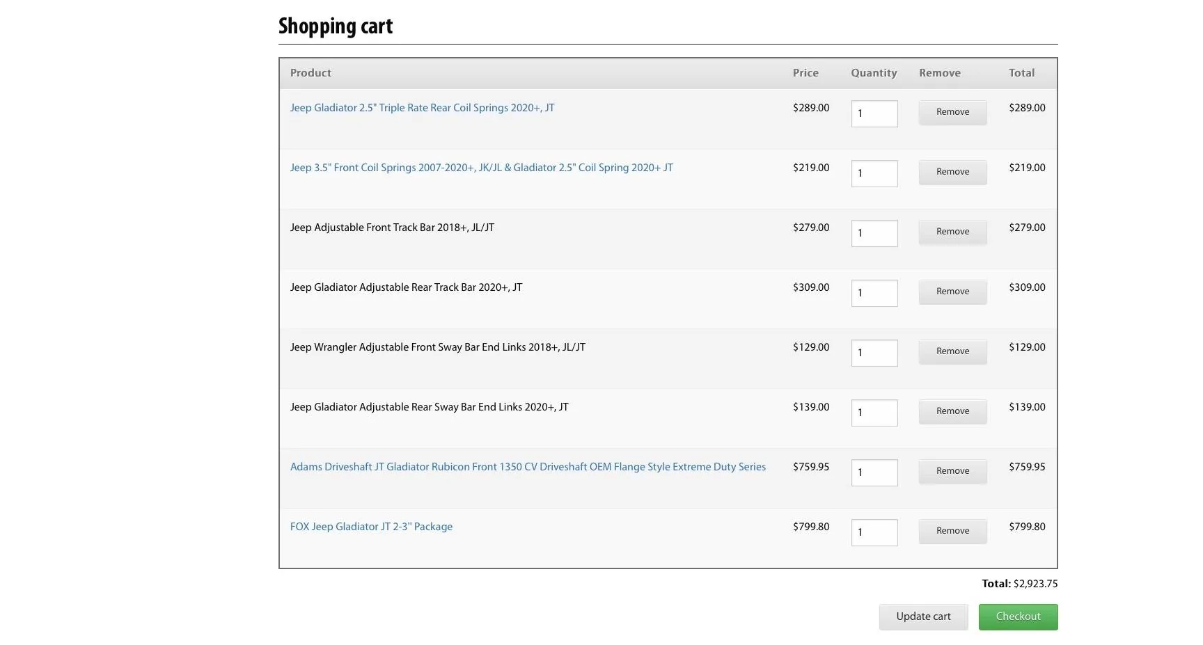

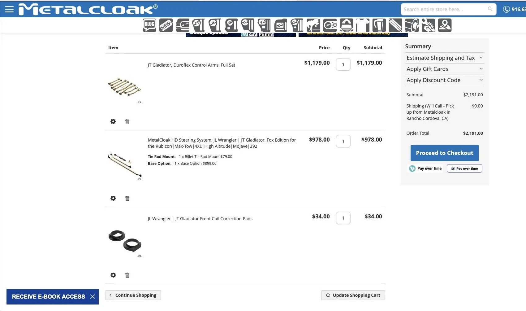

23 Rubicon. Already have AEV wheels - this is one of the reasons for the MC control arms. What is this missing for running 37's (maybe 38s) ? And yes I will do gears , most likely 5:13. Just thinking about suspension and how much I love a sweet jeep but hate spending money like this. BTW the first group with springs is Clayton.
Jeep Gladiator building the system-your thoughts 01B6C15E-0A17-4382-86C2-CB240D6B0D54_1_201_a
Jeep Gladiator building the system-your thoughts 0C5F6B16-BB4E-4864-AC98-EDF00F61C006_1_201_a

People Work?
Upgrade the Steering Stabilizer
Get the Metalcloak Sector Shaft Brace and the Trackbar Reinforcement Bracket
Metalcloak Rear Swaybar Link Reinforcement Brace
Metalcloak Ball Joints
