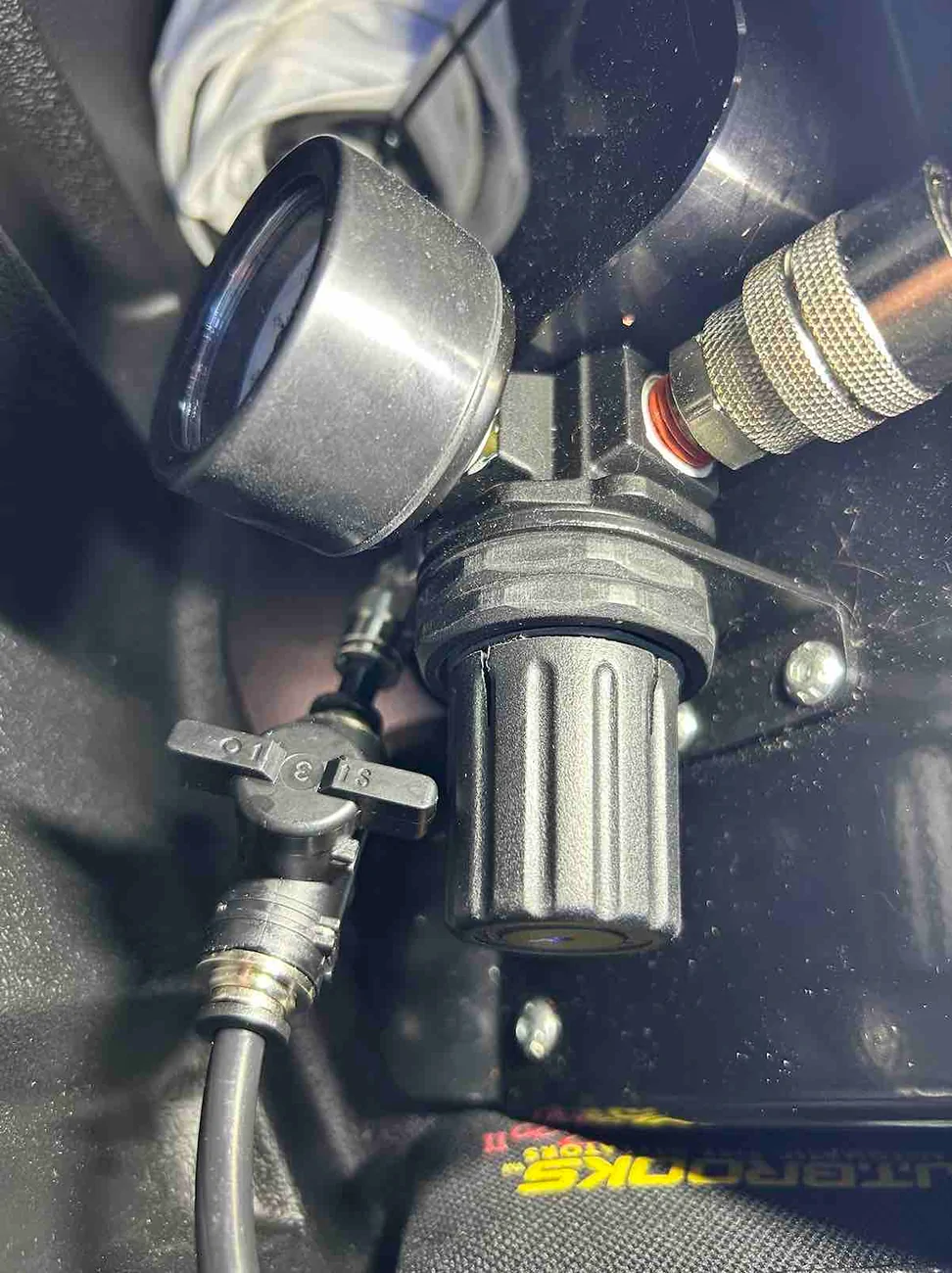

I have the Accuair lift on my JT. The install was done by my 4x4 shop in February. The two issues I had after the install were too much overnight air loss in the tank due to a slow leak from the regulator. I considered two options, replace the o-rings in the regulator or install a 1/4-turn shutoff valve. I went with the second option:
Jeep Gladiator What are your experiences with the ACCUAIR system? 1762965291697-yo
Now I just leave the regulator set at 100 psi and and fully turn the air on/off as needed. Here is the link to the valve I used:

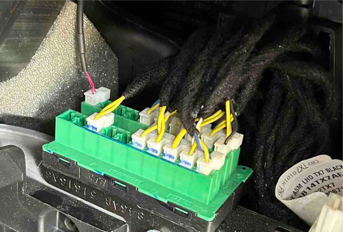

The other issue I had after the install is that the state emissions test equipment could not read the emissions monitors. Somehow the Accuair speed sensor was interfering. The solution ended up unplugging the speed sensor can bus wire from the star connector behind the glove box. Here is a pic showing it connected in the left back corner:
Jeep Gladiator What are your experiences with the ACCUAIR system? 1762966119709-h5
I used JSCAN to duplicate the read issue of the emissions monitors, so if you use JSCAN or something similar and it is not working right, try unplugging the speed sensor. I just leave mine unplugged all the time now. All it does is reset the lift to the default height when exceeding 25 mph. Depending on the trails I'm on, I don't like it changing from level 3 to level 2 on the fly. It did that to me at Hell's Revenge when driving faster through a sandy section. It damaged a height sensor due to hitting a curve with a whoop at the same time the system tried to reset to the default height. Accuair replaced the sensor under warranty, but I'd rather not have it repeat.
