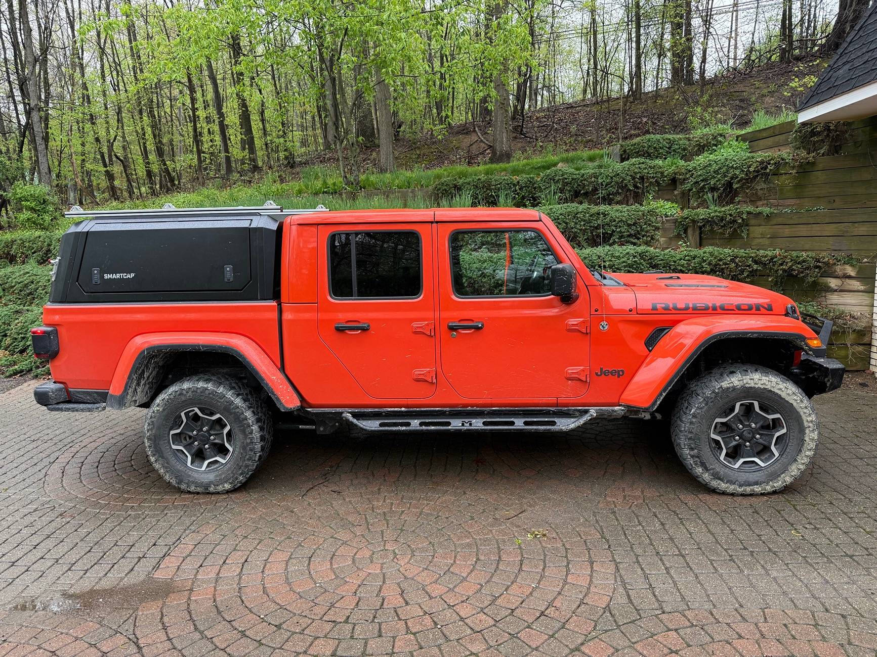

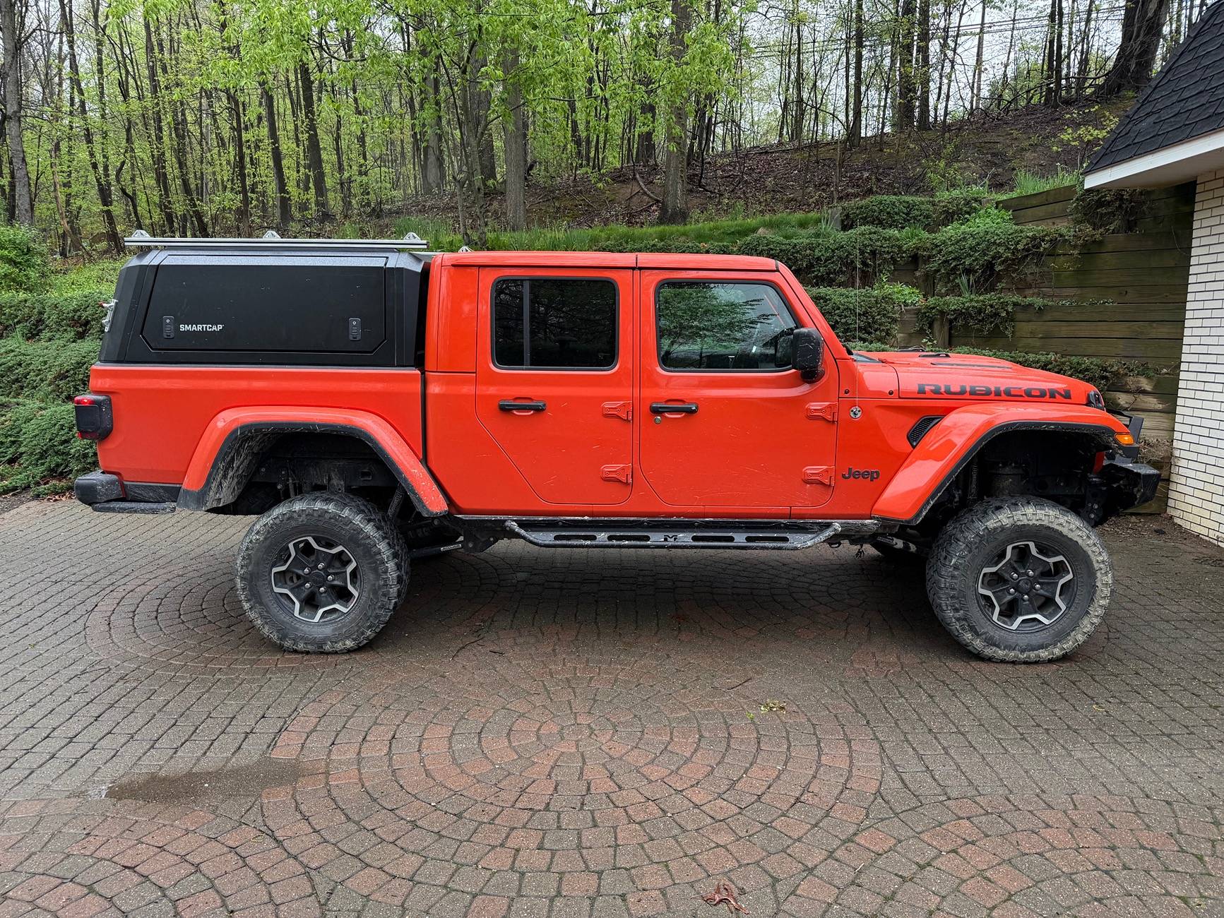

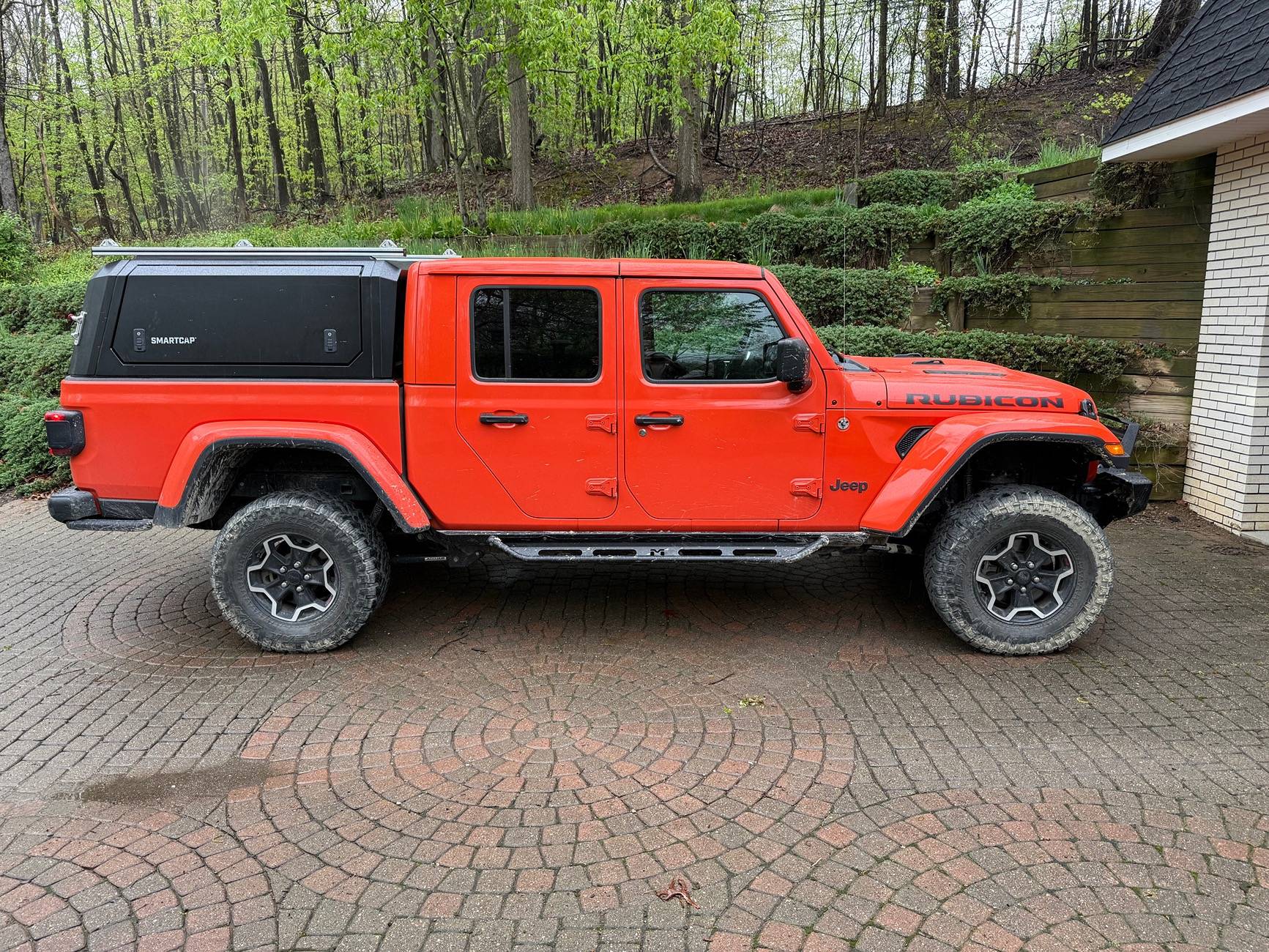

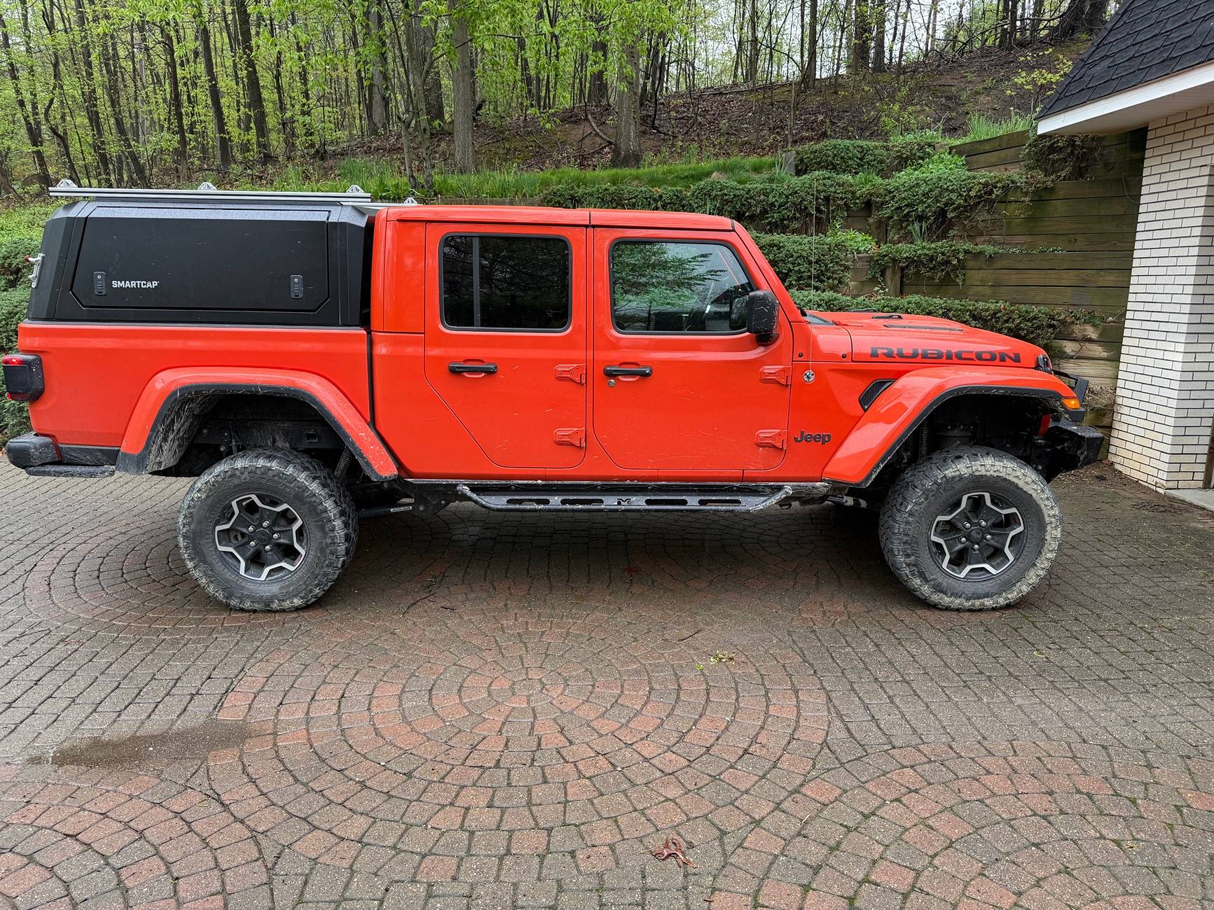

More pictures of how it sits at different settings.
1st picture is on the bump stops.
2nd picture is setting 1.
3rd picture is setting 2.
4th picture is setting 3.
5th picture is manually holding the up buttons on the pad till it stops going up. Wouldn’t drive like that but it is useful in leveling the truck at a place to camp.
This is awesome. Which one is “normal” ride height? Is it pic 3?

We usually drive on the highway on setting 1 which is picture 2. But the normal ride height is setting 2 which is picture 3.

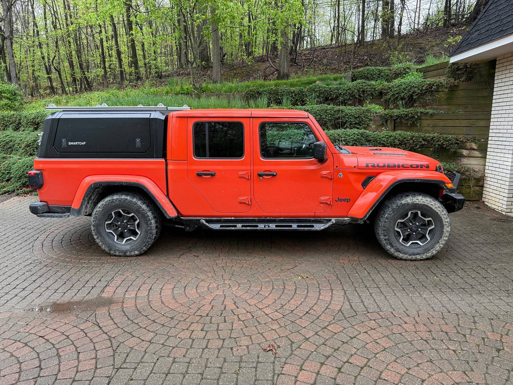

Ok now is the time I look at lifts. I like the Accuair as I can raise it or lower it anytime. But is almost the $7-8k worth it. Those of you that have it installed, do you like it and was it worth the cost than just going with a 2.5” lift? Sorry newbie here.
I bought the Kit last year and installed it myself. It is not hard but takes time. And finding air leaks can be frustrating. I had a Mopar 2” lift that I had installed by the dealer and it was fine. But wanted a little more clearance off-roading. This now sets at 4” height in middle setting. It has proven very helpful when needing to lean away from trees and rocks in tight spots. And in the highest setting (about 6” over stock height) it definitely helps reduce scraping. The ride is not as nice as the Mopar lift. I suspect the JRI shocks are tuned stiffer rhan the Fox 2.0 shocks in the Mopar lift. Or maybe the air bags are stiffer than I thought they would be. They do now offer a piggyback shock set as an option.
When you look at the cost of other quality 4” lifts, it is still a premium over other premium kits. Local shops wanted $4000+ to install it so I did it myself. I also just went to 37” KO2 tires.

I installed mine also and I agree with Trekkor2020 that it is not a hard install but it does take some time.
