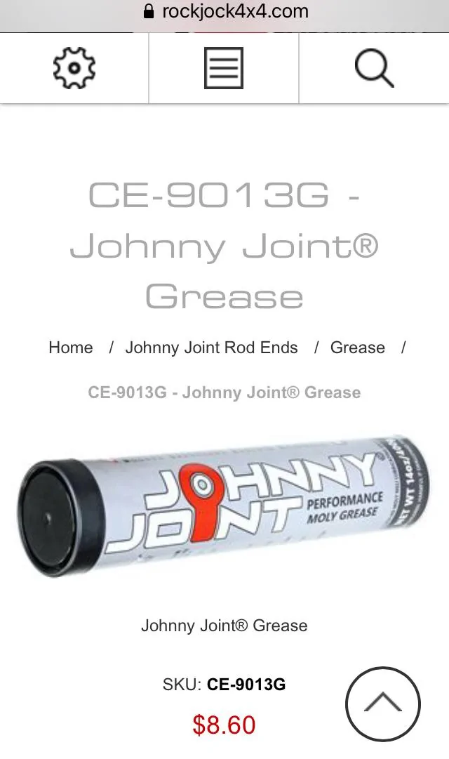

Need to add some into my trackbar joint and wondering what everyone is using.
Second part... if I don't know what my installer used up front does it matter about synthetic or not, is it a problem like engine oil or not?

Clayton uses a Johnny Joint on one end. Currie sells a “moly grease” specifically for their Johnny Joints. There’s probably something generic that is comparable.
Jeep Gladiator What grease are you all using on your suspension joints? 19E8FAFF-3C75-4BB1-ADB5-55C25BEC3C6F
Clayton confirmed they use this
