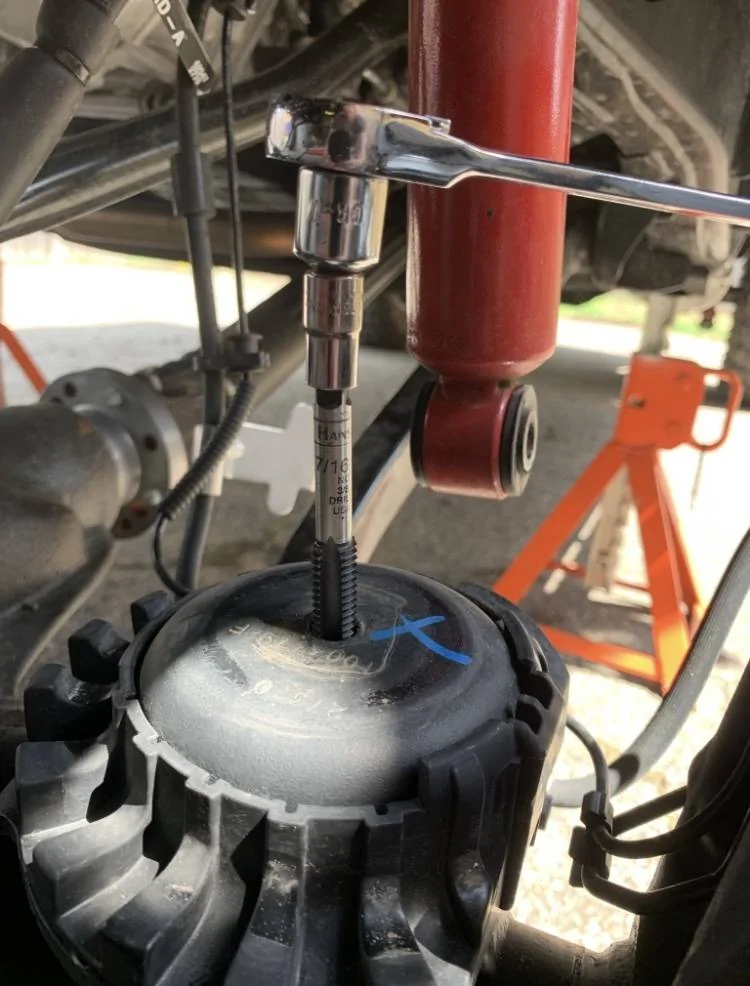

it’s really cheap and easy to modify the front if you tap it when the coil is out then use hockey pucks as bumpstops. They can be changed with the spring in place.
Jeep Gladiator What length bump stops are you using with the Clayton 2 1/2” Overland Plus lift? IMG_8740
Hockey pucks work great. We used RTV if the spring is installed.
