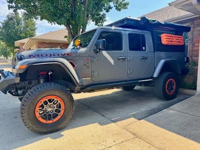

Soo I finally got around to installing my AccuAir system. It was fairly straight forward for the most part. I spent more time running air lines and wiring for the ride height sensors. tried everything I could to make it look as factory as possible. The control arm and air spring stuff went fast. I was surprised to see that the lower control arms for the front were not adjustable. They definitely add castor. I have put close to 100 miles on. What i have noticed is even though I didn't change toe or camber, It now pulls to the right. How is changing only the castor now cause it to pull the the right?

It actually pulls to the right. The steering wheel was off only a little bit after the first drive. Like it was sitting at 12:30 at best on the first drive. There is a gradual corner on a highway near me that I could let go of the steering wheel and it followed that curve perfectly. I did torque at ride height. I am at 100 Miles on it and will do the retorque. May loosen and retorque and check again in another 100 miles. It sits more level now than what it did before I put the lift on. I did measure all 4 corners before the lift. right rear was 1/4" lower than the left. Front was the same on both sides. Measured tire straightness compared to the steering wheel before the lift. Also used a plumb bob to mark center for the axle so I could get everything back to where I started at ride height. I haven't rotated the tires yet. They are brand new and wouldn't have thought that i would need to do this. It is my first set of Mickey Thompsons. I've always been a diehard Super Swamper fan. I've run Swampers or BFG on all of my vehicles for the last 35 years without a steering pulling issues. Currently have 3 vehicles on Swampers, 1 on BFG and now 1 on MT. A local friend of mine that is in cahoots with Mickey Thompson has suggested that I try Mickey Thompsons several times. If it turns out to be a tire, this will be my only set. I doubt these will outlast my SSR's either. I'm just part of a brand loyalty generation. I talked with Steve at Accuair and he is more than willing to help to resolve the issue along with a friends JT with no lift that pulls to the left after a couple tries on an alignment rack. I just have to get an alignment printout for him. I will do that after a tire rotation that he too suggested I try. He was a wealth of information for the questions I had. FYI, he also reads this thread.
