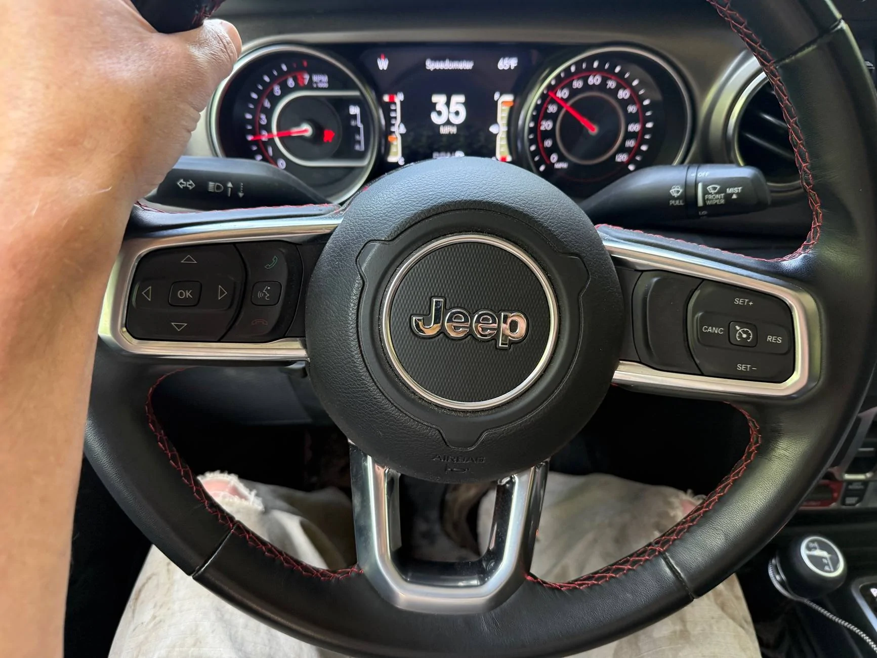

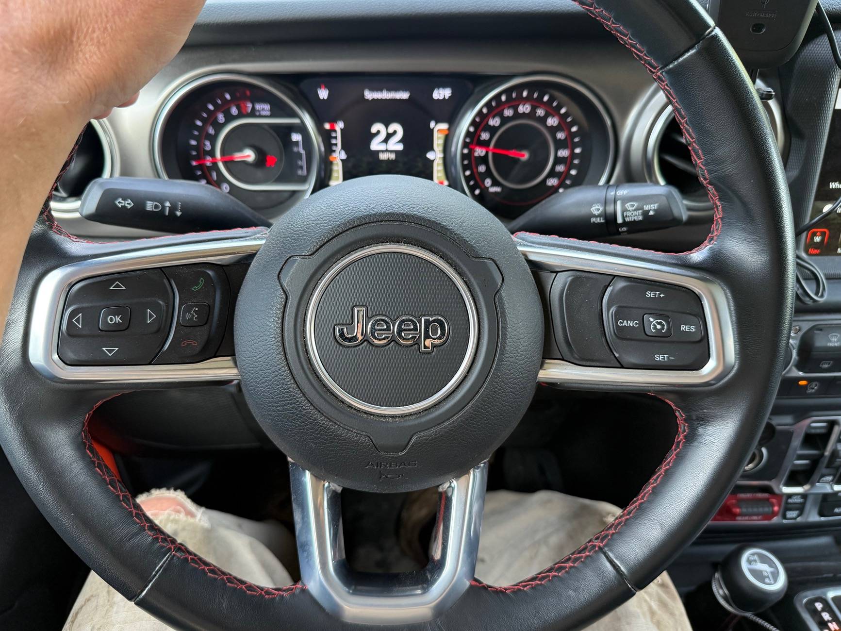

Here are some pictures of the steering wheel at different settings. They are all taken on the same section of road to account for road crown. First picture is setting 1. 2nd picture is setting 2. 3rd picture is setting 3. You would think that it would be off more than that but it isn’t so I don’t know. The wheel is a little off center because of the crown of the road which is why I took the pictures on the same section of road.

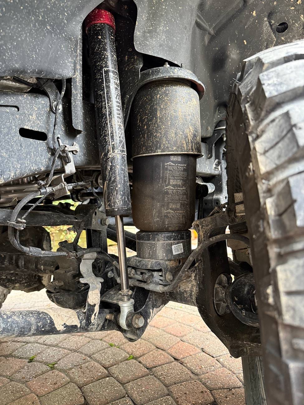

In a short answer NO it is not worth the money they ask for this system.
It is a failure for Overlanding, as yes the rig will level but the off road ride is akin to a loaded 1972 Ford station wagon with bad shocks.
Control arms bushing material is too soft and will cause handling issues . Even after replacing all four control arms with Clayton arms the shocks still do not effectively control the ride
Standard Air Compressor is under sized and is useless for airing up 4 tires Took 40 minutes to air up my 4 from 15 to 35 ( BFG 39x17)and the compressor timed out after 2 tires.
Ride height sensors are cheap with dead spots. You can over range them on the trail and the system stops working until you recycle power.
