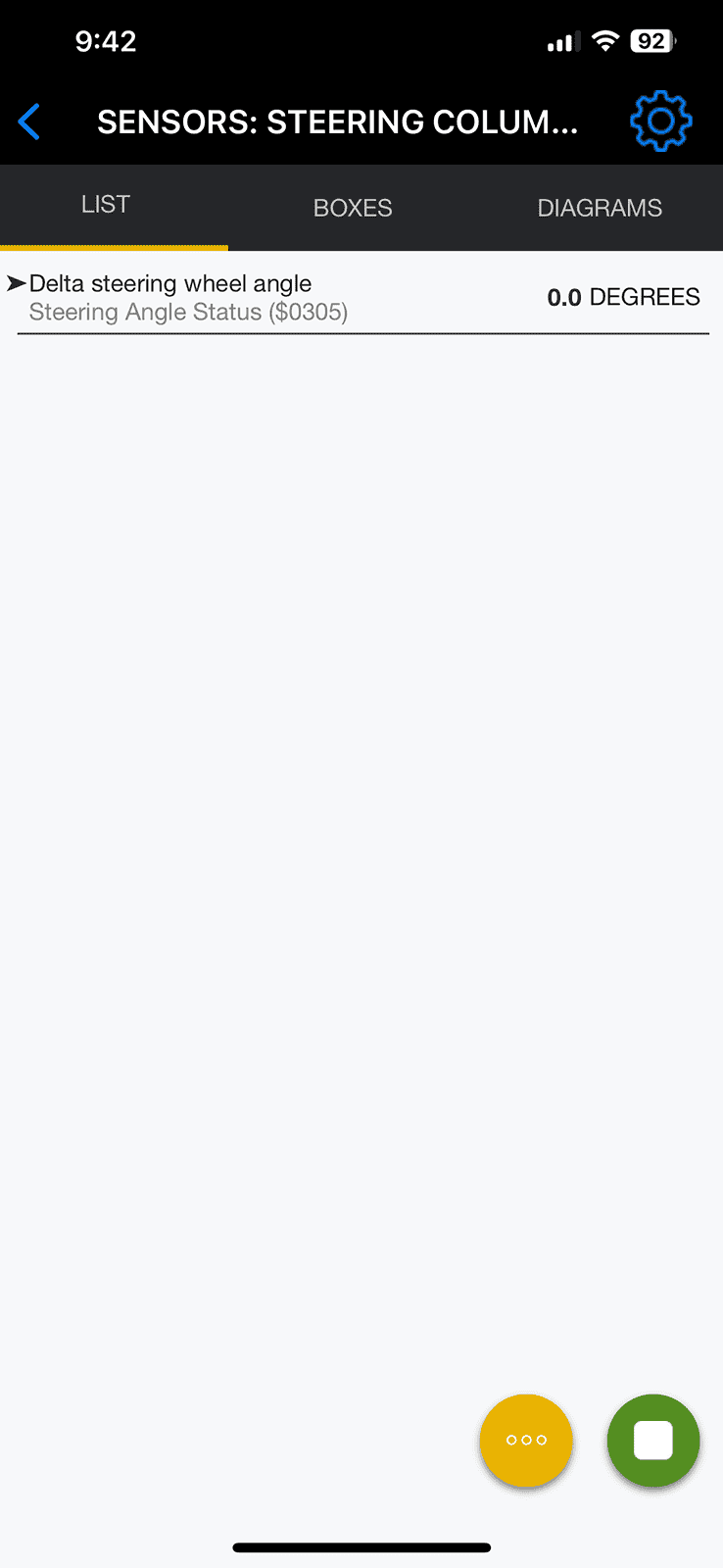

After you get your toe in plates, the first thing is to make sure your steering wheel is 100% centered. After that, I will say from experience that 1/16” changes in toe makes a big difference in how your Jeep tracks. Small changes at a time. Too much toe and you’ll be buying a lot of tires.

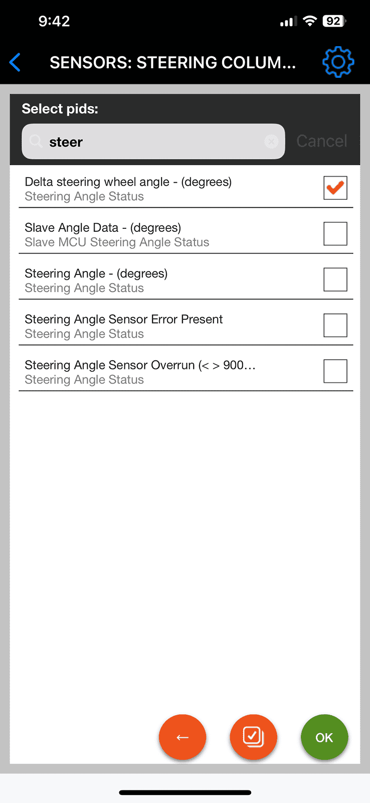

Jscan and the steering angle reading is super handy here to dial the steering wheel in. ???
How does the Jscan come into play? I have a tazerJL, I'd guess it could do the same thing?
Tazer is a different “tool” think of it like cheat codes- it’s a device that stores the cheat codes and unlocks/hacks different things.
Jscan is sort of in line with a diagnostic tool and allows you to read many different parameters within the factory computer. It also allows for some adaptations to be made with a security bypass in place (tazer is a security bypass).
