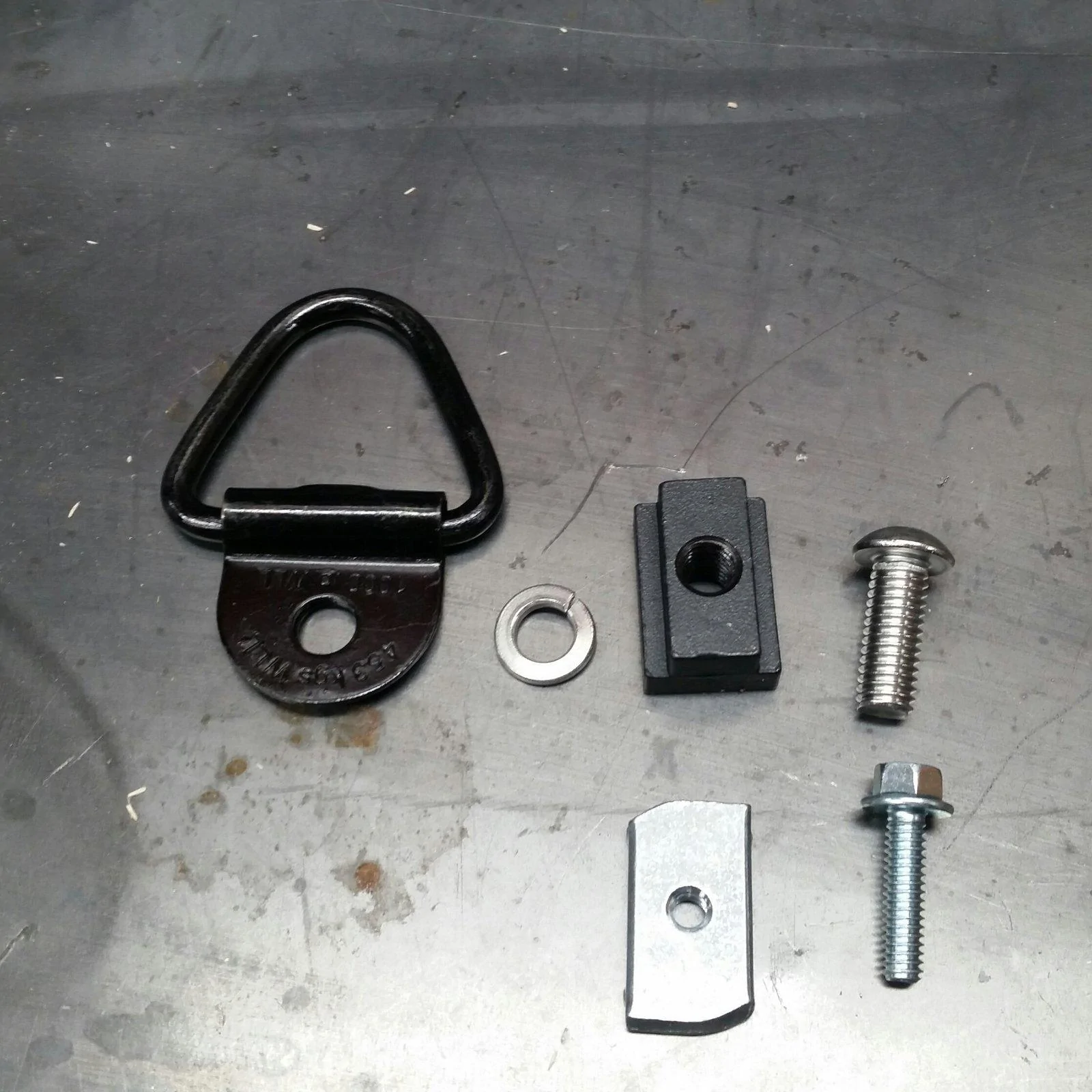

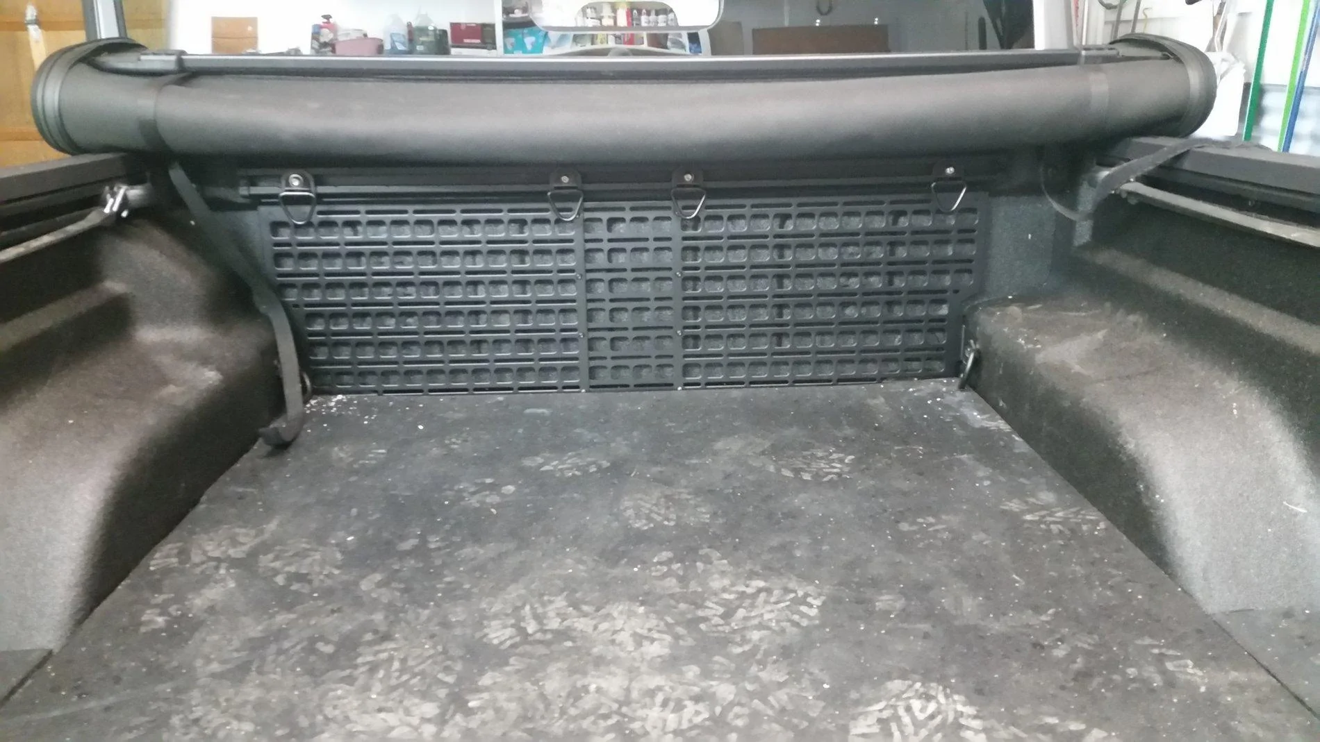

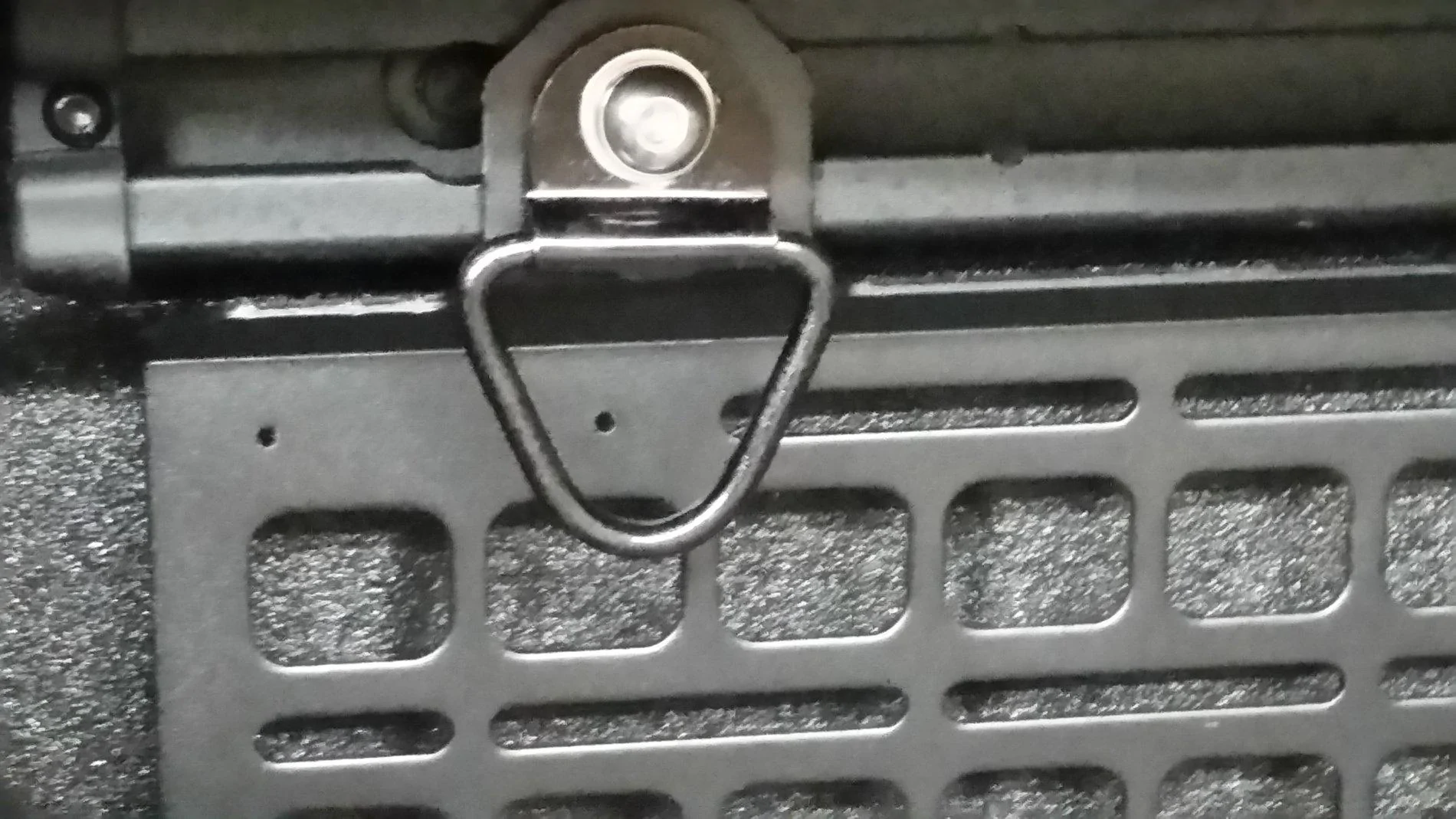

So I bought the Builtright (front) bedside molle rack and I thought I would give my personal review.
From the day I ordered them until they shipped was 3 days, they were well packaged and all of the parts were there, the install was a piece of cake, I did however make a couple of changes, first I used T slot nuts from a Tocoma, 3/8-16x1 ss socket cap screws w/ lock wash and added 1000lb bolt on V hooks. I am very pleased with the quality of the panels they are oprx 1/8 thick and the attachment points and panels are all one piece. We will see how they hold up to a hi-lift jack.
The first pic is a comparison of the bolts and flat nut that come with the panels, bottom row, and the ones I used top row.
