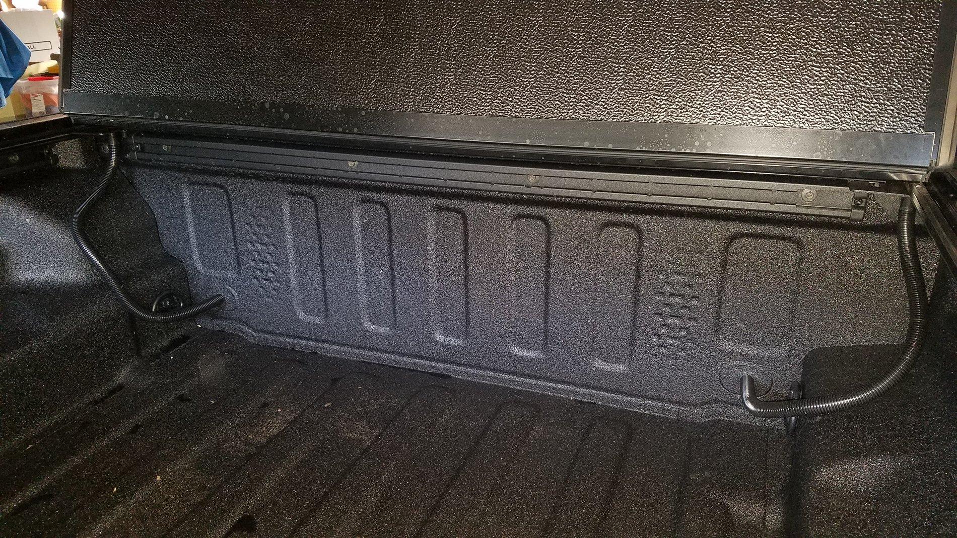

@BuiltRight — for those that have the hard Tri fold tonneau covers there are drain hoses that go to the front of the box. Do you have an option to get the front panels with cut outs that allow for these hoses? I’d hate to try to cut and repaint the panels if I don’t have to. Any options here?
(Photo posted by @N6WT in the thread here https://www.jeepgladiatorforum.com/forum/threads/factory-hard-tonneau-cover-hose-what-is-it.25736/)
My concern as well but didn't see an answer. Not going to purchase unless I know they would fit and work with the drain hoses

Don't know never got any response from Builtright left some messages. When I get around to putting that into the truck will probably go with the trail rail system and find some side panels that will secure into that and maybe one like was posted in for the front that has the ability accommodate the drain tubes
