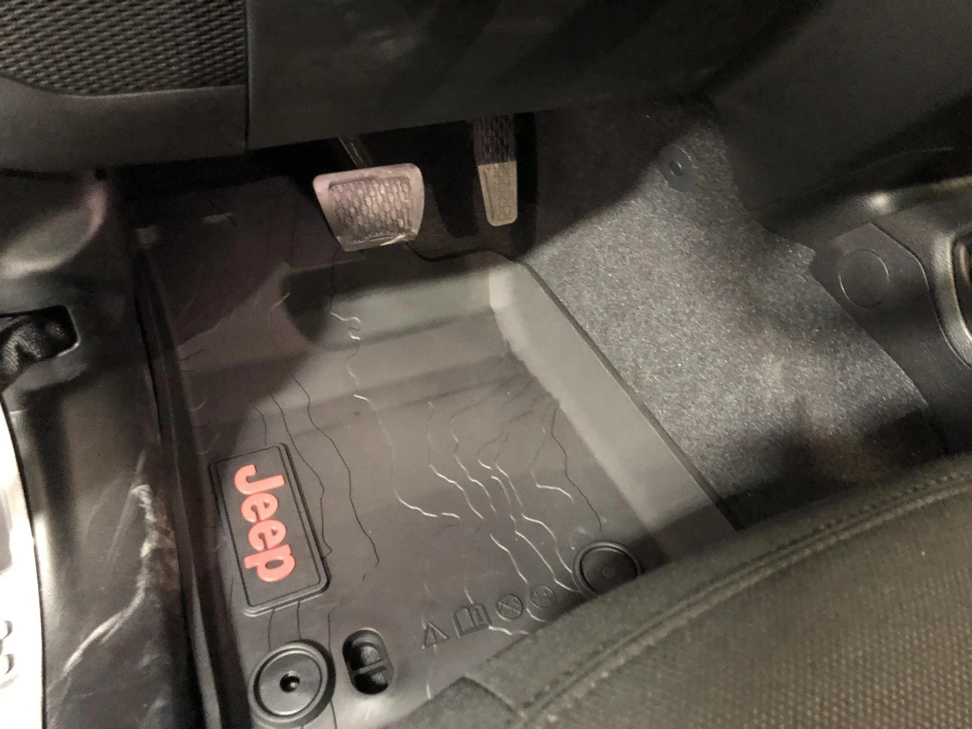

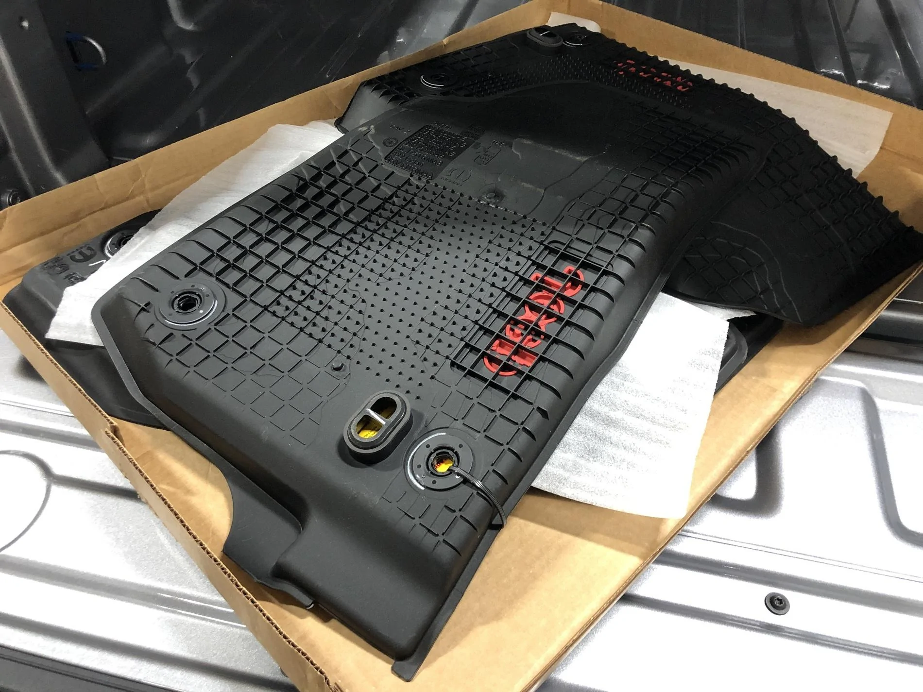

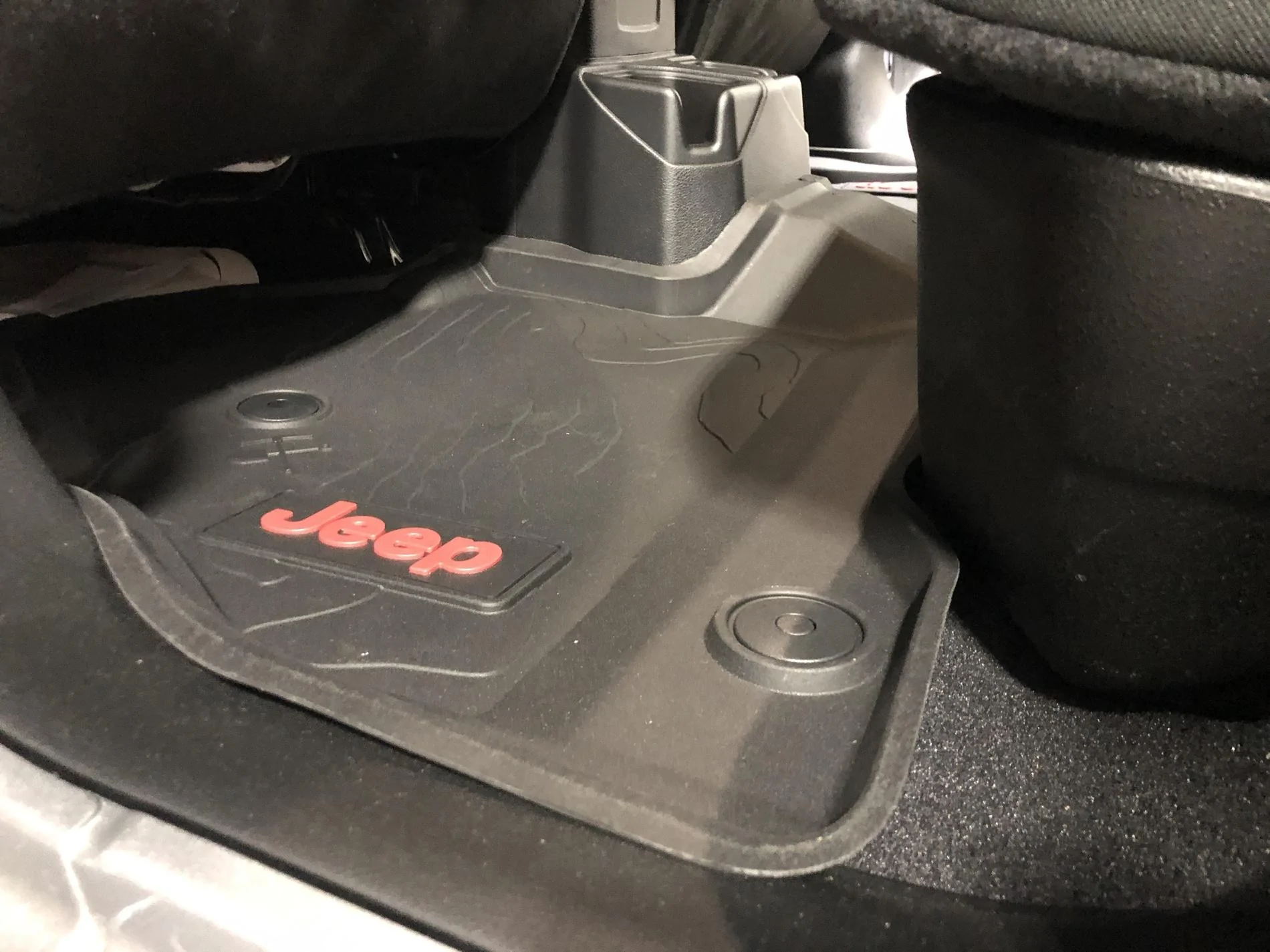

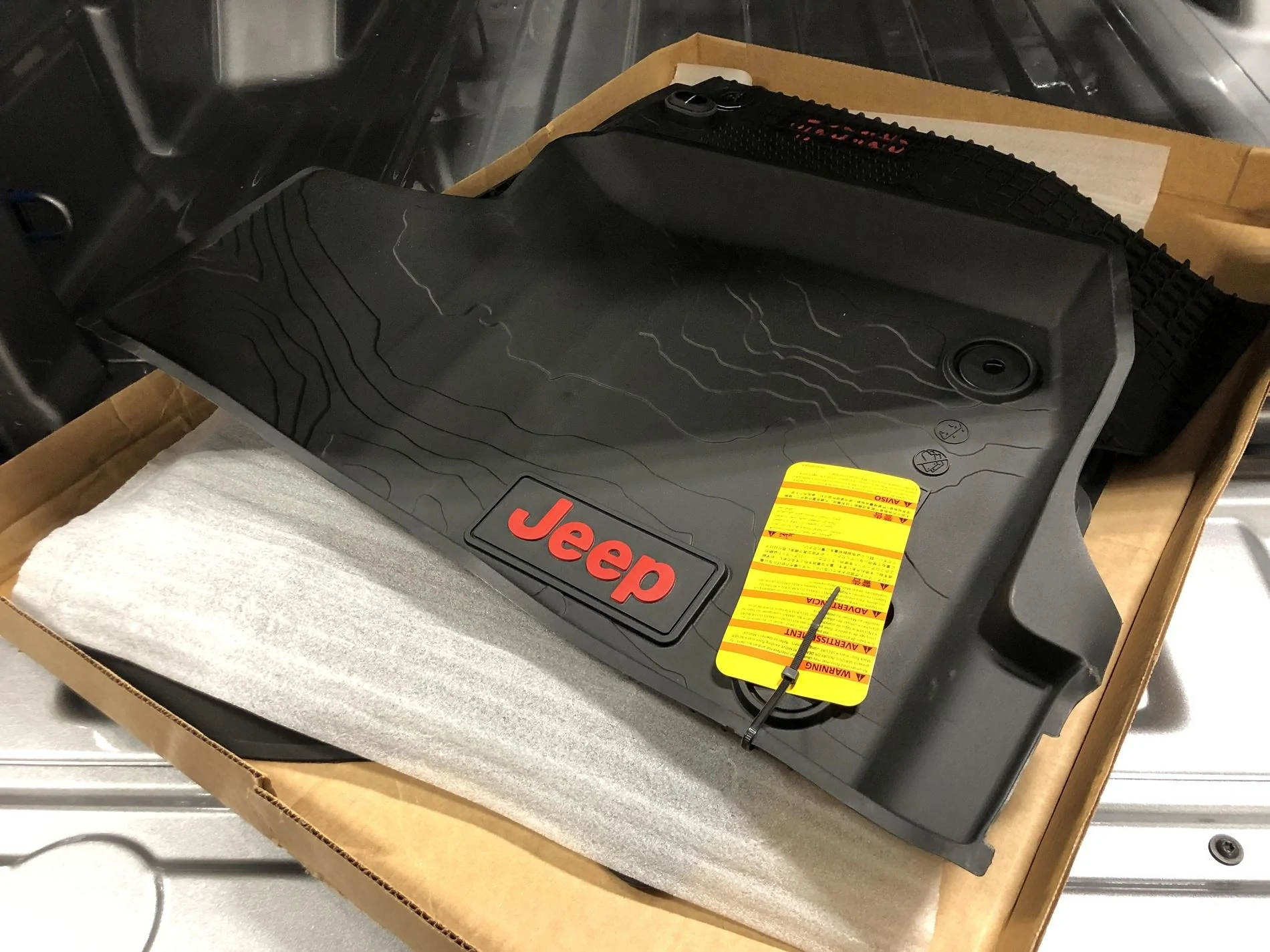

These OEM floor mats are pretty excellent. Better than the weathertechs and husky liners I've had in previous trucks for sure. Integrating the floor drain is great. I haven't cut them out yet, but will.
Dang, really? I was hoping the weathertechs would be better. There is a log of carpet by the go-go-foot that i thought weathertech covered.
I certainly prefer the JEEP and terrain topography details of the mopar ones though.
I should clarify, I meant as far as quality, fit and finish. The weathertechs for this particular truck may provide better coverage - that I dont know!
What do you think they are rubber or plastic?
They're a stiff rubber.
