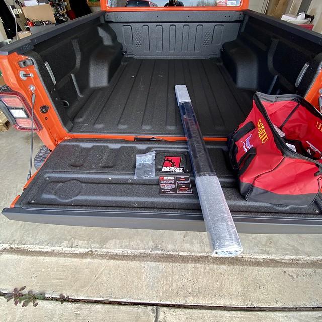

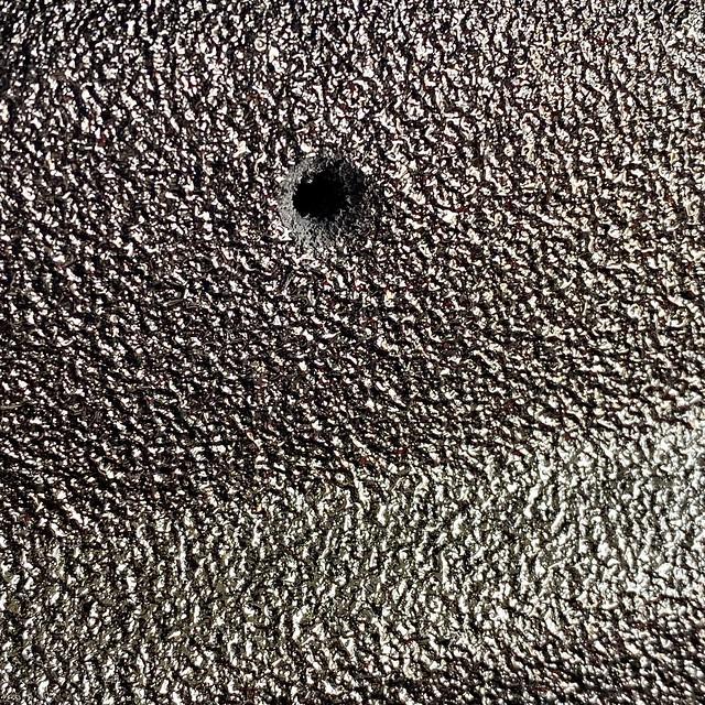

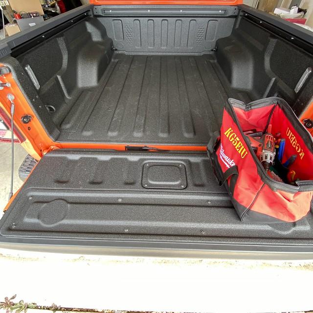

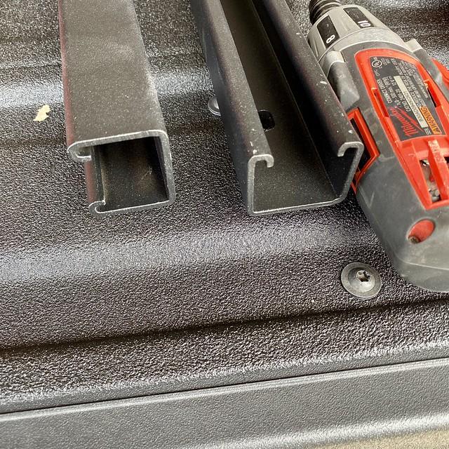

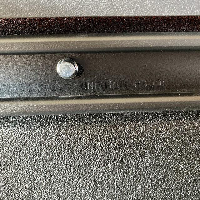

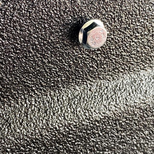

Got the Builtright JT Utility Rail Kit installed - took my time gently reamed out the bolt holes with the factory spray-in liner first and then pre-threaded each bolt into the bed side, avoiding cross threading them - no problems with any of them just went slow - really nice fit and finish and they are vertical flush with the sides of the box. Here are some install photos. I plan on putting some HAM Radio antenna mounts on them and other things.

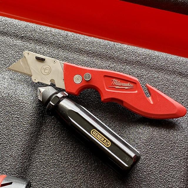

got that milwaukee utility knife and that bag. I got a 3/8" Surge impact driver. Its the bomb. So are the Builtright rails! Got them too!

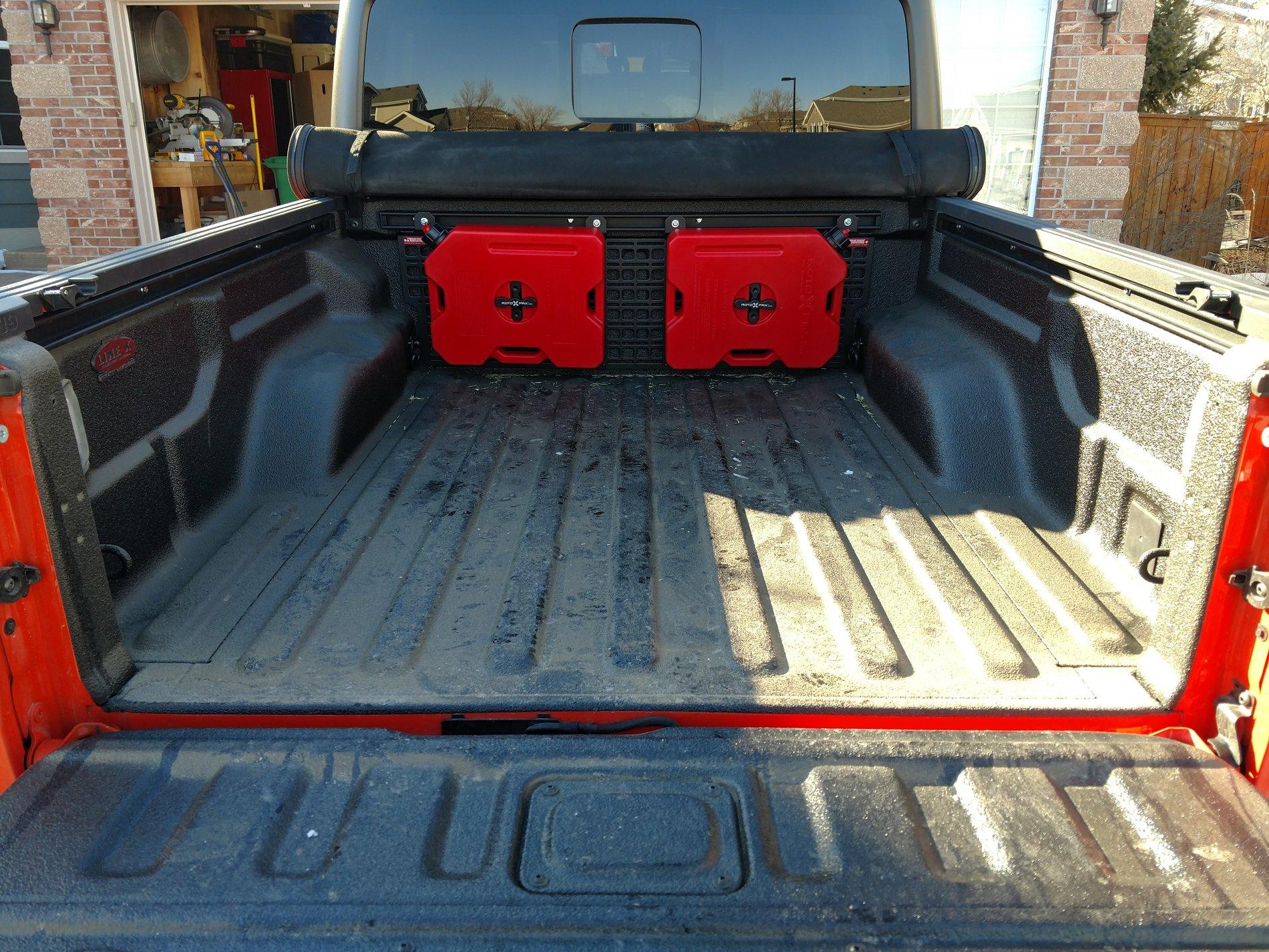

Just installed the rails the other day and tweaked the placement of the RotoPax mounts to be the way I like them. They were easy to install, though it took me a couple tries to get the RotoPax in a good place! This way I can carry gas on the trail or swap out for water. Still undecided on what to do with the sides since I want a bed rack...
I like the way you mounted the gas cans, keep me updated I'm very curious on this system plus bed rack or this system plus a tonneau cover which is what I'm really after.

Thanks! Since I'm a bit new to them I forgot I could just spin out the Rotopax mount on the center all-thread. I may situate them 90 degrees again but still on the far edges because it would give me more room in the center for something else. I think I'll have to trade out the factory tonneau with something else that has a rail that mounts to the top of the bed. I've seen several options, this is the portion of my build where I have to figure out how to keep a tonneau and be able to close it with stuff mounted in the bed and support a flush...ish mounted bed rack.

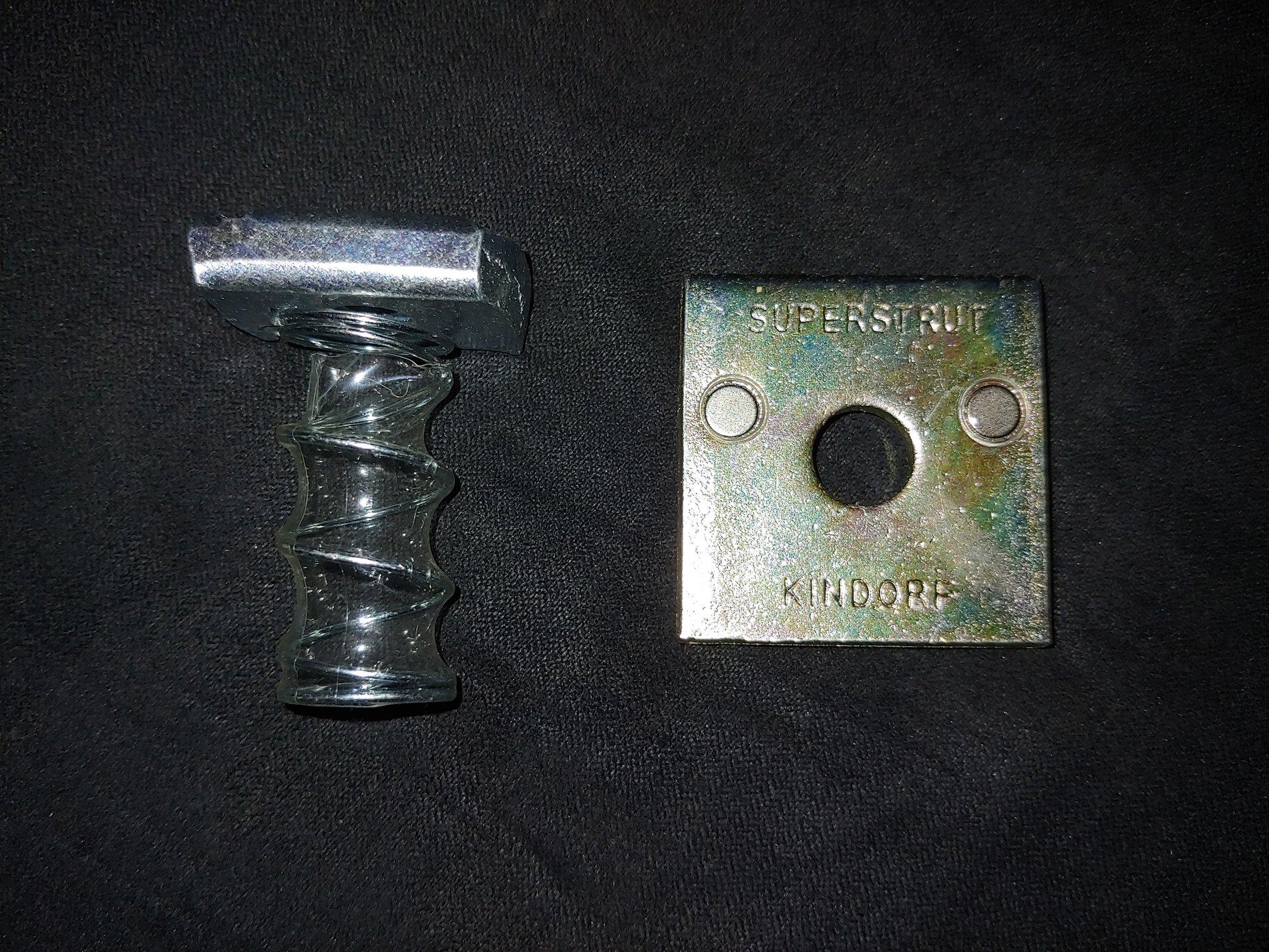

Here are the 1/2-inch spring nuts that work:
https://www.lowes.com/pd/Superstrut-1-2-in-Spring-Strut-Nut/1000109145
They also stock 3/8 and 1/4-inch. The outside dimensions of the spring nuts fit the channel - only difference is the diameter of the threaded hole.

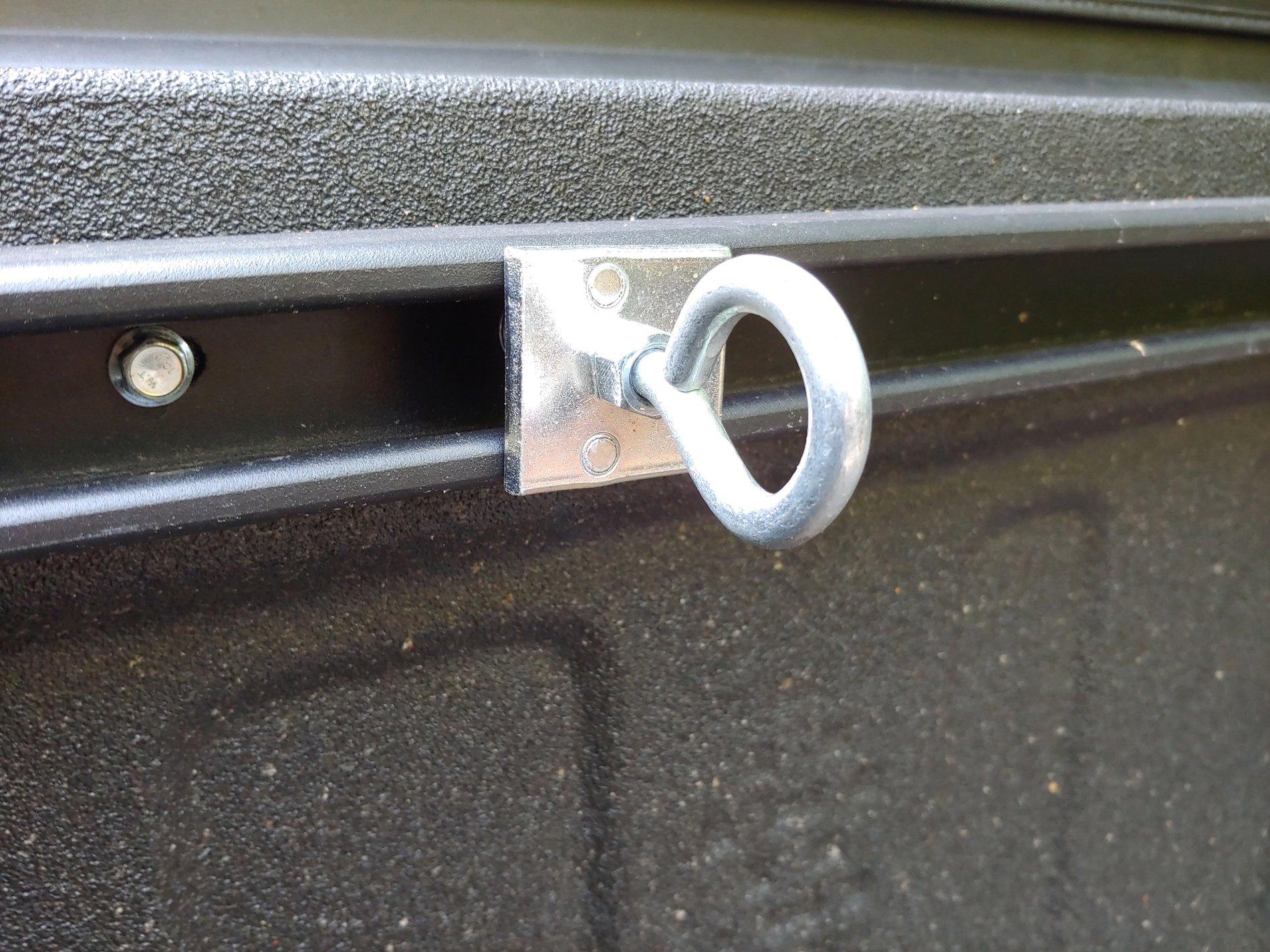

This solution was a little over $3 per.
Jeep Gladiator BuiltRight Industries Utility Rail System - A $230 Mopar Trail Rail Alternative Rail1
Jeep Gladiator BuiltRight Industries Utility Rail System - A $230 Mopar Trail Rail Alternative Rail2
$4.48 - 3/8 in. Strut Channel Spring Nut (5-Pack) : https://www.homedepot.com/p/Superst...nel-Spring-Nut-5-Pack-ZA1003-8EG-10/100179881
$5.96 - 1/2 in. Square Strut Washer Gold Galvanized with Magnets (5-Pack): https://www.homedepot.com/p/SuperMa...ized-with-Magnets-5-Pack-ZAB2411-2M/305573911
$.98x5 - 3/8 in. x 4 in. Zinc-Plated Eye Bolt with Nut: https://www.homedepot.com/p/Everbil...73498?storeSelection=3663,3616,3631,3634,3647
I did have to cut the eyebolt to get it to the length I wanted. There may be shorter ones in stock at your local hardware store that work without having to that. Also: the struts and washers are in electrical not hardware. The magnets in the washers are actually kind of nice but not required.
