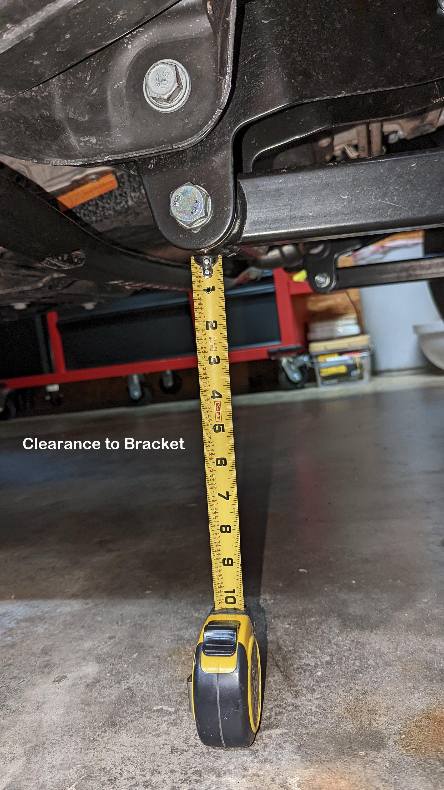

Note how the control arms are parallel to the ground in this photo.
That's correct geometry.
