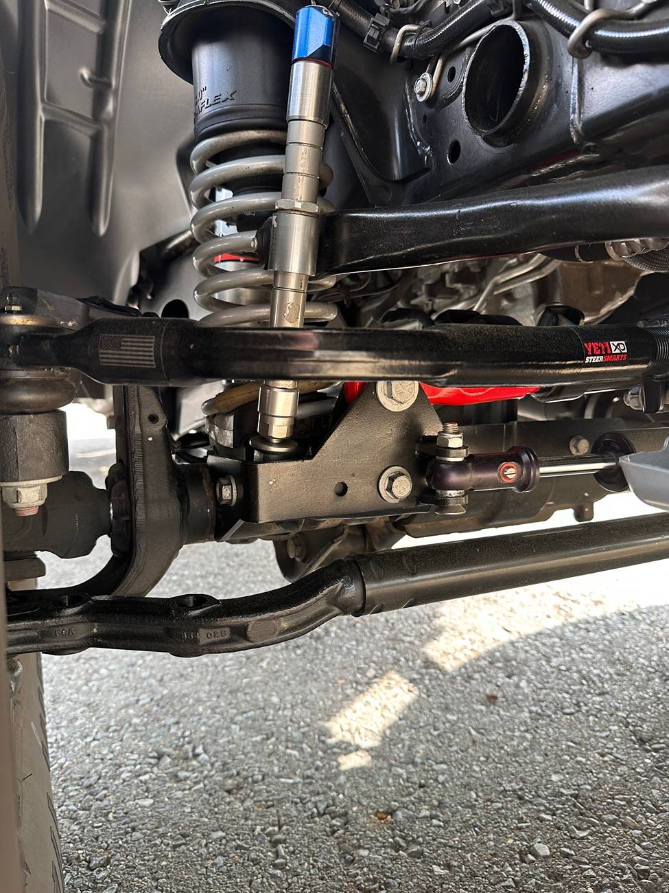

How is the relationship between your drag link and track bar? Since you have bump steer, I'm guessing they are no longer parallel.
Can you post a pic of the front showing the drag link and track bar making sure you have both ends in the same picture?

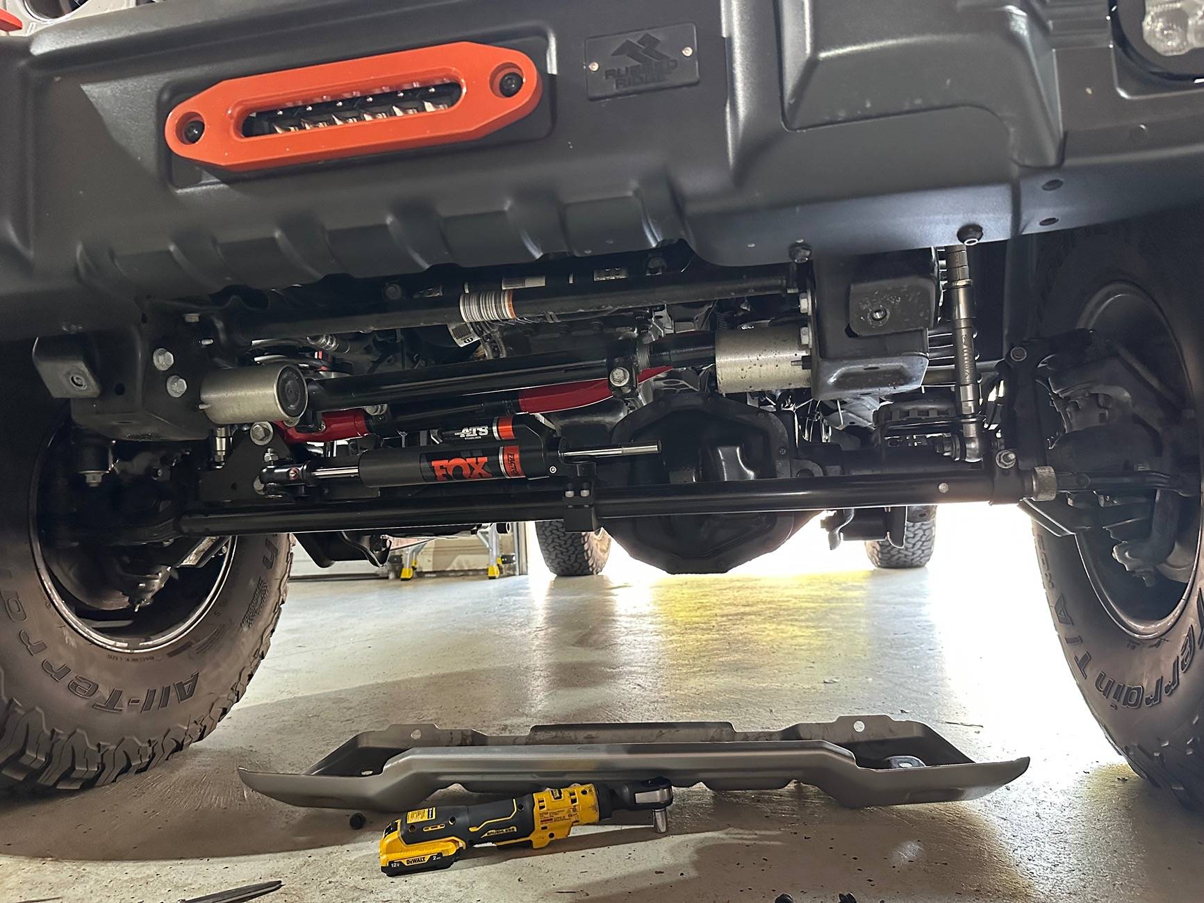

Here are some pictures. It is the steer smarts bracket and drag link so it should be aligned.

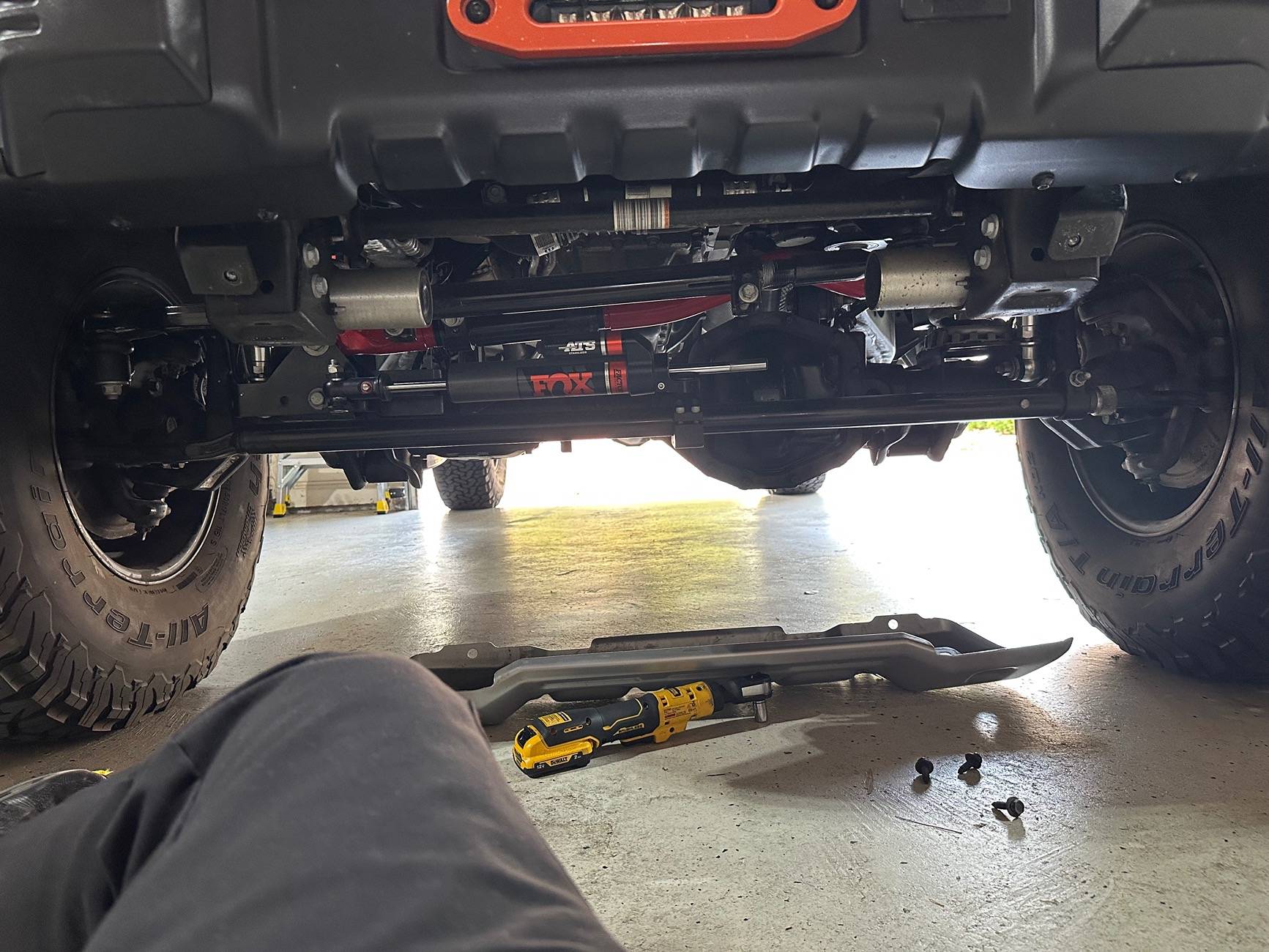

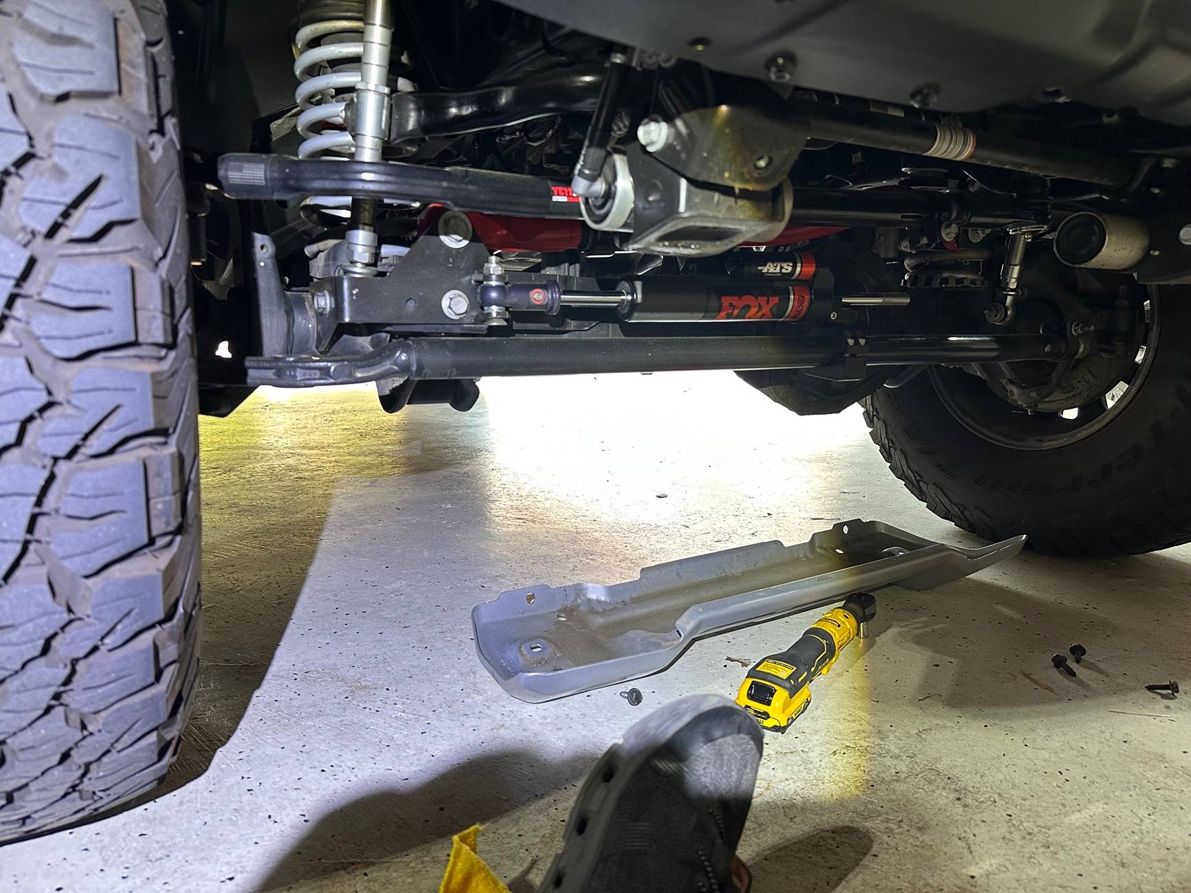

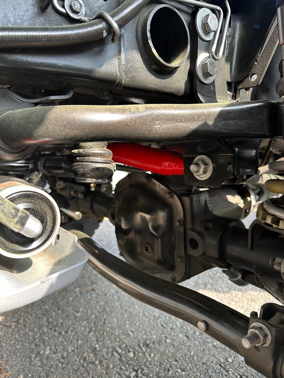

Sorry, I didn’t explain the pic I was requesting very well.
Can you take a pic straight on from the front and far enough back so you can see both ends of the track bar and drag link?

Dang, it’s just too hard to tell with the sway bar setup you have. It’s blocking the connection points in the pics so you can’t draw a line to see how they relate. What sway bar setup is that?
