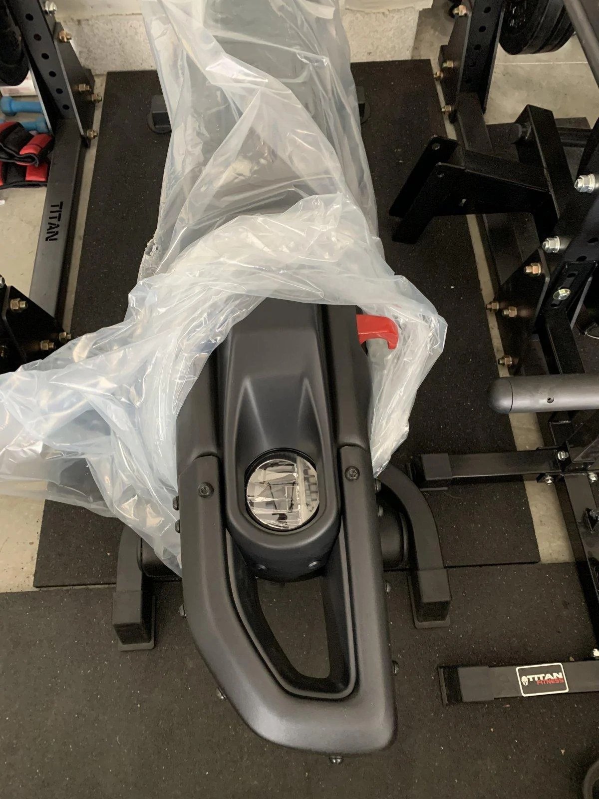

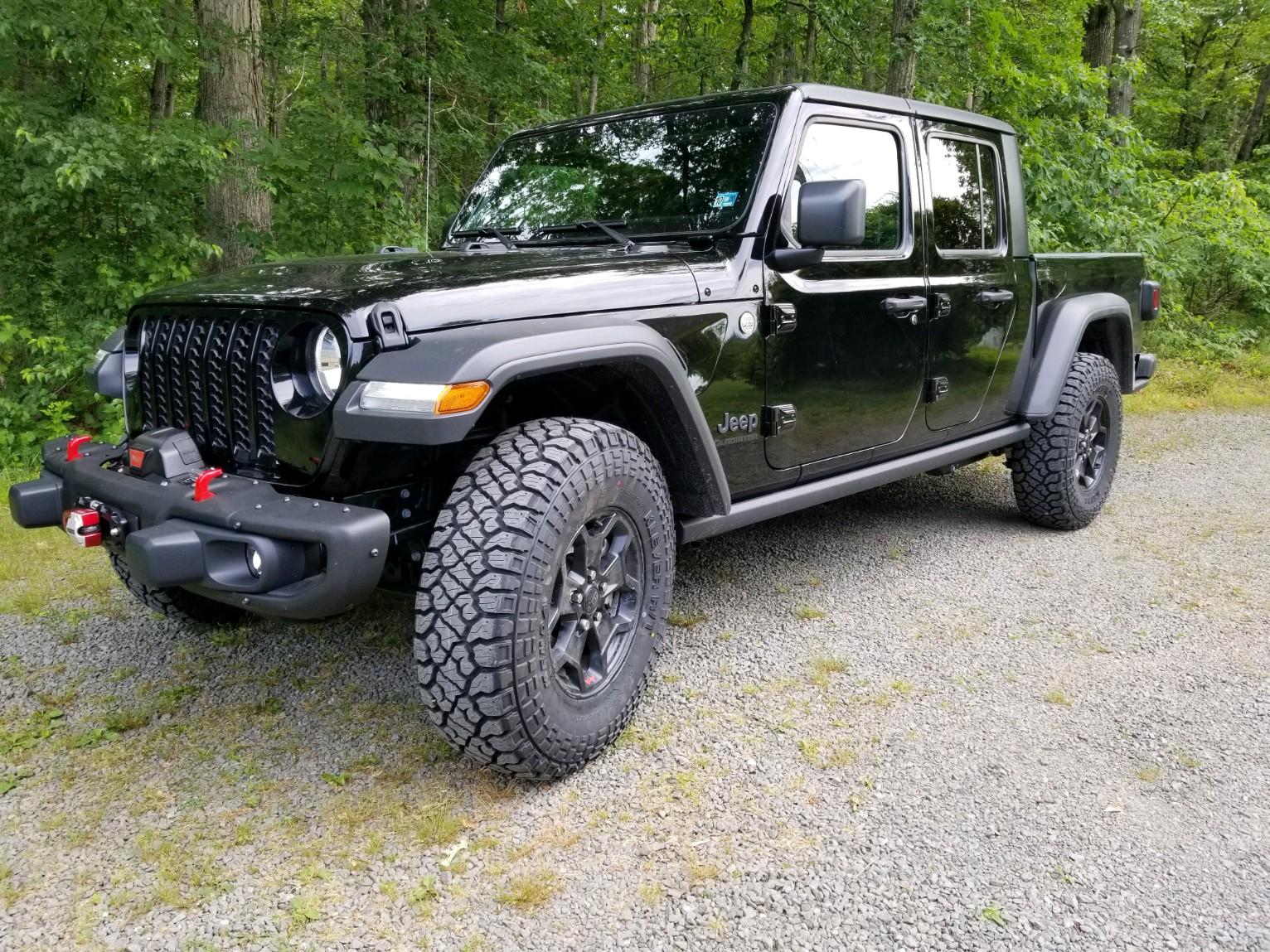

Ups just dropped off some BAM goodies. Got the mopar steel bumper, steel skid plate, brackets and hardware. I will install the bumper probably on Monday. For those that are interested I will take measurements before and after on how much of a drop I get before I do the teraflex spacer install. I will also try to take a lot of photos of the install for those that want this bumper on a sport.

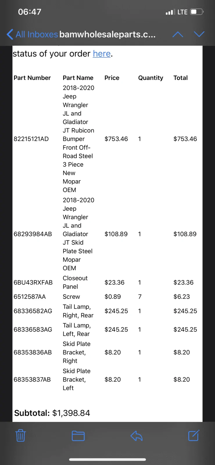

How much did you spend for this bumper? and from where?
I got the bumper from BAM wholesale. They had the cheapest price I have seen on the bumper. ($753). They are a wholesaler So you will have to order the bumper and skid plate separately. Skid plate was $108. The only other hardware you will need are 7 screws to attach the skid plate and potentially the skid plate bracket and close out panel unless you are running a winch in the future you will not need it. I will attach a screen shot of my order from them so you have part numbers for the close out panel, brackets and screws. I also ordered the LED tail lamps from them. Great customer service but the web site could be more user friendly. Do a google search as well. I want to say I got a Promo code as well. Hope this helps and let me know if you need anything else.

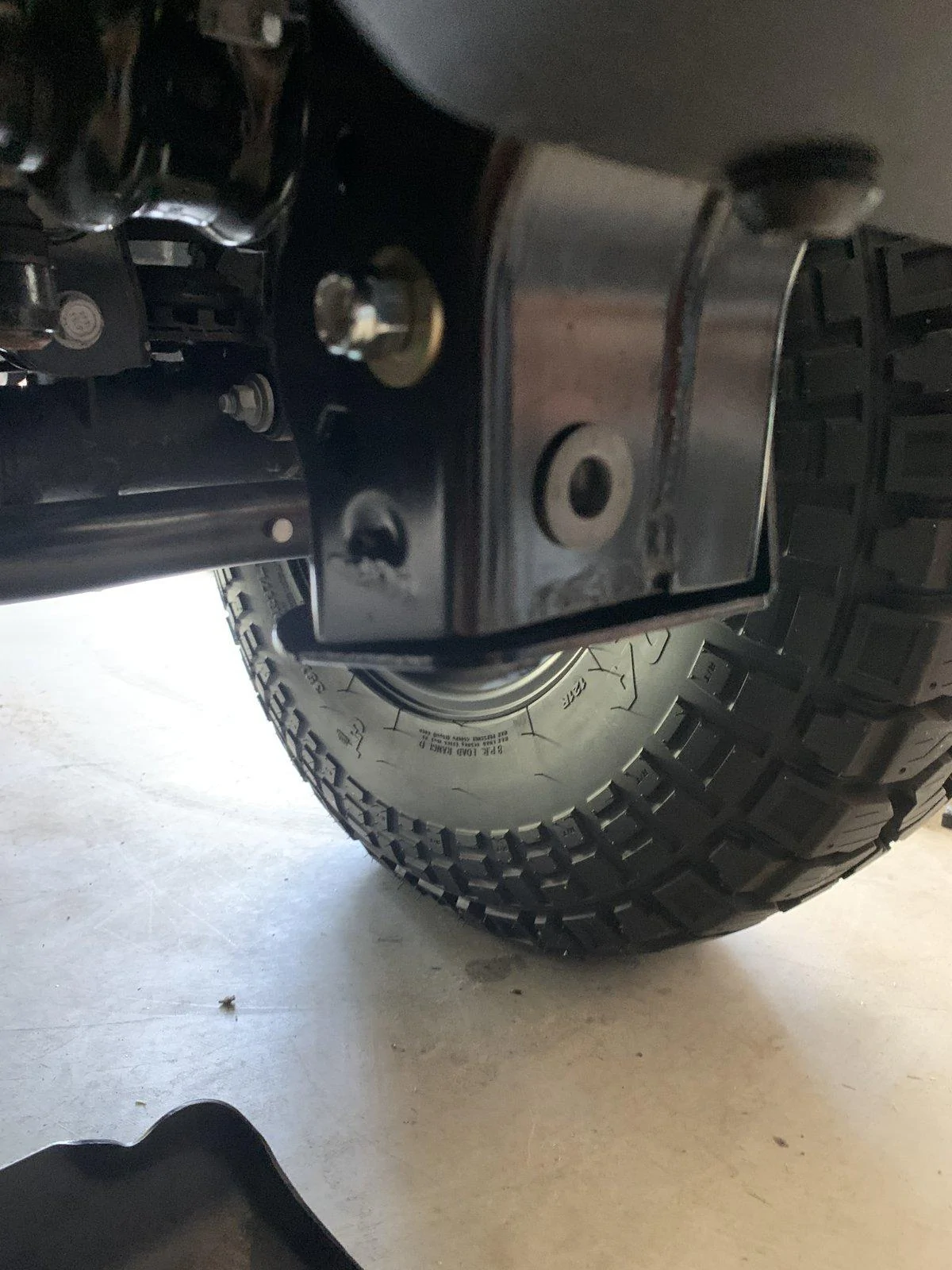

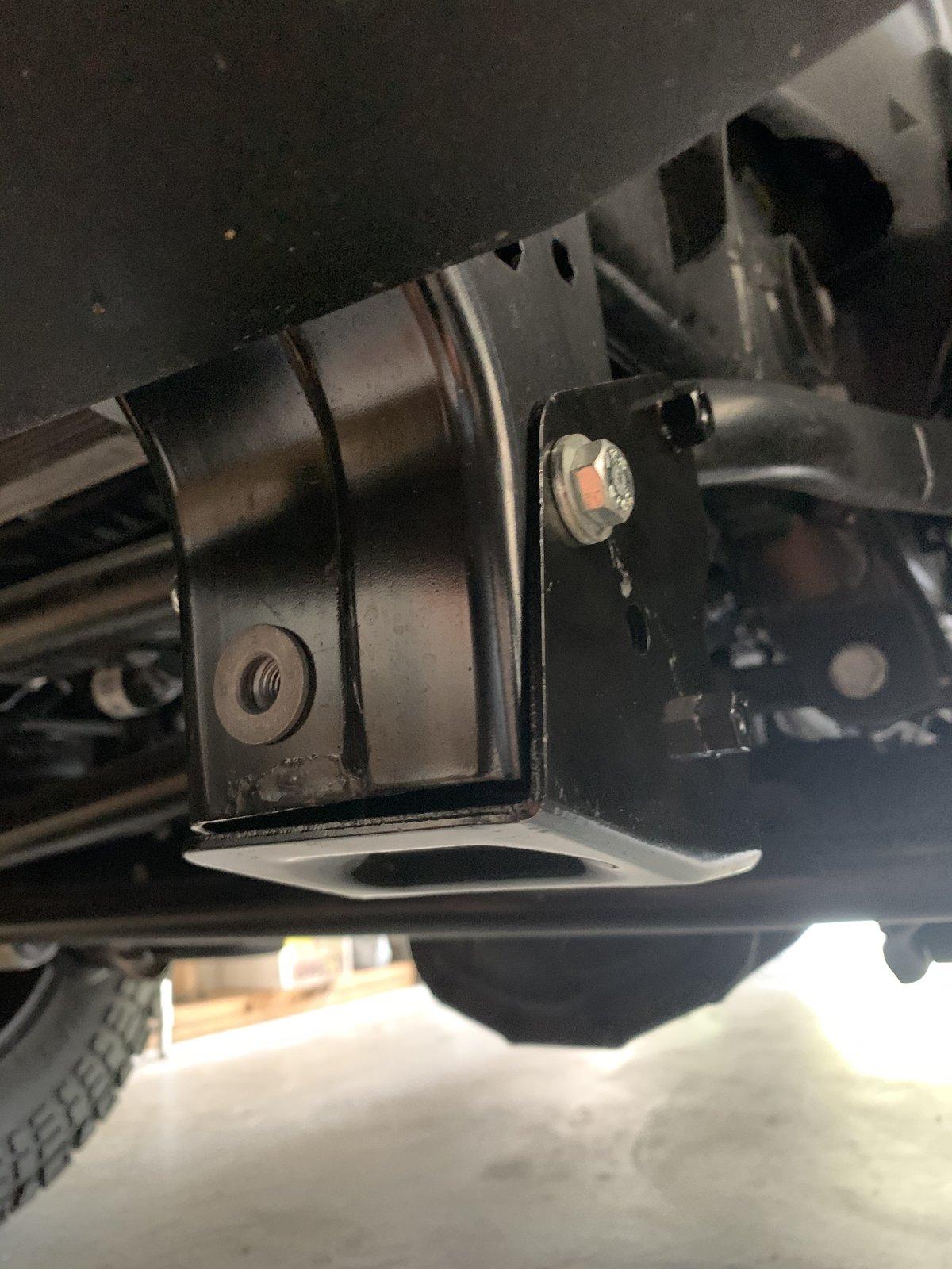

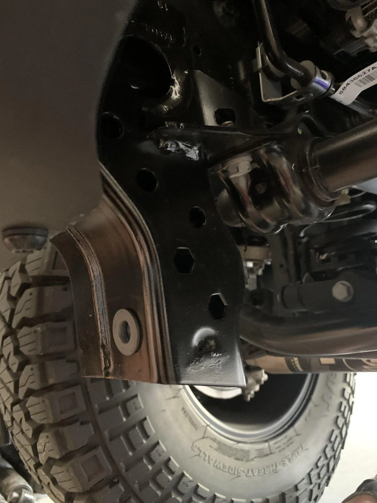

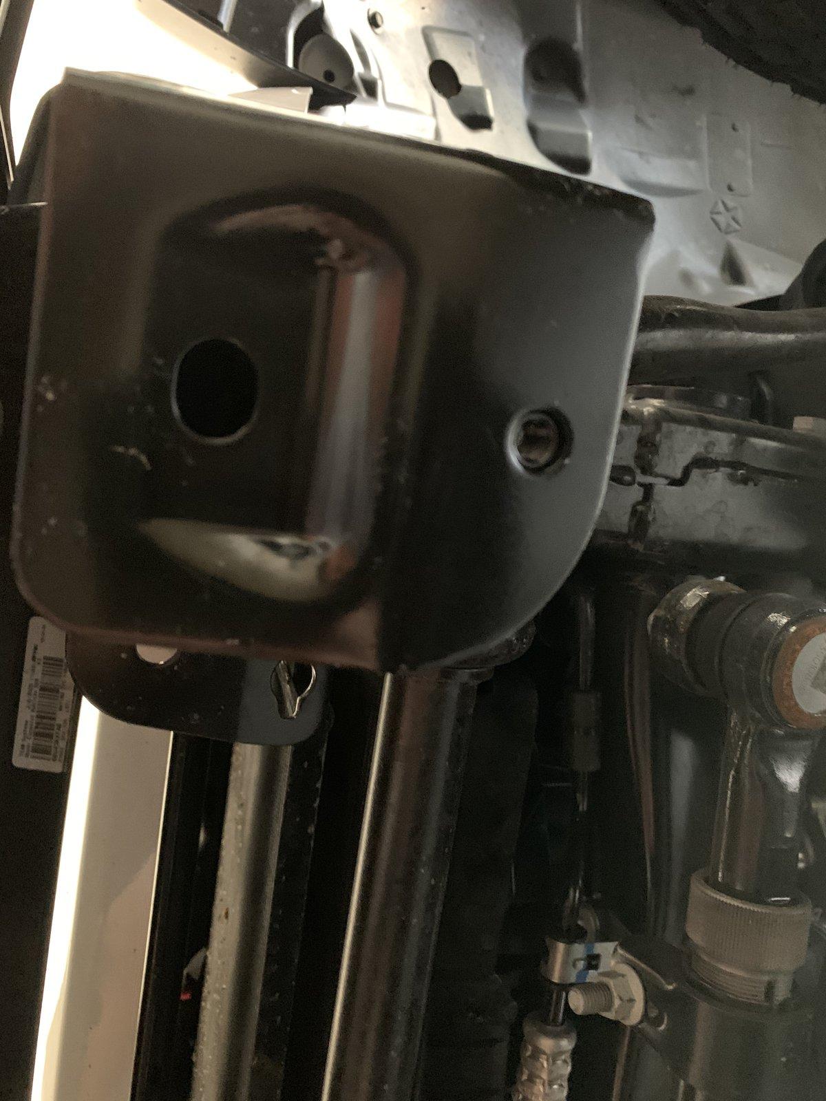

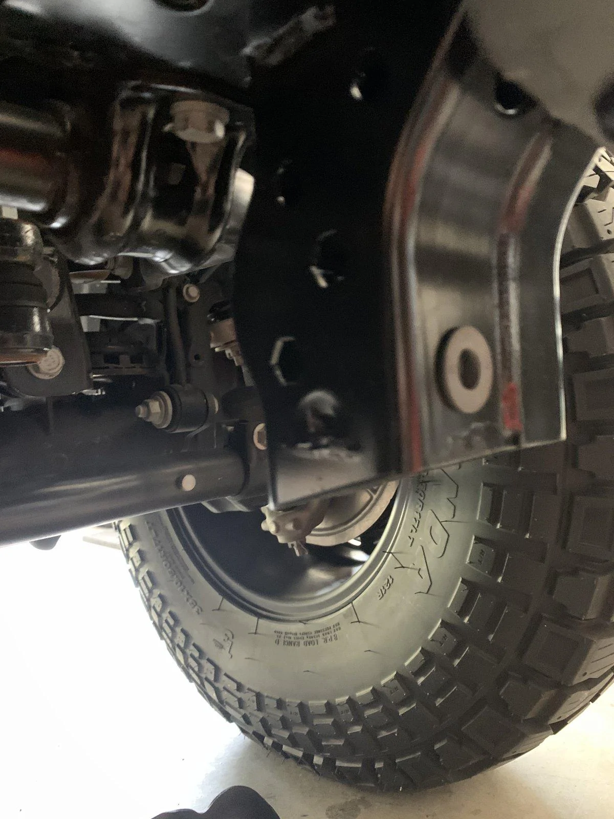

I'm about to do this and thanks for posting this part list! Did you have to use nutserts for the skid plate brackets?
You could use the nutserts. I was able to bolt the skid plate bracket to the existing bracket on the frame so the lower bolts on the skid plate could attach to. I forgot to order the nutserts but had some long enough bolts to make it work. For about a week I was able to run the skid plate without the bracket....it attaches to the bumper with 5 screws and makes it safe enough to drive but if you did any sort of trails you will want the 2 lower bolts in as well. Reading this reply, i know pictures would help. I will have a day in the garage tomorrow where I can take off the skid plate and post pics for ya.

When do you plan on placing the order? I got delayed yesterday and didn’t have time to get the skid plate off but I know I can before the end of the week.

got it done today. Attached are pics showing the sport factory frame without the skid plate bracket and then some pics with the bracket installed. I didn’t use the nutserts...I found a whole in the bracket that I was able to run a bolt and locking nut through. This allows the 2 bottom screws in the skid plate to attach to the bracket.

Thank you for doing this! These pictures are very helpful!
