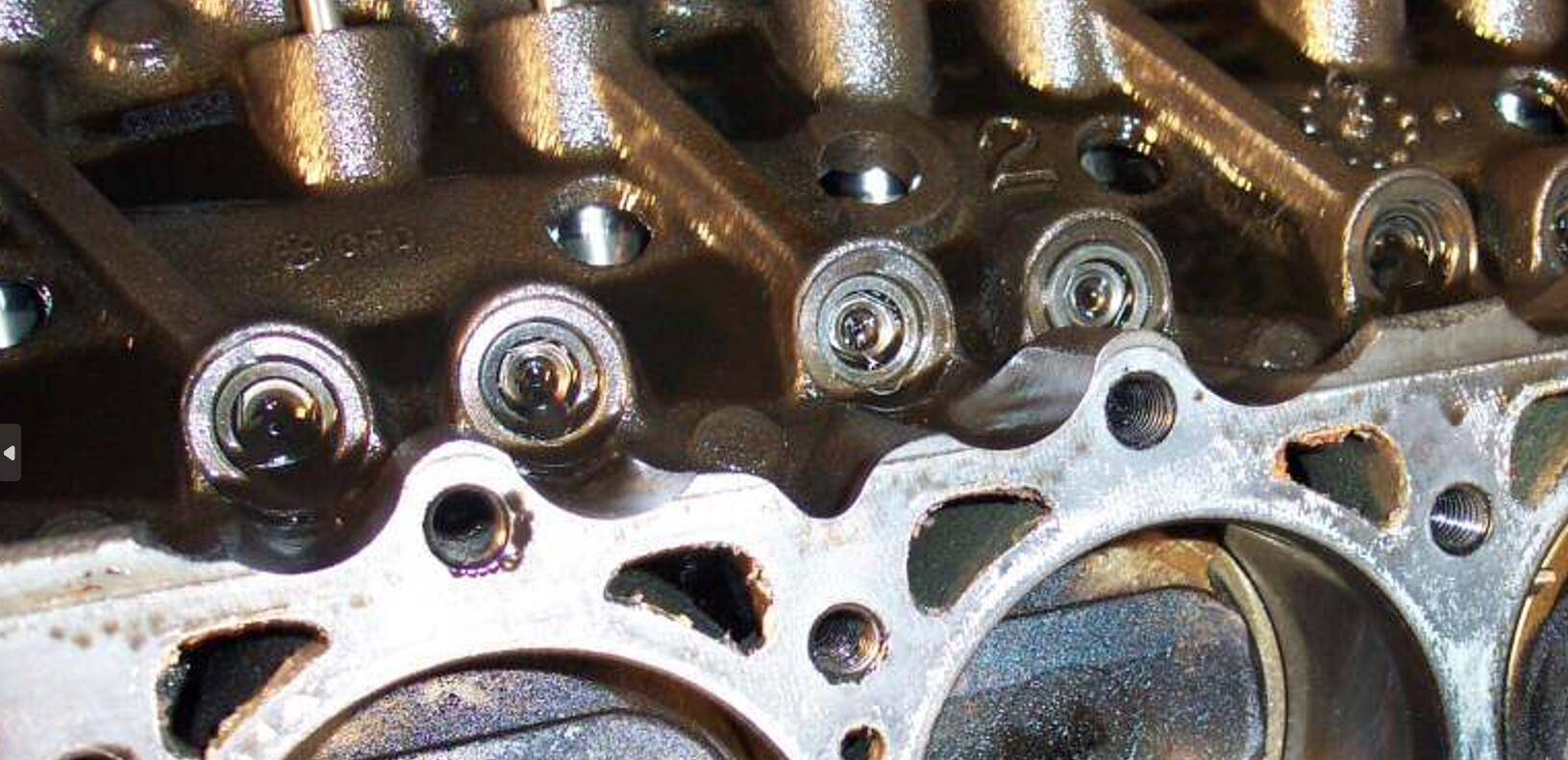

One of the reasons I put a large flat pan under the engine on a stand when I disassemble it is to catch all of the oil that runs out of the oil galleries, the oil pump and other parts. Taking apart an engine is messy work Keep the 'floor dry' (or cheap kat litter) ready and a pan under the engine.
Even sitting for weeks, there will be oil in places.
An AMC 390 I worked on - a lot of oil when I finally turned the thing over to pull the pan, then the oil pump dumped oil all over when I pulled it off.
Jeep Gladiator Burning Oil on Statup 1753240662382-7h
(Busted piston at 24,000 miles)
