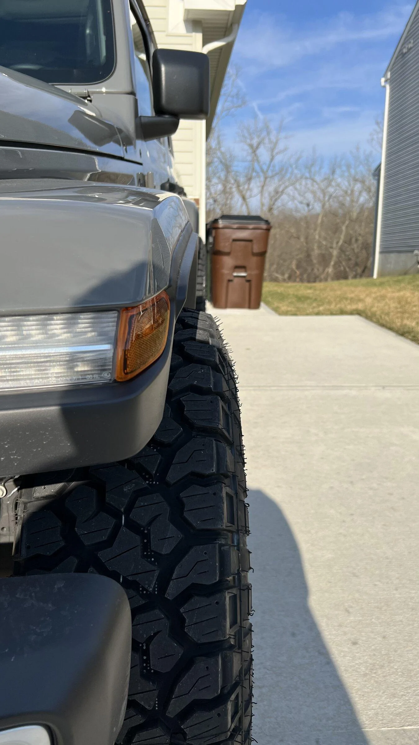

If you’ll never lift, +25 on a 8.5” wide wheel will be closest to flush. AEV and Method make wheels in +25. If you want to lift, you’ll need a bit more. Here is my 17x8.5-0mm offset on a Max Tow (wider axle like the Rubicon). 35x10.5 tires. 4.75” backspacing and that’s the highest backspacing to fit a Clayton kit.
Depends on the lift, AEV makes a couple different lifts for the JT that can run up to 37” tires on their wheels with their lifts, Mopar lift should work with +25 wheels as well.
