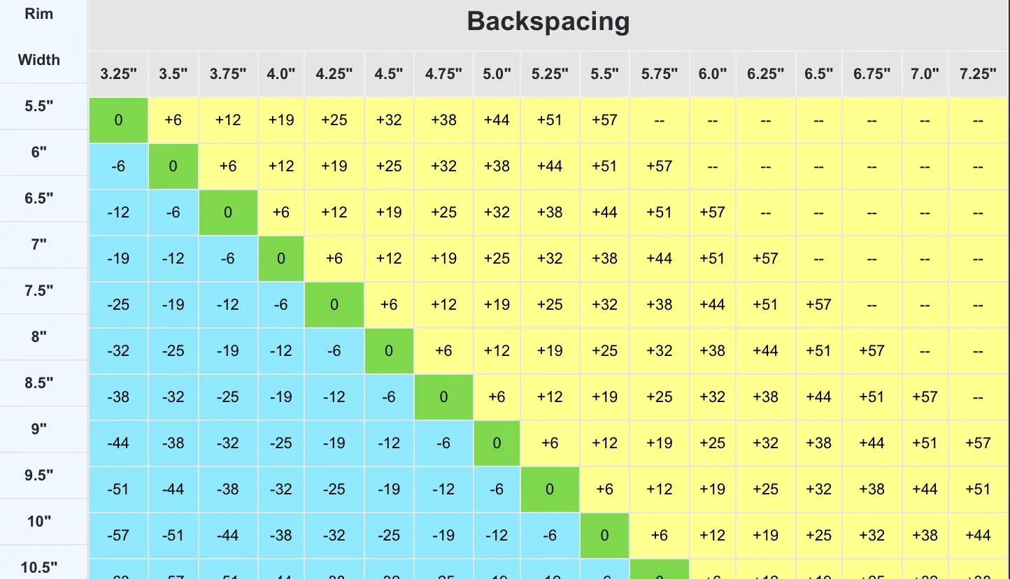

Oh, that’s correct about Mojave wheel offset. I missed that it was a Mojave. Be aware though that backspacing and offset are not always directly proportional. A 5” backspacing wheel’s offset will vary based on the wheel‘s width.

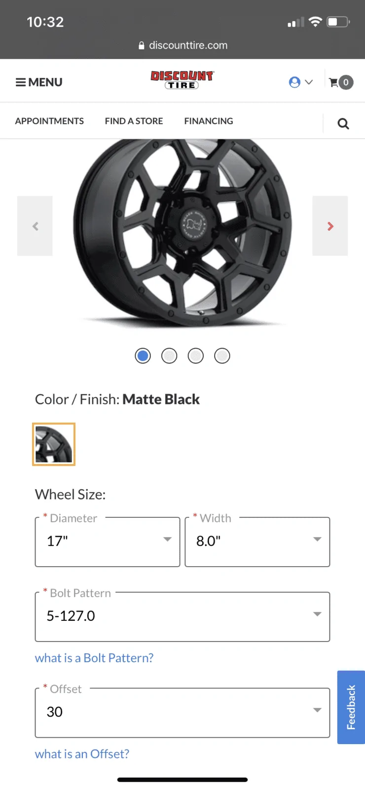

The 8.0” wide Overland is a +30 offset and the 9.5” wide is the -18 offset. Not sure what tires you’re looking at, but the Overland has an offset option that might work for you.

Thanks for that info! That is my quandary with the Overland wheel... the +30 offset would work, but the 8” wide concerns me with crowning the tire.. as I’ll be mounting 35/12.50/17 Ridge Grapplers. I like the 9.5” width better, but I don’t want that much tire sticking out with the -18s. My second choice is the Fuel Kicker - good width with a +1 offset. Probably the way I’ll go.. unless I keep looking
