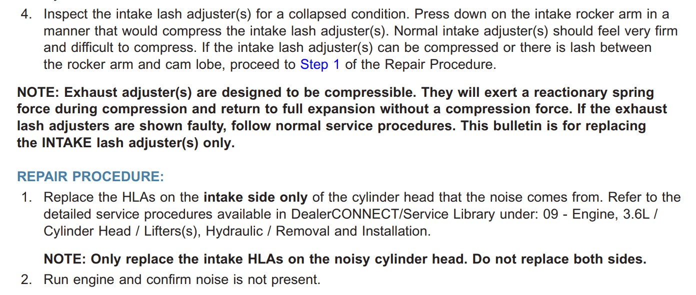

https://www.jeepgladiatorforum.com/forum/threads/cam-rockers-and-lash-adjusters-at-39k-miles.79055/
This is the thread I started about it. I had 39k miles on it when I fixed it, probably started at 30k.
There are TSBs about a ticking noise. Just says to replace all intake lash adjusters and any worn rockers. I'm guessing (emphasis on guess) that the lash adjusters malfunction somehow and the oil doesn't get where it needs to go. Then lubrication isn't sufficient, then self machining cam of sadness.
249
40,513
54,110
The TSB is for lash adjusters. Doesn't mention followers at all.
Says if it's noisy, replace the lash adjusters on that bank. Nothing more or less.
It does mention exhaust lash adjusters and how to check them - replace if faulty, but again, nothing about other parts.
HOWEVER, if you run with that tick long enough, the hammering effect will likely damage other parts so while the TSB is assuming you have an abnormal tick and deal with it right away, we know there's a reality that it won't get dealt with and other parts may be damaged. The TSB deals with the tick - hopefully the person doing the repairs is smart enough to look at other parts since you need to disassemble things to get to the lash adjusters anyway.
