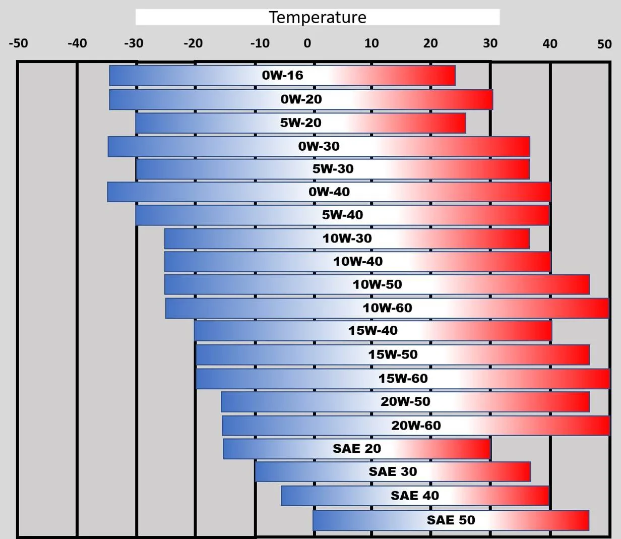

I never said 200 was bad. I had been running cooler in earlier posts and wanted people to know that with the warmer weather I am seeing an increase in temperature. 200 is probably about perfect seeing as the coolant runs about 190 on average and the oil is cooled with that.
I stated in my post that the brand has nothing to do with it being better, only the ZDDP which is limited to 800ppm in API certified oils do to the effect it has on catalysts. To increase oil film retention, I chose to go with an oil that has an increased amount of ZDDP. The race oils from any reputable brand are likely just as good (Project Farm on YouTube actually proved Ams oil is marginally better than RP). I chose to go purple.
As far as the ZDDP content is concerned it really is only better because the high lift rockers and cam lobes (whether engaged or not) slide against each other instead of roll.
I'm not trying to debate engine temps. I will be towing around 4k in a trailer. I want to do everything possible to keep the engine and drivetrain as cool as possible. I understand manual shifting the auto 8 speed, and watching rpms. I hope the cooldown function set to manual with the tazer mini will help too. I like the thoughts of changing oil types. I just past my warranty mileage so I am open to anything to extend the life and capability of my gladiator.

Some of what you're talking may well shorten engine life.
"Watching RPM" isn't necessarily good. You do not want to try to force lower RPM. That can lead to excessive chamber temperatures and extra heat and load. These are made to wind up.
Apparently you don't understand manual shifting and "watching RPMs" - I let mine wind up - 3000s and 4000s when needed, what I don't allow is a constant up/down/up/down shifting in our hills. So I cut some of that back with manual shifting only when needed, otherwise, let it wind up.
Manual shifting is used to prevent excessive "hunting" or shifting when in automatic mode in hills. Not to force lower RPM.
Changing oil types is something few understand - and can also lead to shorter engine lift.
Higher viscosity can lead to more oil sheer, and higher oil temperatures in the bearings and at friction surfaces. Higher viscosity can also mean slower oil movement - which leads to higher oil temperatures.
15,000,000 of these out there, many with 100,000 miles or more trouble-free, running on the recommended oil.
My understanding of the 'cool down" function of the tazer is to keep the fan running for a short time after shut down. Helps with heat soak, but not while driving.
