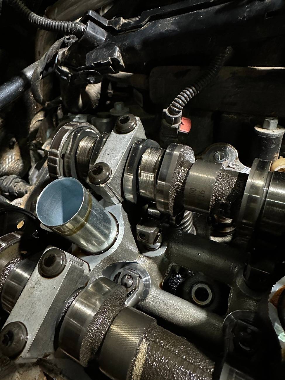

Its going to be both... and your cam shaft is going to be toast. No use replacing one and not the other.

If you look at my pictures, you will see the cam shaft is totally shot.

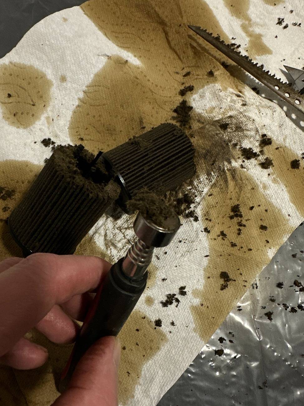

Unsuccessful. Took me half a day just to get to the valve cover, when I finally got it off. Two of the intake rockers were bad and had shaved the down the cam pretty horribly. We were moving to one state over in 3 days and I didn't feel comfortable removing the timing chain and replacing the cams. So I figured I would just tow it behind the U-haul. Nope. U-haul doesnt allow Jeeps to be towed behind their moving trucks. Same rule goes for the 3 other moving companies. So my only option was to drive it 175 miles. We made it 3/4's of the way before the check engine light came on, but we pushed on and thankfully it made it. Now it sits in my driveway as I am waiting on my 401K to be released so I can put it in the shop. Which should be any day now.
I'm 99.9999% sure, they are going to have to replace the engine. If that is the case. I was thinking about asking them just to put a V-8 in it. Or at least ask how difficult it will be and expensive.
I attached a couple of photos to show you what everything looks like. Oh here is like the cherry on top. I was going to do an oil change before we left, just so it would have some fresh oil. Well the people I took it to last time ( which I never do. I always change it myself) , put the oil plug back in with an impact wrench. I stripped the bolt trying to get it out. So since that was a no go. I figured well might as well atleast change the oil filter. I cut it in half and put a magnet to it, just to see how much metal was going through..... Well you can see how much is in there, lol.
All in all Id say this has been a complete nightmare, lol. Thanks for asking though.
