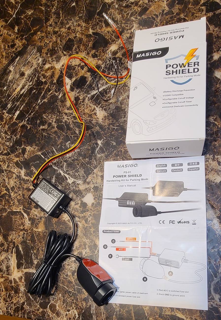

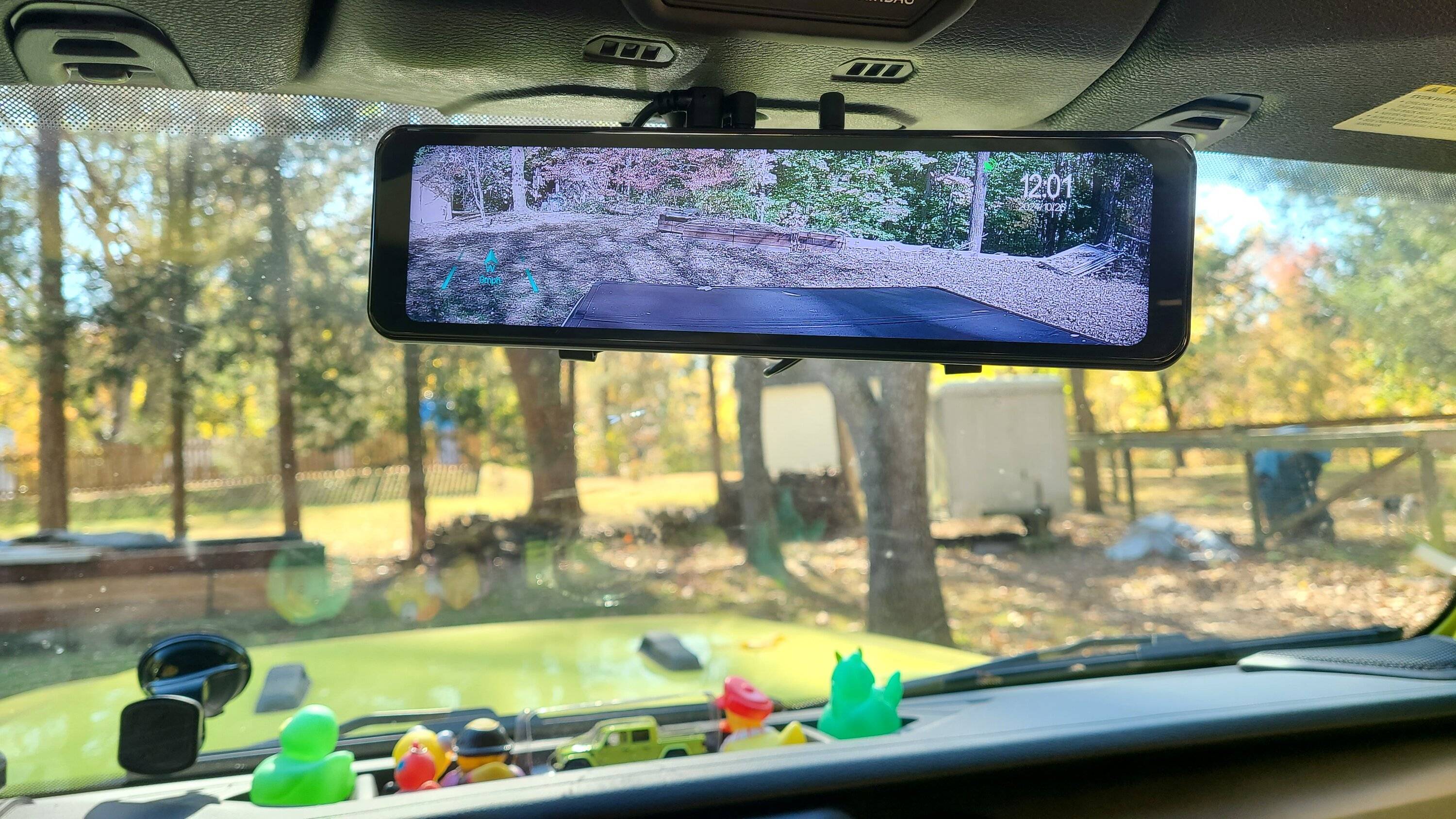

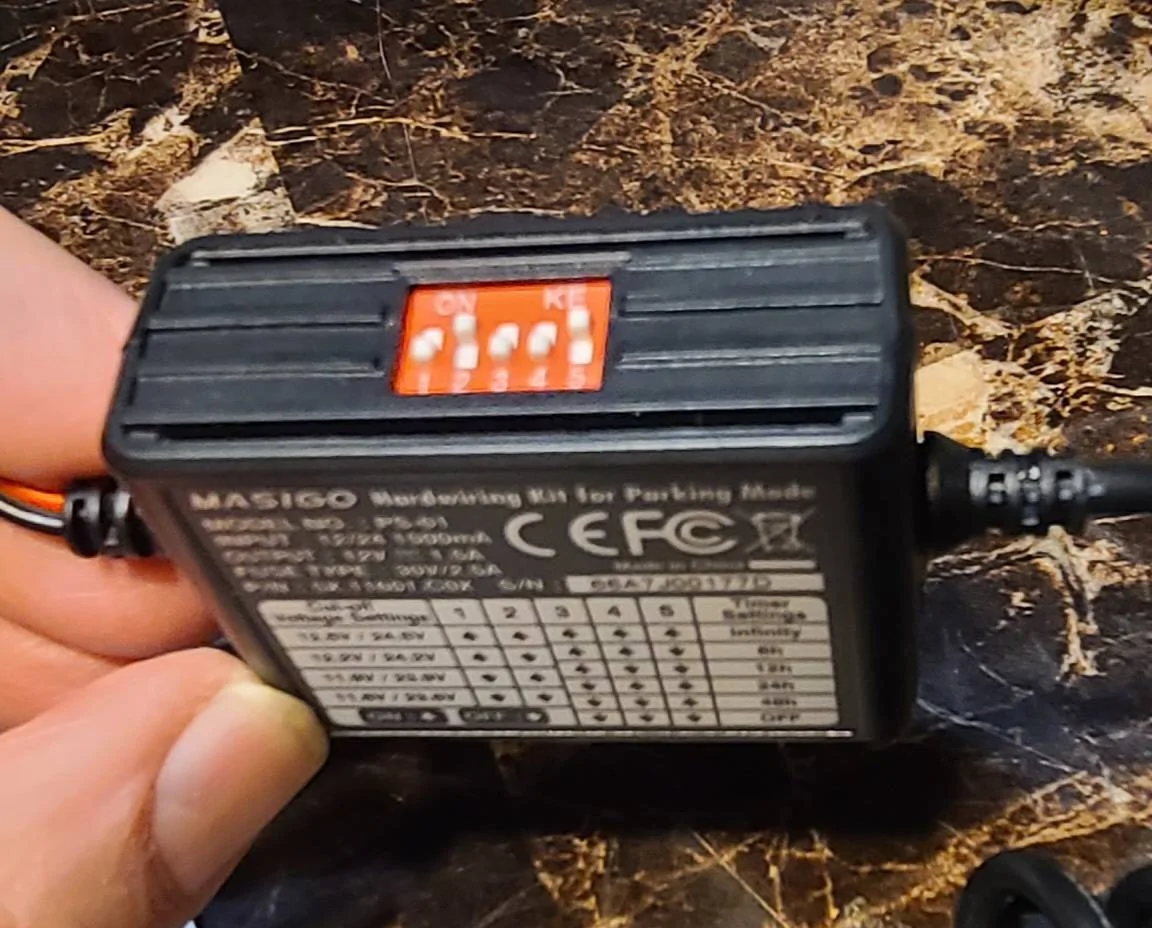

Here's what I ended up getting. It looks simple to install. Only 3 wires to hook up (key-on power, always-on power, & ground), and just plug in the camera into the lighter style receptical.
