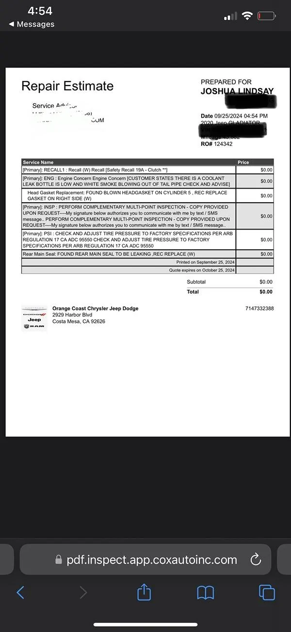

you sir were correct
Jeep Gladiator Can’t find coolant leak BF141D3B-8BE9-4E23-9C87-AA88C3D600B2
Blade1668
Darrell
Jan 7, 2020
3,277
3,162
N. AL.
BYW what is your mileage range? I'm close to 100k now. I already bought a oil cooler assembly as preparation and looking at ordering a set of spark plugs and coil packs. Fortunately, I decided not to start my locker install with the current rainy weather happening now.

That's a bummer. At least you know what it is now. Bummer that the rear main seal is leaking as well. Hope the repair goes well. I almost bought my JT at that dealer, but found one closer to home.
First time I’ve been to this one I have no complaints service advisors are good and so far they don’t seem to be giving me any Trouble I had no idea about the rear main…
