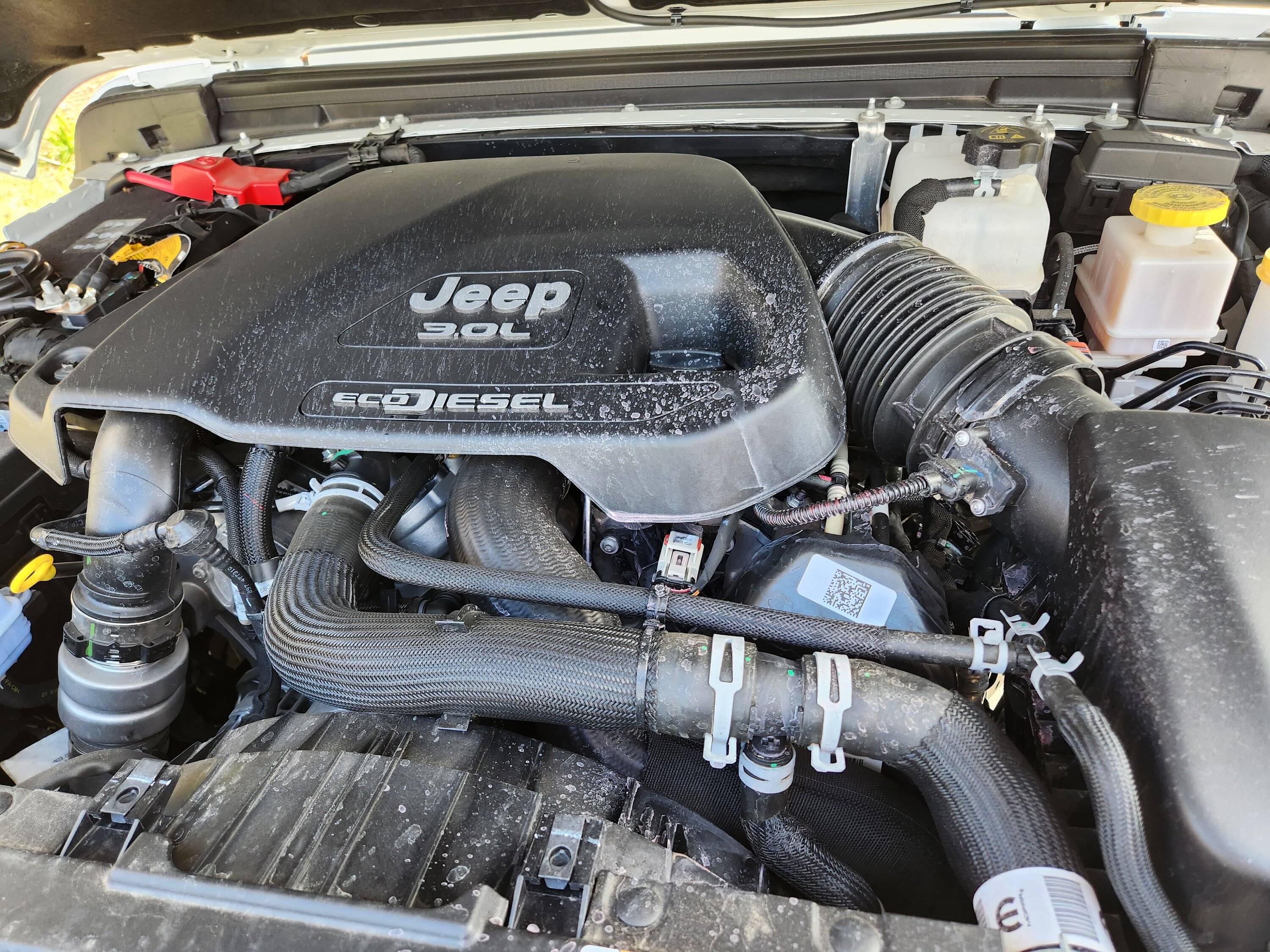

Just drove up from Denver to Montana, and i got a coolant leak/spray on top of the engine. Looks like it's coming from somewhere in the front. Not a constant thing, seems to come and go but i could tell something was going on from the smell.
Anyone else have this issue? Seems like def fluid is burning up pretty fast also.
Google shows that this engine had a recall in the ram trucks due to the EGR housing cracking or something along those lines, but i couldn't find any of this issue on the gladiator.
I have the 2022 Rubicon diesel. 7k miles and looks like the batteries are having issues as well.

I had a violent leak that stained both sides of the hood liner. Turns out it was from the overflow bottle not being tightened down properly…. I doubted it, but once tightened it stopped.

Interesting.
I checked it but it was tight. Don't see fluid on it so i don't think that's it. I also added some fluid on the way. Here's a pic

Someone had their radiator leaking at one of the end caps. Think it was next to a mounting flange.
