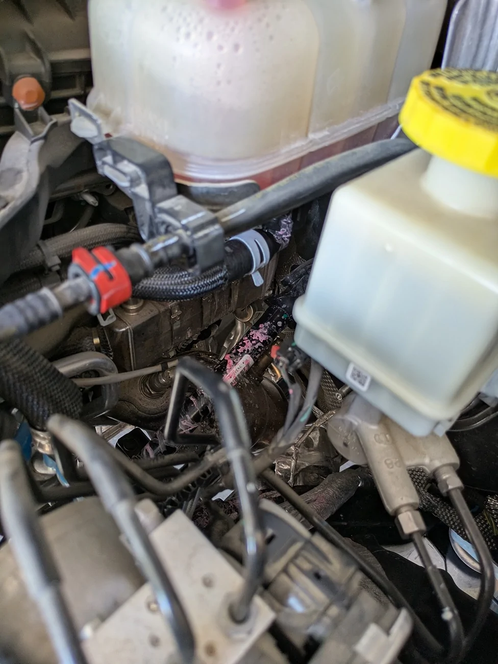

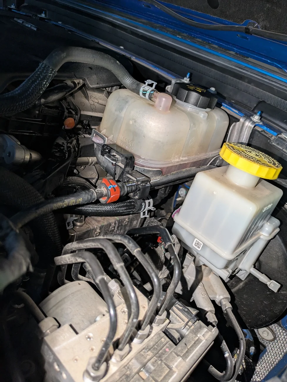

**UPDATE**
After driving for 3 weeks, have noticed the dreaded coolant leak is back. Its definitely a slow leak as I have not added any coolant to reservoir.
Jeep Gladiator Leaking Coolant Reservoir? (Always check your fluids!!) PXL_20250901_203512272
Jeep Gladiator Leaking Coolant Reservoir? (Always check your fluids!!) PXL_20250901_203521456
Looks like I will be joining the club of buying the entire hose assembly to replace the doinky plastic fitting...smh.
Unless, has anyone successfully repaired the plastic fitting/fitted new O-ring solving the leak?

**UPDATE**
Thank you,
T
I’ve looked all over for an exact O ring …no luck. I’m hoping someone else can and will confirm it. My O ring developed a flat spot where the leak occurred but then after taking the O ring out and setting it aside for a while, it self healed. I had since bought the new connector with the added bonus hose attached for an extra forced fee. I hope I never have to deal with it again but honestly if the spout that drops out the bottom could just be a barb style, a hose could simply be clamped on right there.

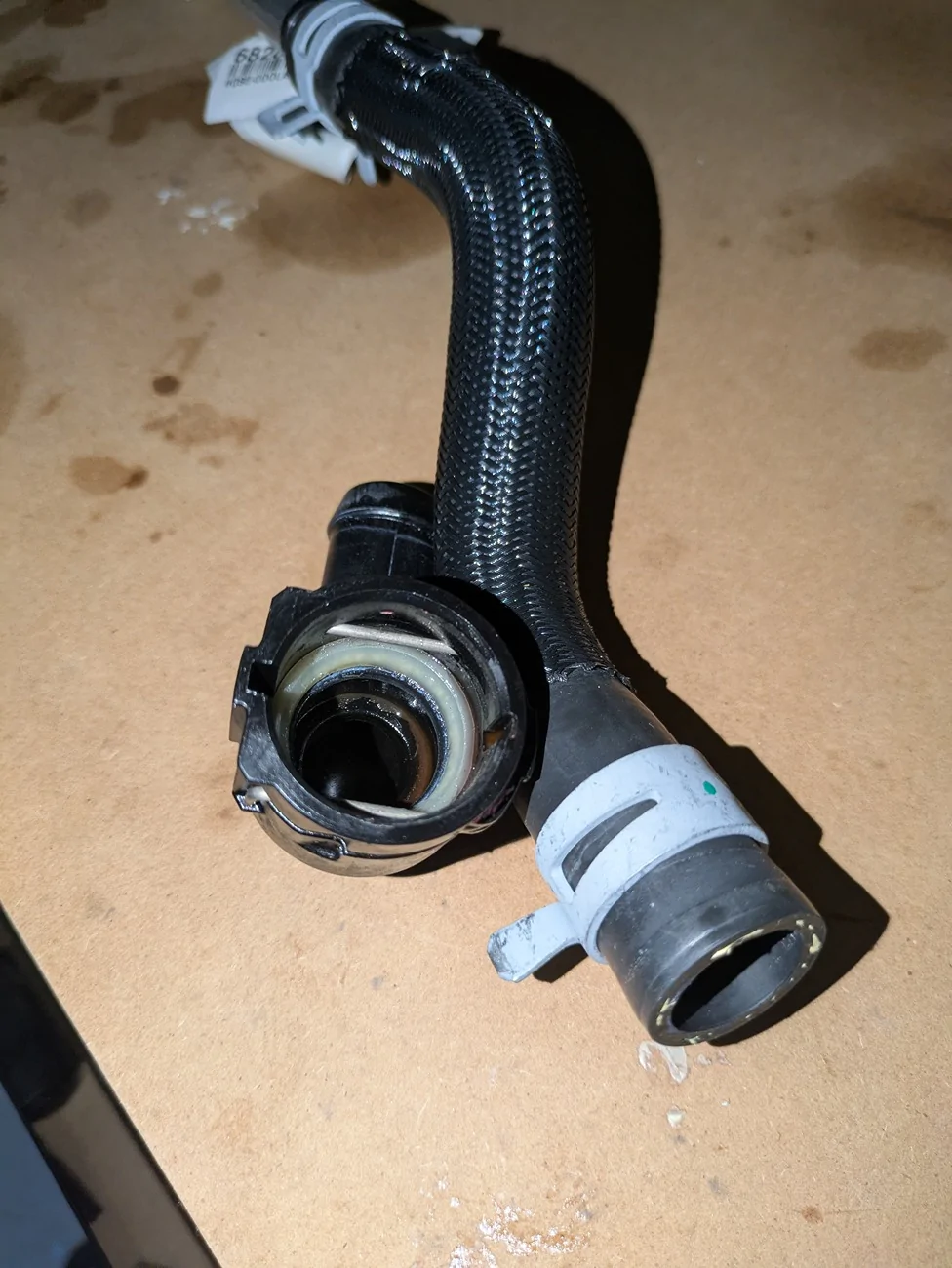

Update
Hose assembly came in. I removed the reservoir and did not see any cracks or deformations near bottle neck. Removed old plastic connector and didn't notice anything weird with it or the inner washer, but of course replaced it with the new one. Topped off coolant and ran for awhile. No leaks yet...
Jeep Gladiator Leaking Coolant Reservoir? (Always check your fluids!!) PXL_20250918_014740761
Jeep Gladiator Leaking Coolant Reservoir? (Always check your fluids!!) PXL_20250918_014709294

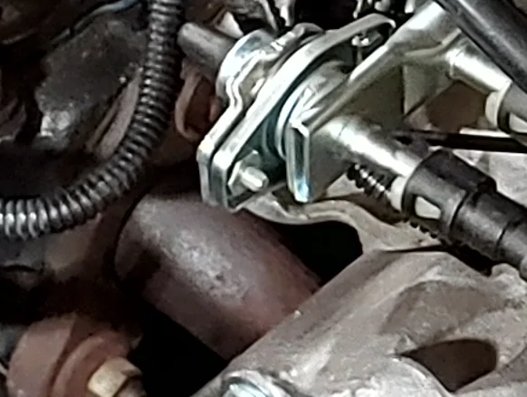

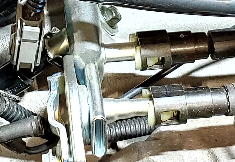

And yet those connection types have been used for decades without problem on fuel systems and other places taking some high pressures and lasting for 30 years.O-rings don't shrink unless exposed to harsh heat or chemicals.
As used in the 1990s - snap on fuel system connectors with an o-ring.
I'm still using them on the same 4.0 I put in my car - it's a tried and true connection type. These came out of a 94 ZJ, I'm still using them today.

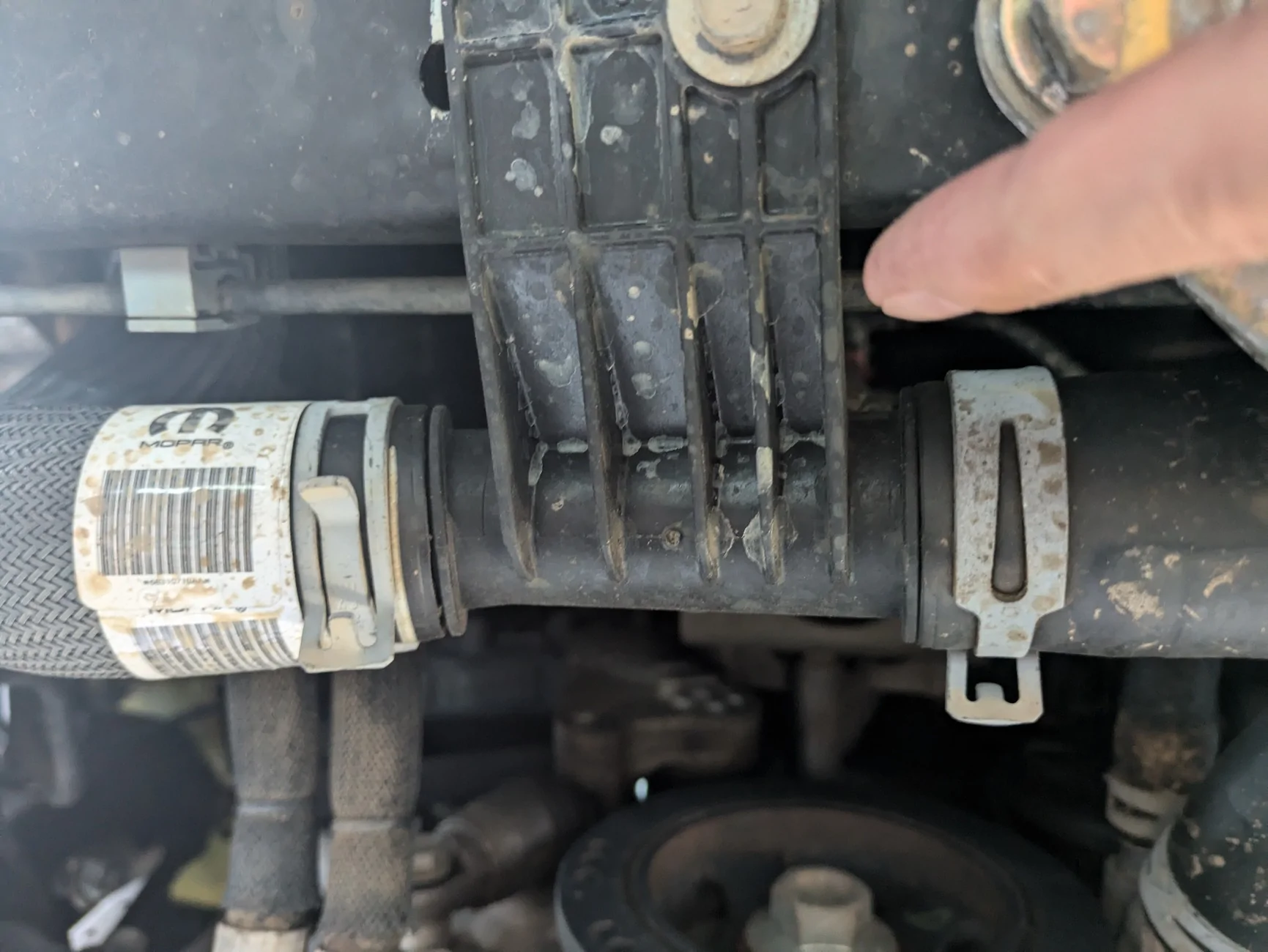

Next time I run my car, I'll take the temperature of those fittings sitting about 4" from the #1 exhaust header pipe.
Jeep Gladiator Leaking Coolant Reservoir? (Always check your fluids!!) 1758216353932-im
Time to get out my infrared thermometer and check...........
Compare temps at the JT reservoir vs. the temps at each fuel line fitting in my car.

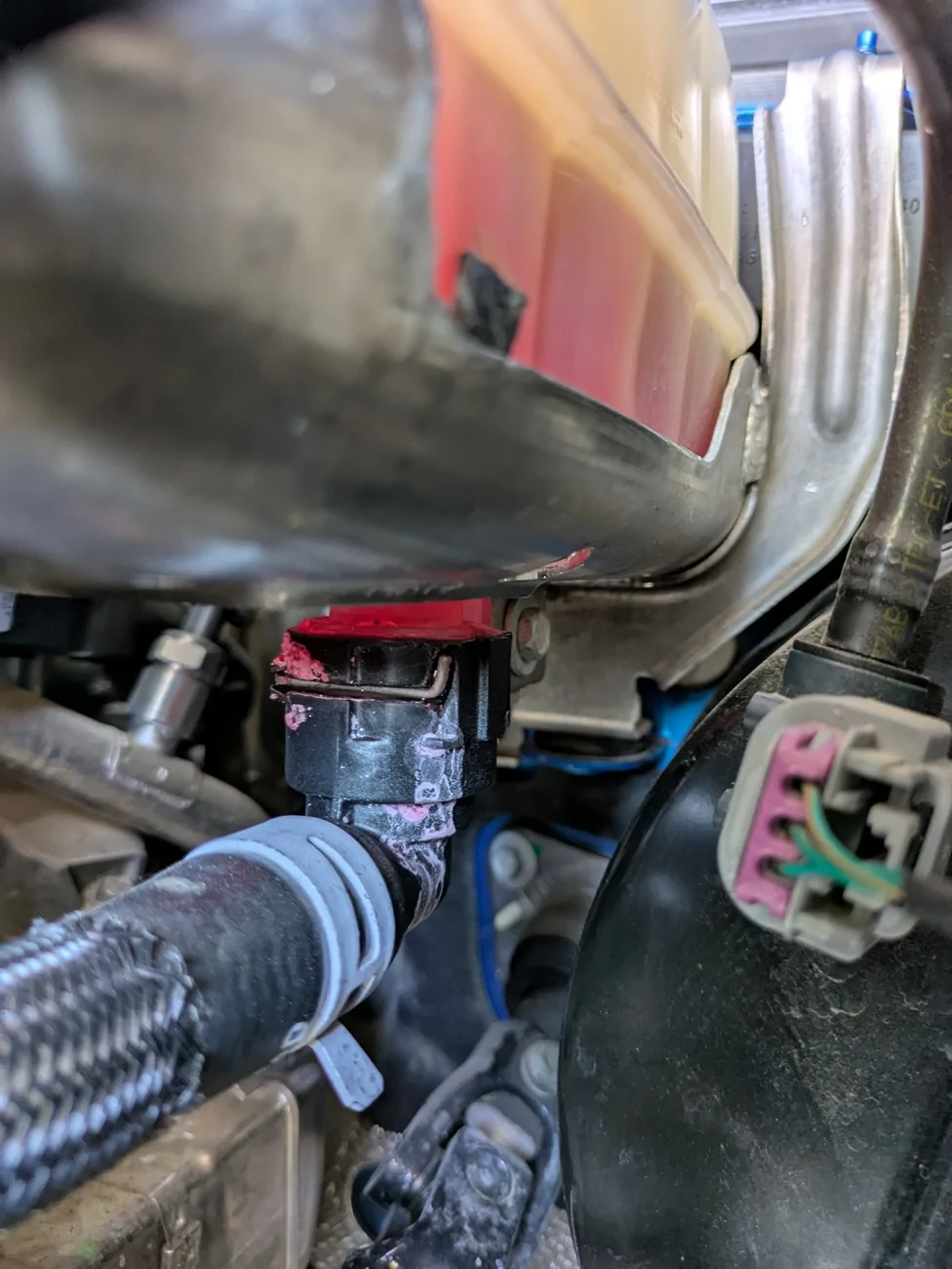

So this coolant cross over tube/connector under the radiator was my leaking issue. The replaced both hoses and the plastic mounted cross over under warranty back in February
Did they replaced both hoses because the splice barb isn't offered as a separate part?
There's actually three hoses. And they should have replaced all three.
Replacing both hoses was the smart thing to do as they both connect to that connector. And hopefully the dealer was smart enough to replace all three hoses.
It's cool free under warranty, but on my dime, i won't be replacing those hoses if only the plastic coupler was broken.
It's not an expensive replacement. All three hoses with the connectors was only $150 at the dealer. $150 and a gallon of antifreeze is smart preventative maintenance.
I replaced my hoses last year (177k miles). I had what I thought was a small leak at the connector. When I went to remove the hoses, one of the connectors pretty much crumbled in my hands. The connector had deteriorated. Once I removed everything I noticed one of the hoses was looking a little bad, so I decided to replace all three. The heat breaks down rubber and plastic and even if there's no visible damage to one of the hoses, there may be internal damage. And for $150, it was a smart move.
But, I understand. Everyone isn't like me. Gotta do what you gotta do.✌🏾
