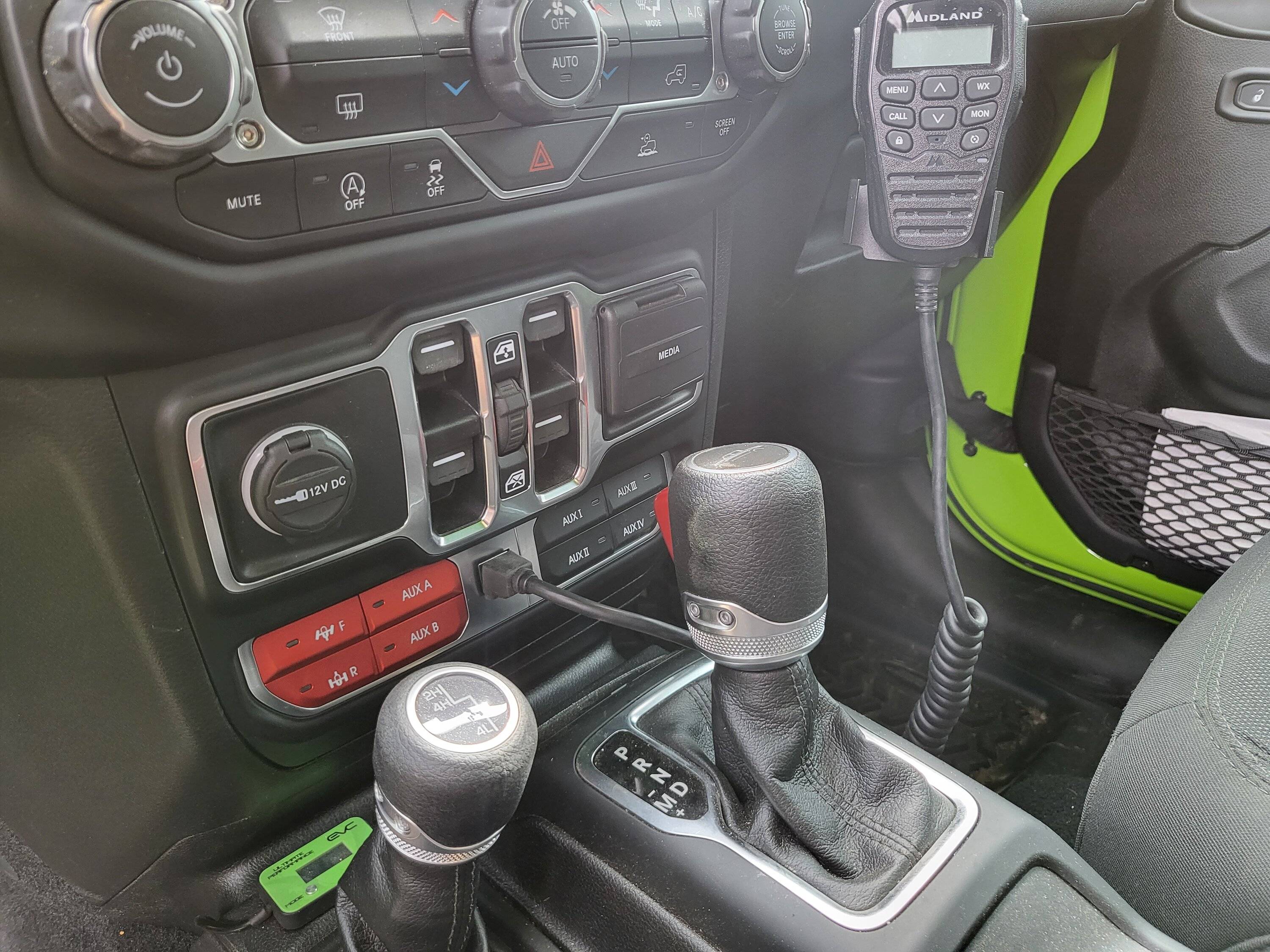

I plan on installing the locker switch from the rubicon in my dash for an oem look. I am hoping I can program the ecu to use it by way of tazer programming. I realize that I need a special cable to convert from the canbus of the jeep to a solenoid control. I believe Z auto sells that as well.

These are what I put in mine. They look and work great. Plug n play, no reprogramming needed.
LASFIT Auxiliary Switch Bank Kit, OEM Style Plug&Play Aux Switch Panel Dash 4 Buttons 4x30A for Wrangler JL 2018-2023 & Gladiator JT 2019-2023, Black https://a.co/d/iC8kuKr
LASFIT Auxiliary Switch Bank Kit, No Software Update Required OEM Style Plug&Play Front & Rear Locker Switch Aux Switch Panel Dash 4 Buttons for JL 2018-2023 & JT 2019-2023, Red, for LASFIT https://a.co/d/fWU044t

Trust me I'd prefer the lasfit route but I can't get over $500 for switches. Aren't the oem panels far cheaper? I need a tazer for programming gear ratios regardless so I don't mind that.

I'm not really sure how much the oem parts would be. I feel confident you DO have to take to the dealer to turn it on. I have a tazer and don't recall anything in there in regards to activating oem locker switches. Maybe send z auto a question about it.
