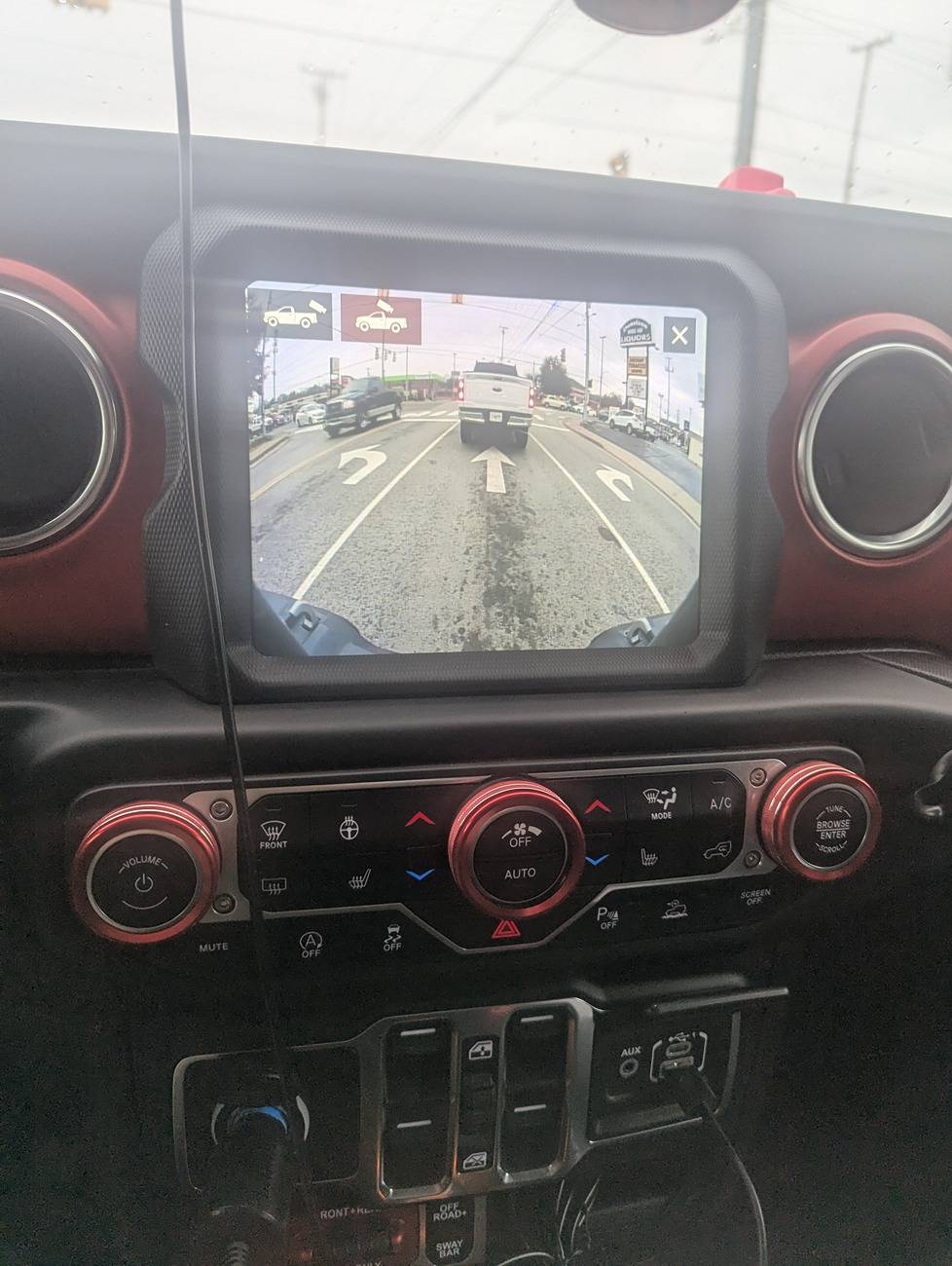

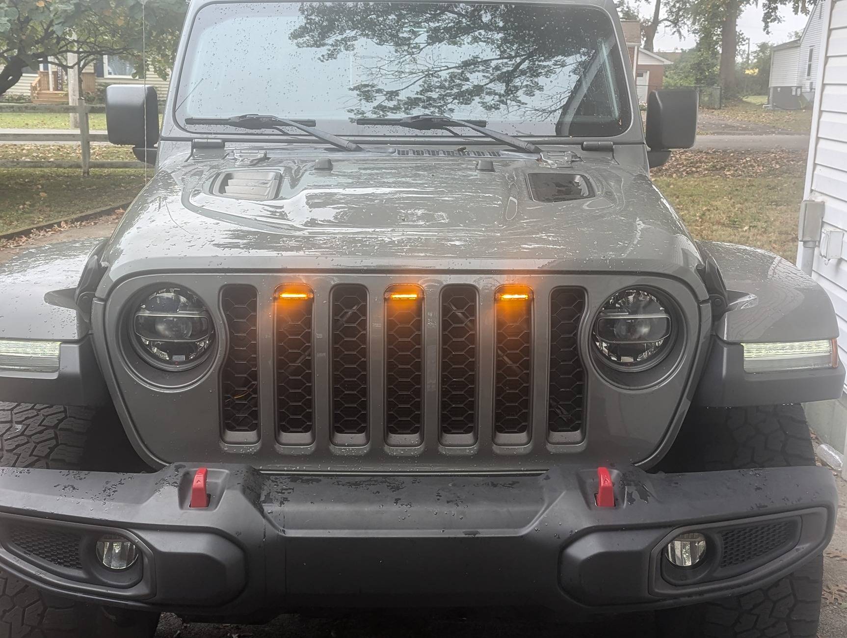

I installed a GreeYi camera (Amazon) to the front of my Gladdy. I did have to buy a RCA cord (ZAutomotive) and attach it to the radio harness. This picture was during install but I have since Adjusted the angle and removed the guide lines it has a clear picture and was only round $65 for the install.

Wow, that looks great! Do you know is it 720p or 1080? How does it compare to the rear?

Is states 720, but it is as clear as the factory backup camera.

Here is the camera in action, sorry about the glare but the resolution is pretty darn clear for a no name camera!

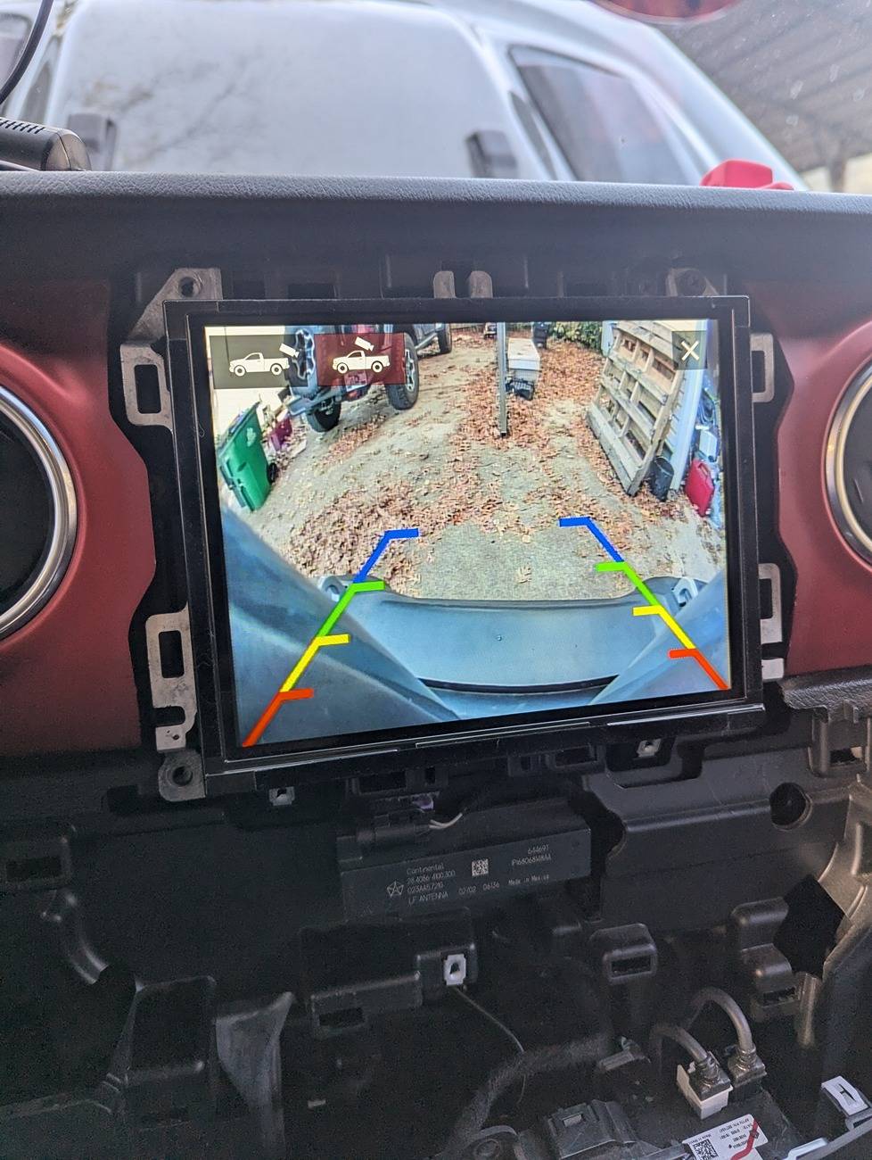

I have a 2020 gladiator overland with a backup camera. My screen doesn’t show anything but the rear camera. Is it possible to add to the existing system or would I have to add another screen for the front? It’s smarter to ask first then plan the project. All help is appreciated.
Ensure you buy the 2020 CVPM if you add the factory system. 2020s have a unique one that only works on 2020s. The other ones will not.
The factory system is really easy to add as long as you follow later advice and DO NOT install the CVPM to the factory location. Put it under the seat or in the console. Later guys figured this all out.

Wow! very good resolution. I have mine on order. I tried the Garmin solution and it's expensive and not nearly this good. Thanks!

What is the cvmp? I bought the RCA cable and connected it to the radio harness in ports 21 & 22 (yellow in 21 and black in 22) and once you activate the cargo camera you are good to go!

It's used when installing the factory trailcam.

720 can't be delivered via RCA unless 3 channel component. The camera is 720, but the signal resolved by the head unit is probably 480ish.
