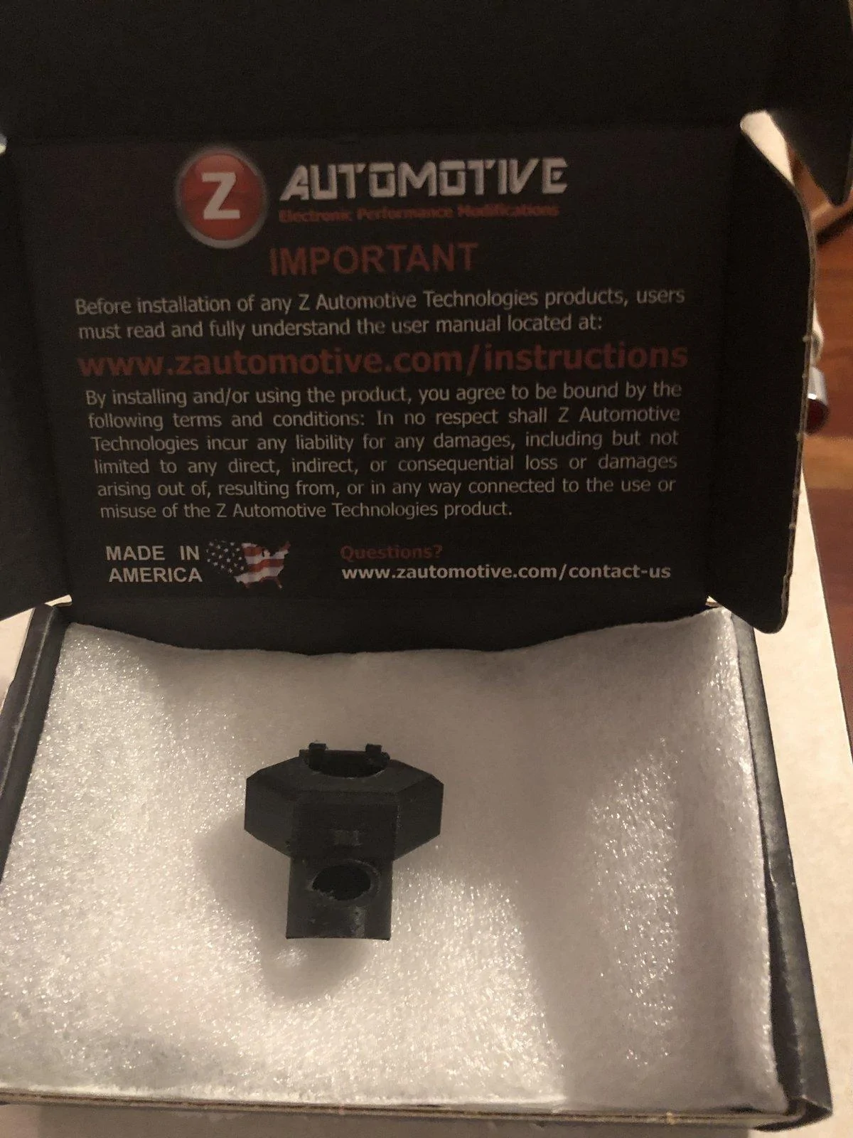

FYI the Gladiator specific Camera bracket is out. Just got it so no idea how it works. I was planning to make the JL bracket work and then I heard this we out and contacted Zautomotive. They sent it to me for free. I’ll try to get some time to install and post a YT video.

Did they really just send you a random part with no description or idea where/how it goes?

I hope they have some instructions. If not I’ll try to figure it out. The Mopar center grill section for the camera equipped JTs is $33 so not overly alarmed if I screw up the grill insert. https://www.quadratec.com/p/mopar/grille-inserts-gladiator-jt

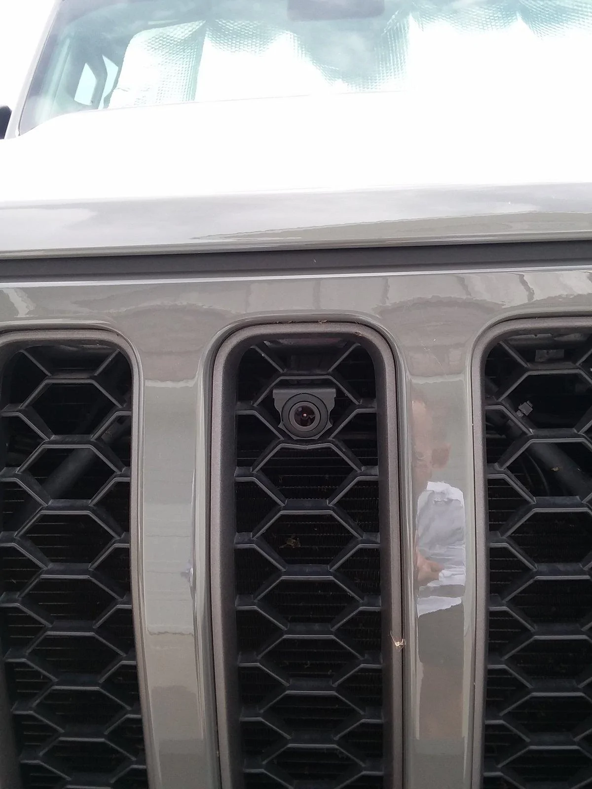

The dealer installed the camera on my JTR. It was installed in mid-Jul. Not sure if it is the JL or JT version, but it fits the JT grill perfectly. Nothing was cut on the grill, but I do notice a very slight bend in the cross piece just below the camera. I never noticed that before snapping this picture. The camera is very secure in that position.

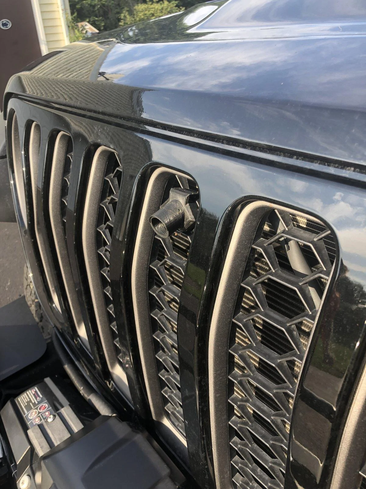

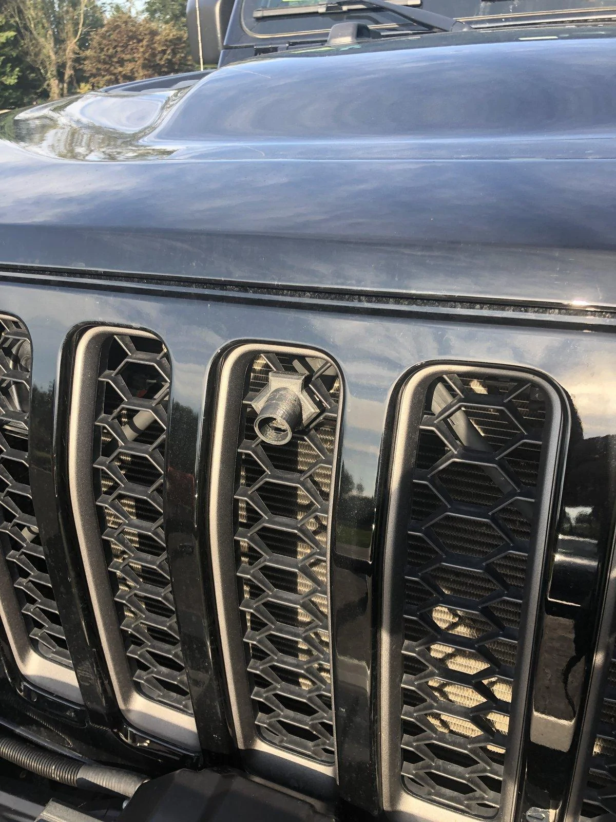

So I decided to just eyeball what this is going to take tonight and the bracket looks like it will just fit nicely with zero cutting. Sitting there loosely for a test fit. Gonna “sight it in” once all electronics touted and working. Probably don’t need additional instructions. Will try to take pics and video and post for the good of the group. Stay tuned.

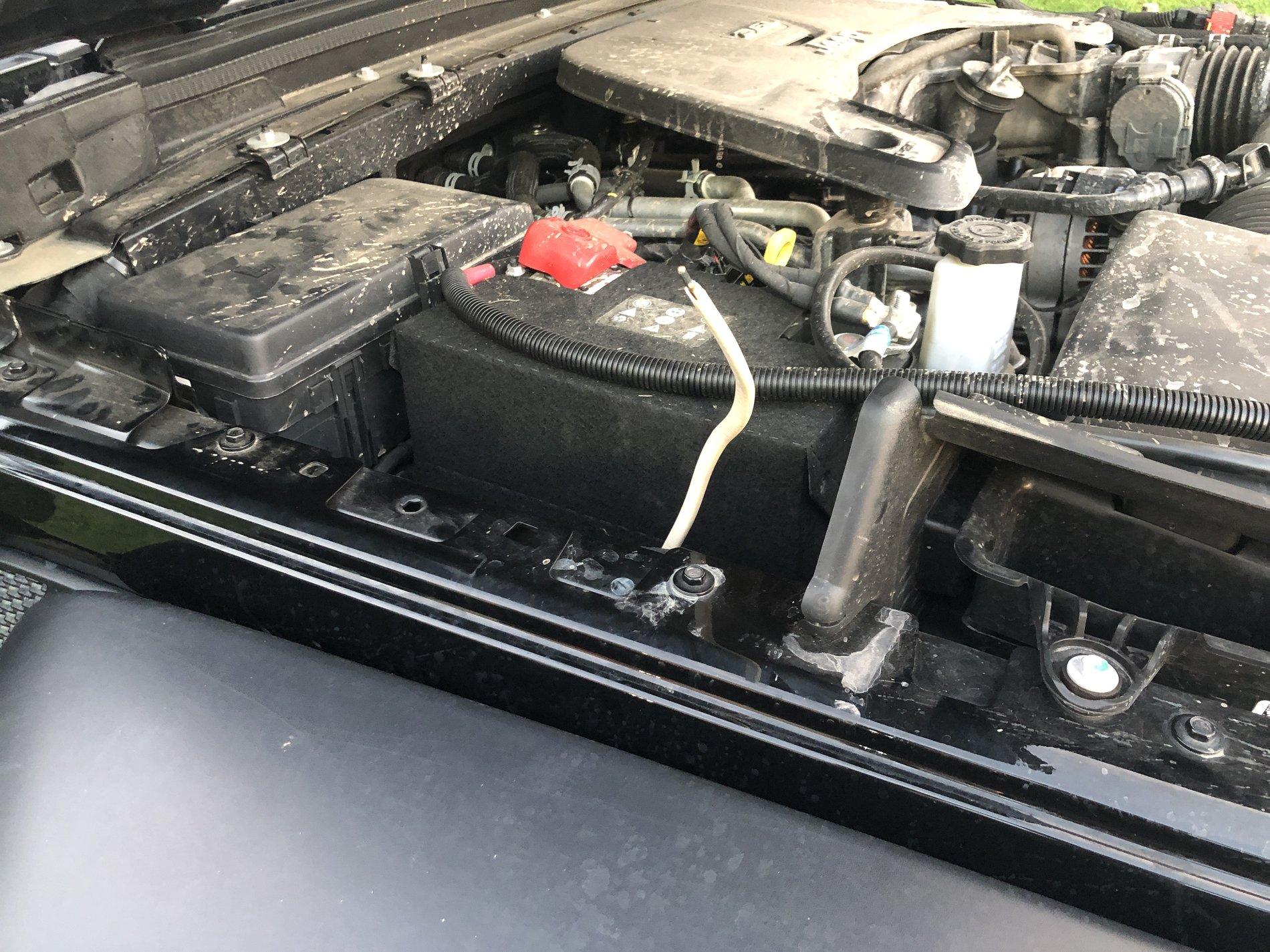

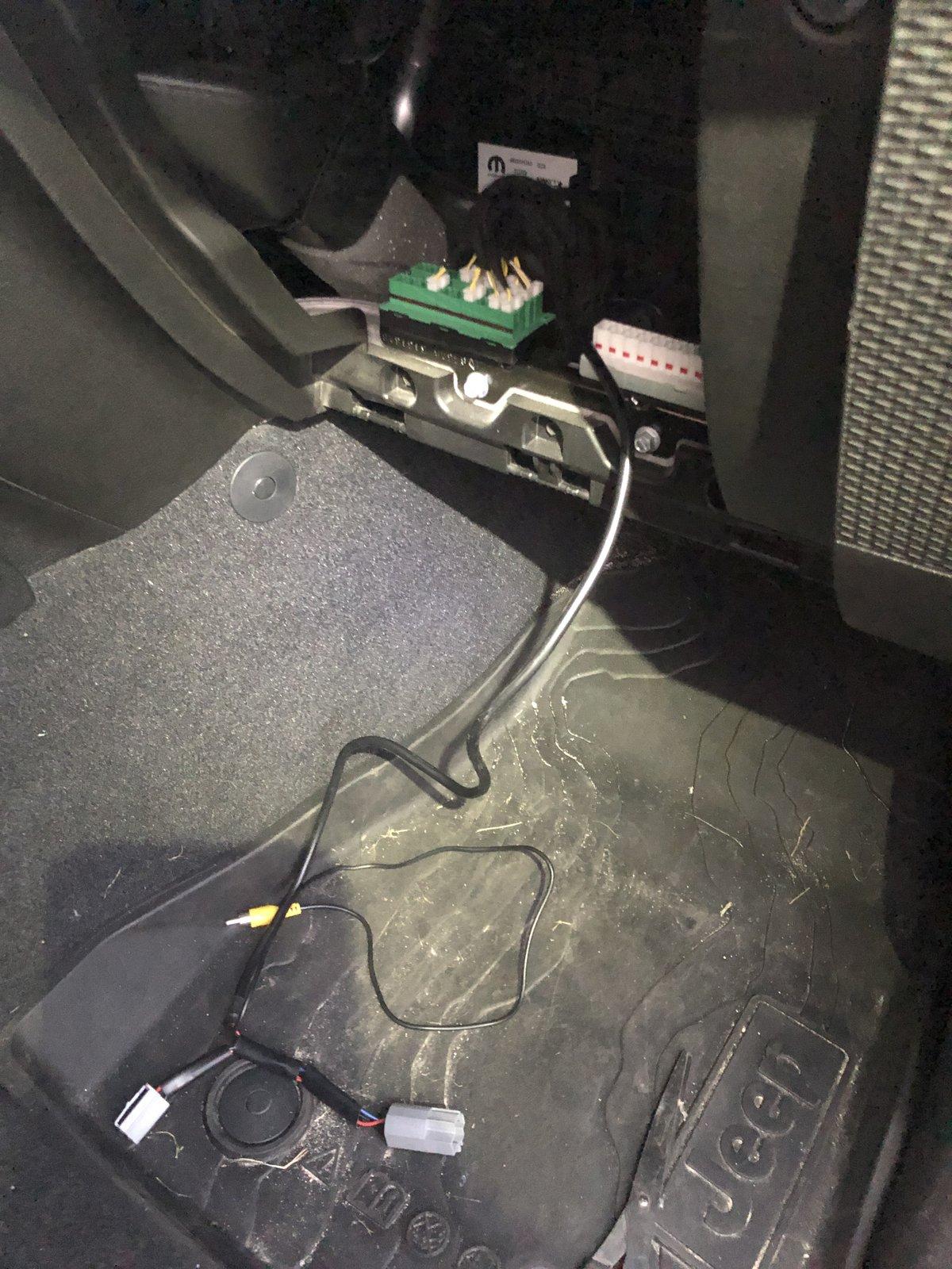

Wiring started. Going through the passenger side wiring grommet under the glovebox [edit: this is the routing for manual transmission - autos can use the clutch plug on drivers side] . After some trial and error I settled on starting from inside, cutting the grommet from inside and outside with a utility knife then used a piece of Romex with the camera wiring harness electrical taped to get the wires through. Ran out of daylight. Stay tuned.

done Video posted JT specific bracket works well

do you remember how you hooked up into the wiring harness with the rca video plug (the one with 2 wires). did you happen to pay attention which way you inserted the plug on the end of the wire into the red capped harness. it's got a small clip on one side...instructions say it clicks in...i heard or felt no click...and it didn't work....
as for where the hole is from the engine through the dash...it's in the upper left. if you remove the panel directly under the steering wheel...its very easy to access.
