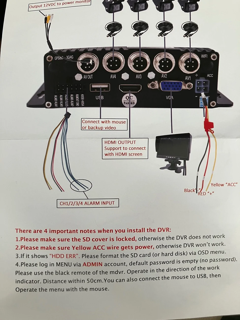

I was given a cool camera system for Christmas for my jeep.
Reading through the connection details it has 3 wires
+ve
-ve
And
Yellow “ACC”
+ve and -ve no problem
But not sure what to connect the yellow wire to
It says ignition but I have no clue what to connect it to
Can anyone help with this?
Thank you

Best way I can suggest is with an “add a fuse”. Figure out which fuse is an ACC fuse, meaning comes on with the vehicle ignition in ACC, and make the connection there. I’ll look at mine in a bit and let you know which one I connected my Wolfbox to. Out running the dogs around at the moment.

ACC is accessory on power.
