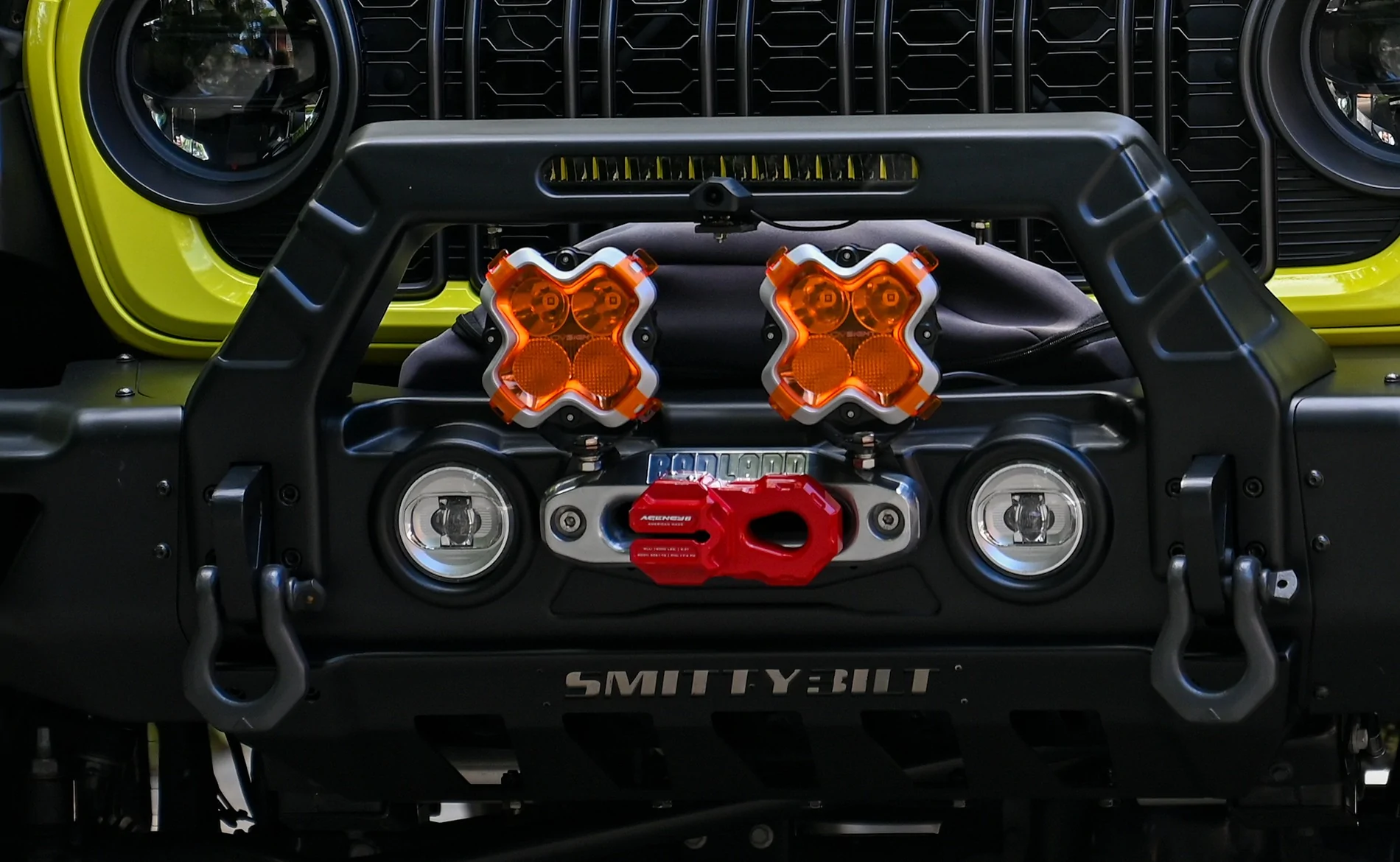

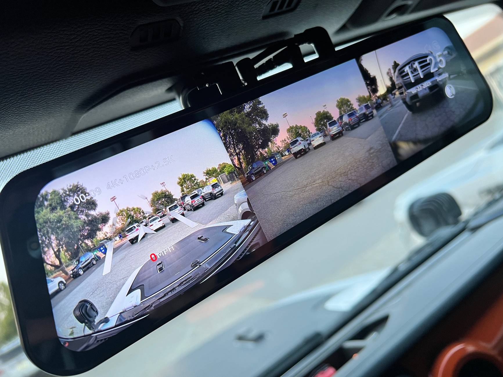

Unfortunately... there is no Plug & Play provisions for the OEM trail cam. You can try unlocking the bed cam feed in the Infotainment system and us it a forward facing cam. But the image is low rez, sometimes can be blown out in direct sunlight, and is not great in low light conditions.
WolfBox G900 TriPro Bumper Edition can stream its bumper cam to a smart phone or tablet.
And...
IT'S A DASH CAM!!! Records footage on an micro SD card.
https://wolfbox.com/products/wolfbox-g900tripro-bumper-version-3-channel-rearview-mirror
I had a spare bull bar light mount and 3M VHB it to the top.
Jeep Gladiator Install forward facing camera in overlander? IMG_0113
From left to right... Dash Cam/Bumper Cam/Rear Cam
All three feeds are stored on the SD card
And...
Is the camera powered by the vehicle? Or internal battery?
One advantage aftermarket has over factory is it can be mounted to suit the purpose and doesn't preclude certain hood lock systems.

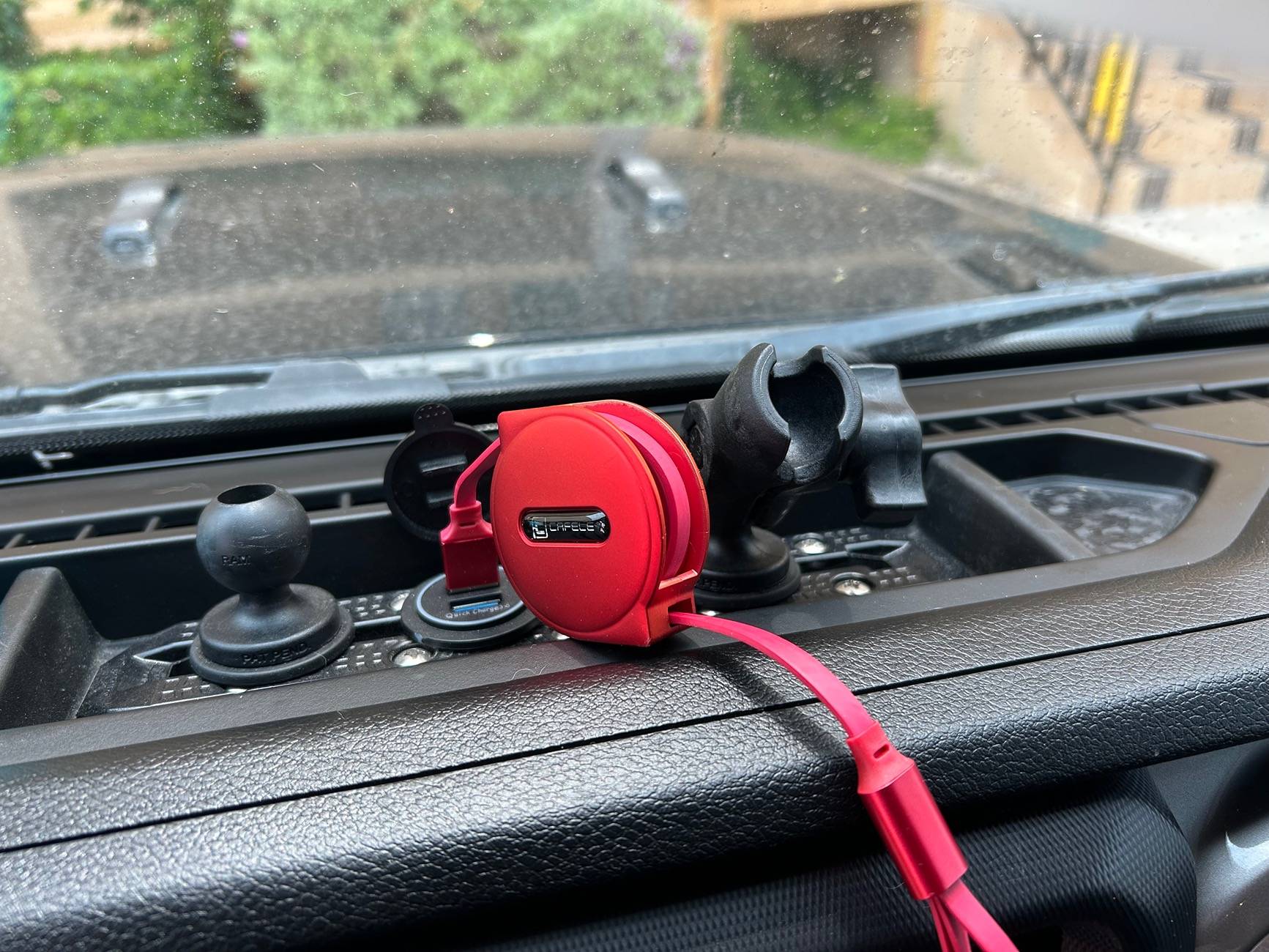

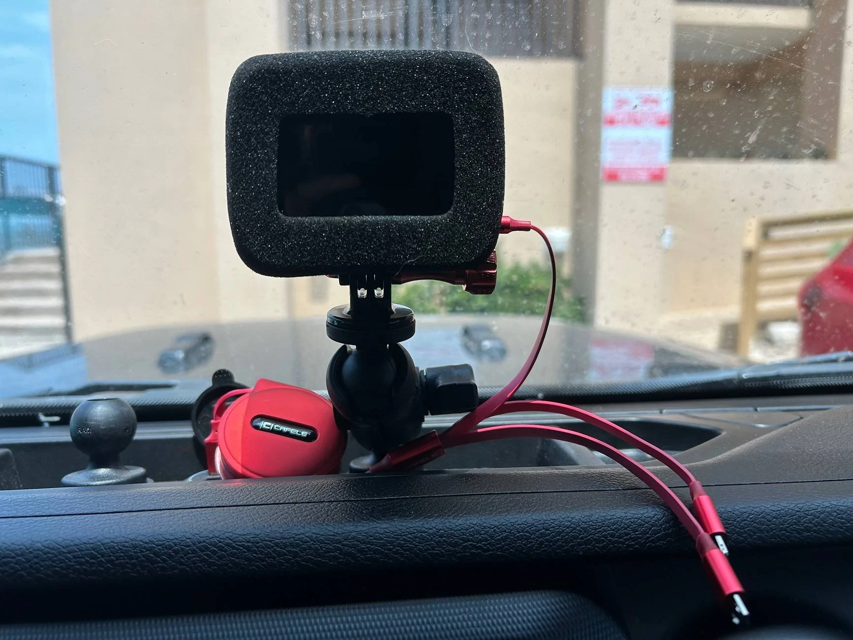

I installed a GoPro Hero 11. I use it as dash camera at times - I modified the electrical (nothing major) to sit atop of my center tray dashboard. It works perfect.
You’ll need some basic wiring knowledge. It’s not necessarily a dash cam per se, but I use it to capture everything or some video. It’s not fixed, so it can be easily detached or removed.
I drilled a 1” diameter hole on top. I bought a universal dual USB charger port and slipped that on in - tapped into my lighter (constant) using micro connectors. I used a perforated foam to protect and cover my GoPro from direct sun and heat.… and wa-la.
See attached pics. It’s another idea if this is something you‘re after.
Enjoy
Little of both, primarly the truck. You can opt for live all the time, or just when the truck is running. I set mine up for just when running, as I park for long periods of time and don't need it killing the truck recording my garage doors.
It also has a capacitor that charges up and will run some time after the power is turned off/you have an accident.

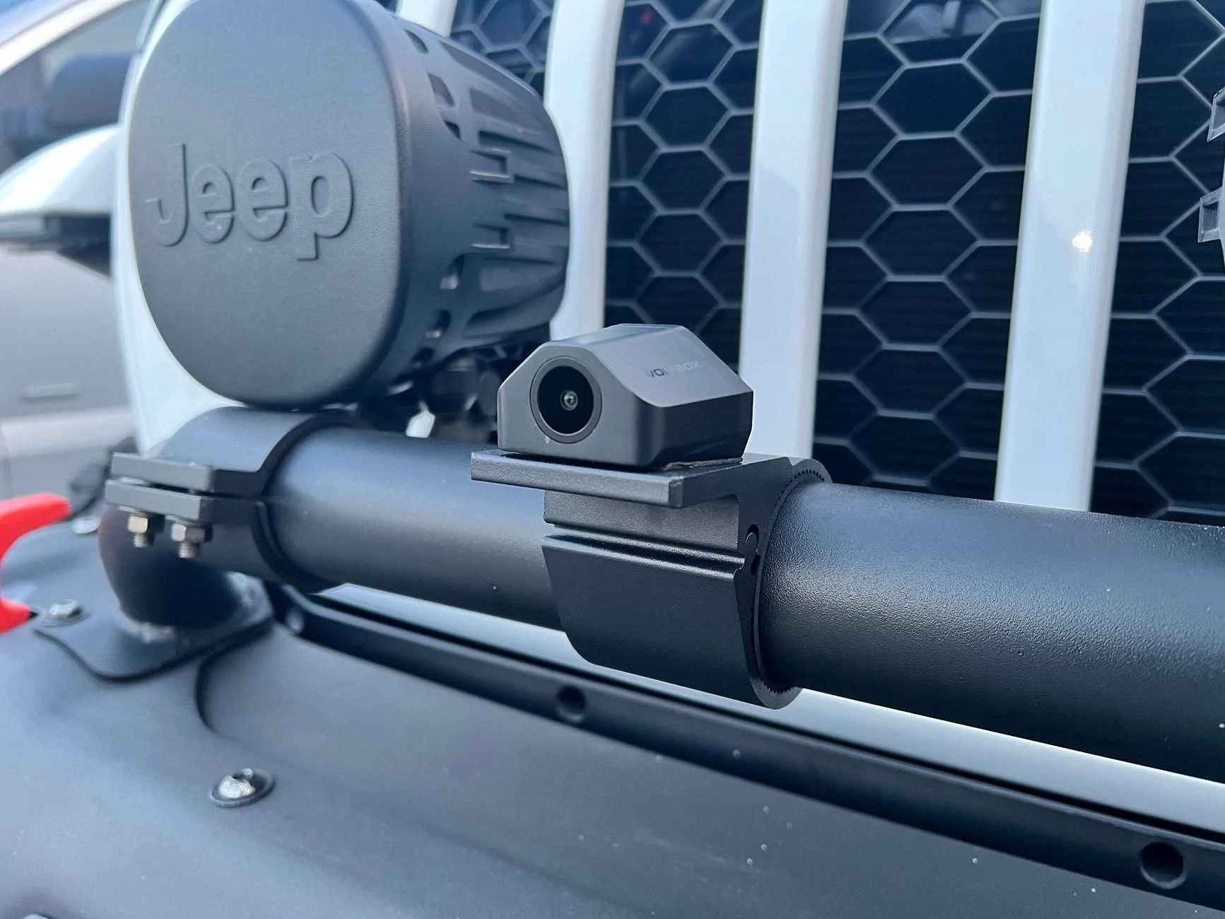

Yep! This! I have the Wolfbox 900 TriPro. It has one forward-facing camera on the back of the mirror, one forward-facing camera that mounts up front in the grill/bumper area, and one rear-facing camera that mounts in the rear. I love mine. I will attach some pictures. You can see where I mounted them.
Jeep Gladiator Install forward facing camera in overlander? DSC_1140 (1)
Jeep Gladiator Install forward facing camera in overlander? DSC_0810 (1)
I have mine powered by the main battery and can be set to record while parked.
