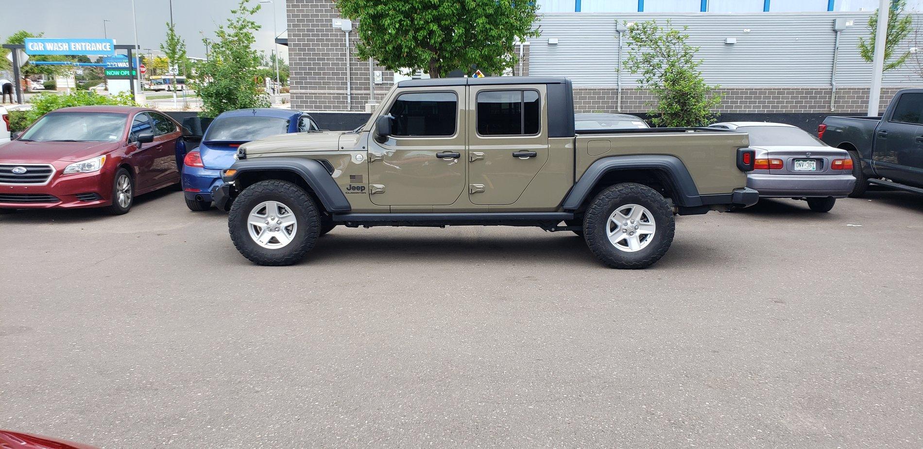

315 70 17s on a non max tow will fit 100% without rubbing on anything on stock wheels (see picture of mine). A true 35 will fit if you take the air damn off or trim as already mentioned, but if it is a 12.5 wide or wider tire and you are running stock wheels without spacers, they will rub on the lower control arms. It is the width that causes the rubbing on the control arms, not the height. Max tow vs non max tow vs overland are all the same when it comes to fender clearance and a 35 will fit on all of them.
I have true Duratrac 35x12.5 that fit my JL sport perfect with plastic insert removed and my gladiator sport as well before I even got my lifts.

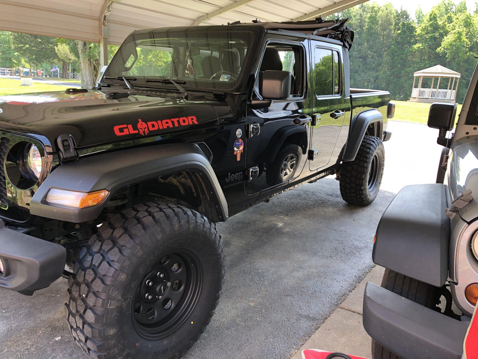

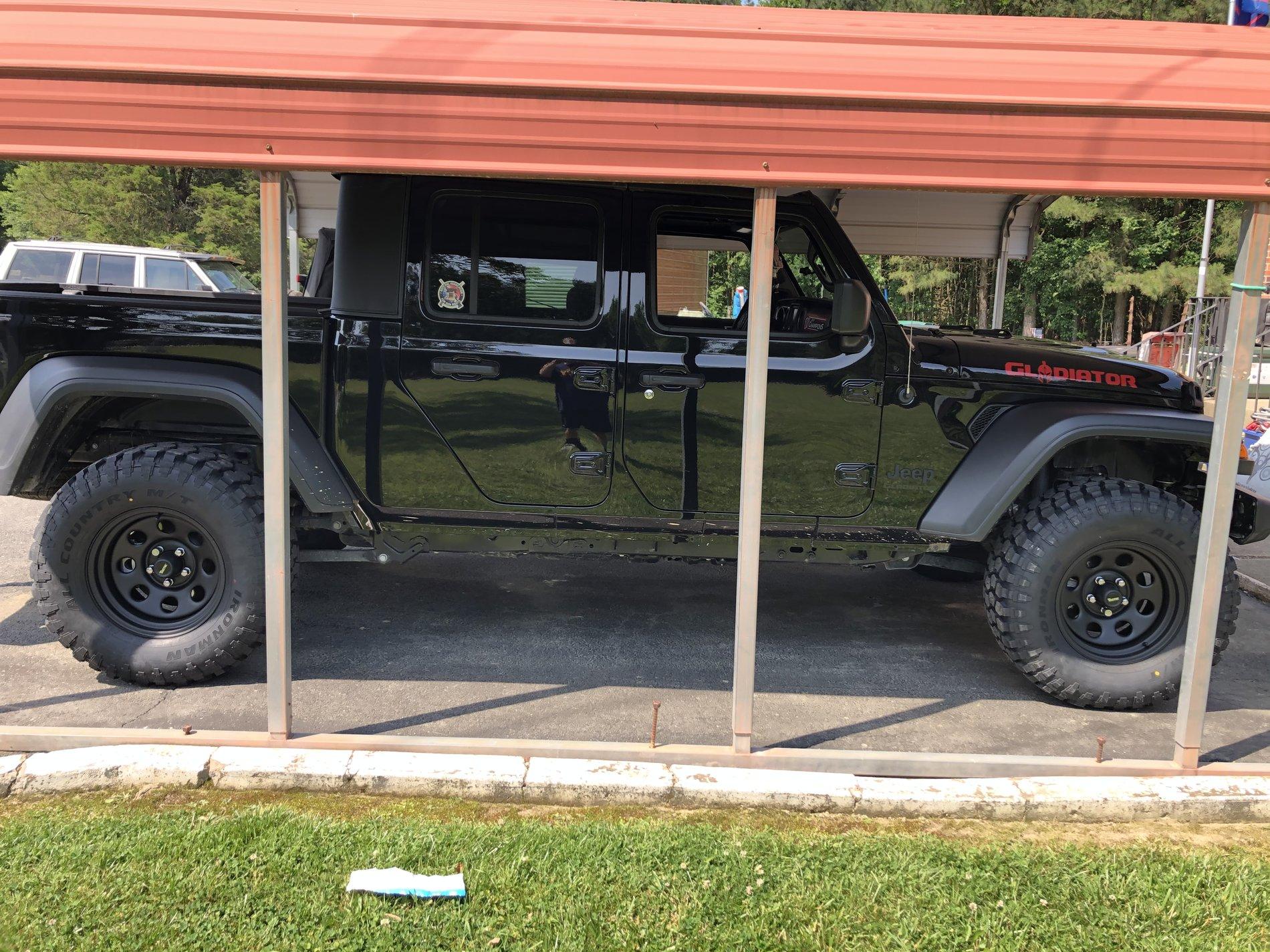

Mine is a sport no max tow I put a RC 2.5 inch lift no shocks and 1.5 inch pucks in rear and trimmed down the little air dams in front and I have ironman MT 35s on mine well 34.6 inch but considered 35s and no rubbing
OP specifically said no lift
