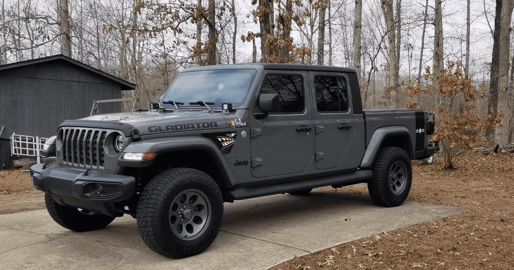

I couldn't see how 35's would fit on the stock suspension if you go offroad at all. So I went with 255-80/17 (33.1"). Would still almost hit the bottomof the fender on a creek crossing in one area I hunt, so did a Rancho Level It kit (shocks/springs instead of spacers). Love the way it rides and no more worries of burying the tire into the fender. GOing to throw a Daystar spacer in the rear as I tow a 12' trailer with a side by side on it and it gets a little reverse rake going.
what wheels are you running? I love the simple oval holes.
