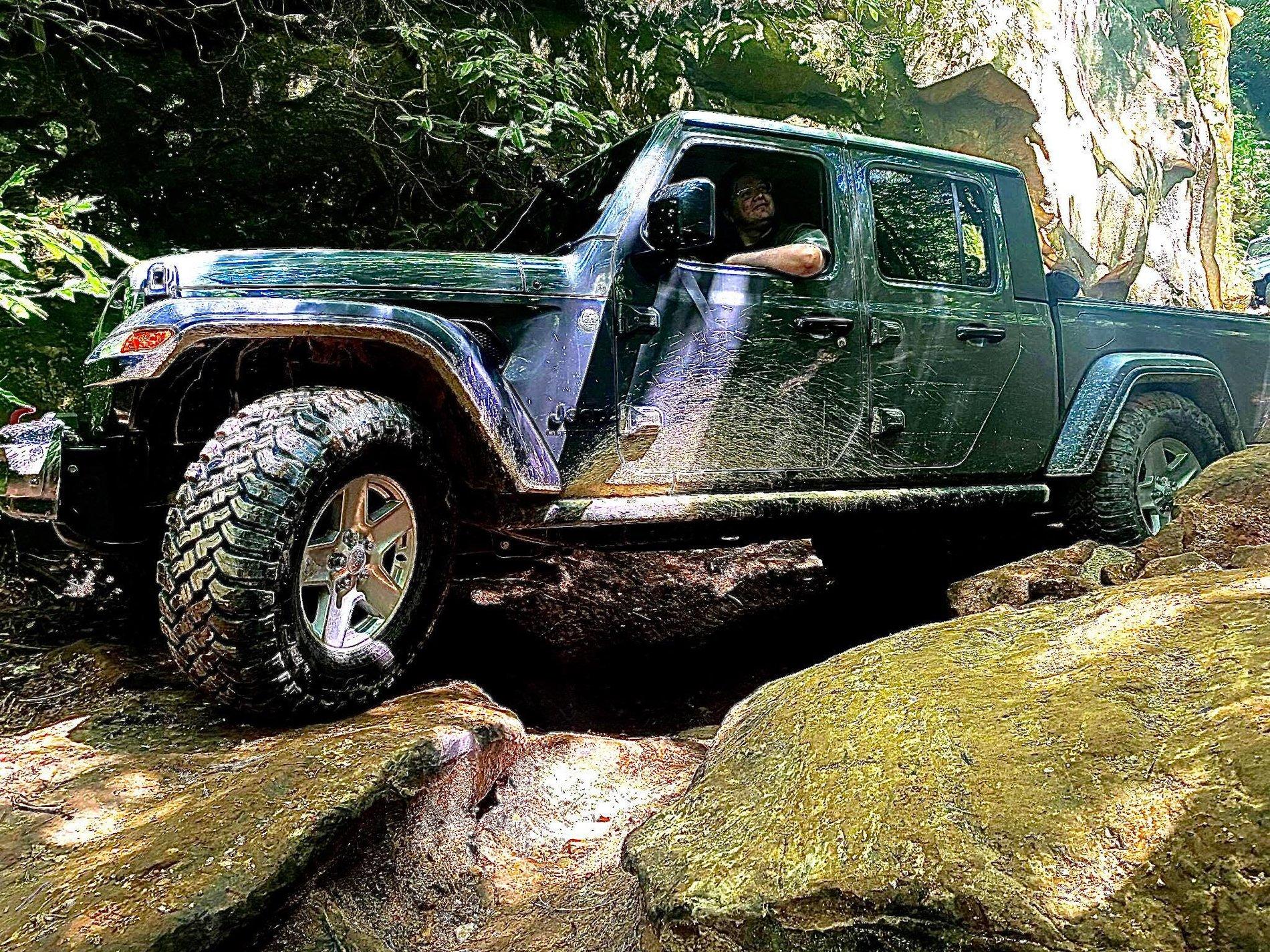

More wheeling on the stock suspension, no lifts, no leveling kit, no wheel spacers. The only time I heard rubbing was when I was nose up and my rear wheels were struggling to get over a large rock.
Btw, these Falkens got pinched really bad, I mean at 20psi they were squished down and against the rock on the driver side rear, no tears, no signs of wear. Outstanding.
Jeep Gladiator Another 35s on Stock Sport - now with video of offroading! 101826692_1540565019444923_6745016786591166006_n
Perspective on rock height. I don't know how high off the ground my rock sliders are, but my pumpkins are 11" from a level surface on pavement.

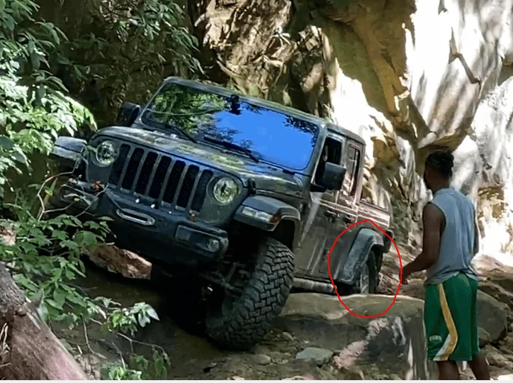

Driver tire slid off the rock and landed with a good thump on the spot between rocks. This is where the JT snagged a bit and the rear tires rubbed the fenders, as circled in red.

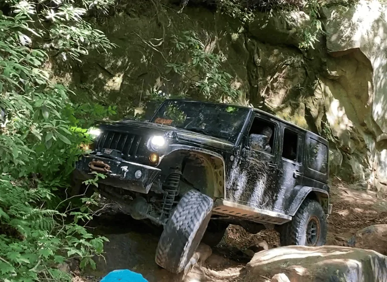

Not hitting the fender flares going down :rock:

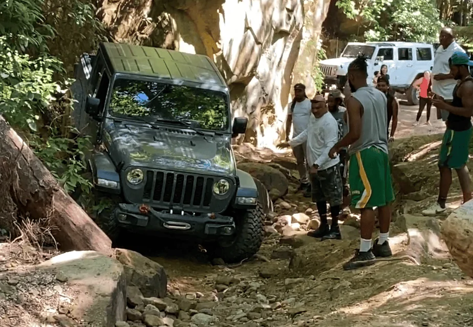

My friend on 37s and a 4.5" lift did pretty well.

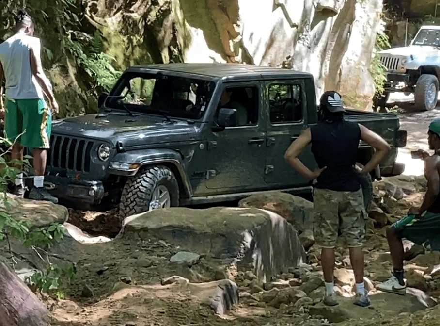

But I swear I thought his axle would snap. Learned later it's a Dana 44. His electronic sway bar disconnect wasn't working otherwise there'd be more flex

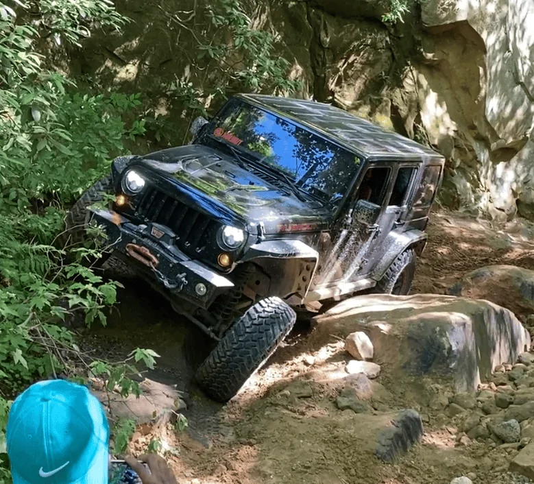

ETA: reviewing the vids, my JT did as good as the lifted JKUs. Honestly the veteran who drove Humvees during enlistment did the best with the Sahara on 4" RC lift and 35 nittos. Then comes the JKUR on 37s and 4.5" lift. Mine DID do the worst in terms of taking the longest, but that was due to the learning curve of figuring out which rocks to put where. All the other Jeeps except for the saharah needed rocks put in, slid off a boulder, and landed hard coming down. So with help, I can do all the stuff lifted Jeeps do, and thus won't be needing a lift. Higher fender flares would be a plus though
And, these guys were great. They stacked rocks, they spotted to make sure pumpkins were not hitting, they even gave a push. I am glad I got to take them out wheeling for the first time and on such a fun trail
