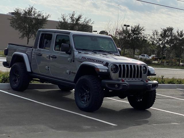

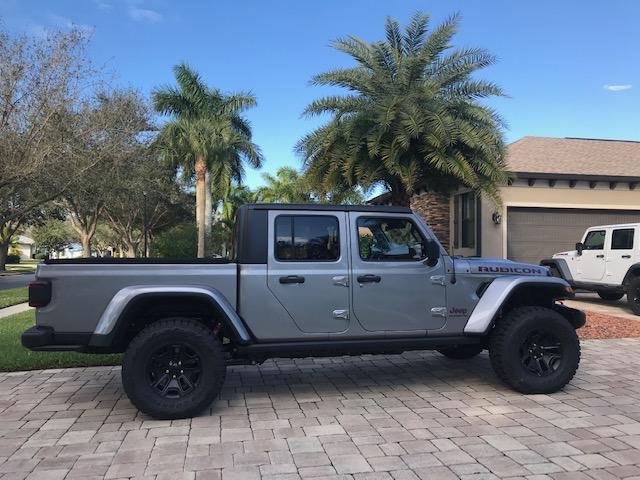

I had the Quadratec Hardrock wheels in satin black on my JT Rubicon which I recently traded. I was running 315/70/17 Toyos and the tires poked just a tad bit out from under the fenders. I was happy with the set up. I included some pics for reference. This was on the stock Rubicon suspension with the Daystar 1.5" front leveling kit and the 0.75" rear spacer.

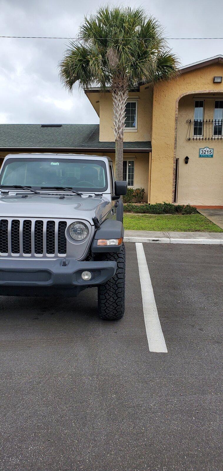

Jeep Gladiator Can some of the more experienced 20210322_141902

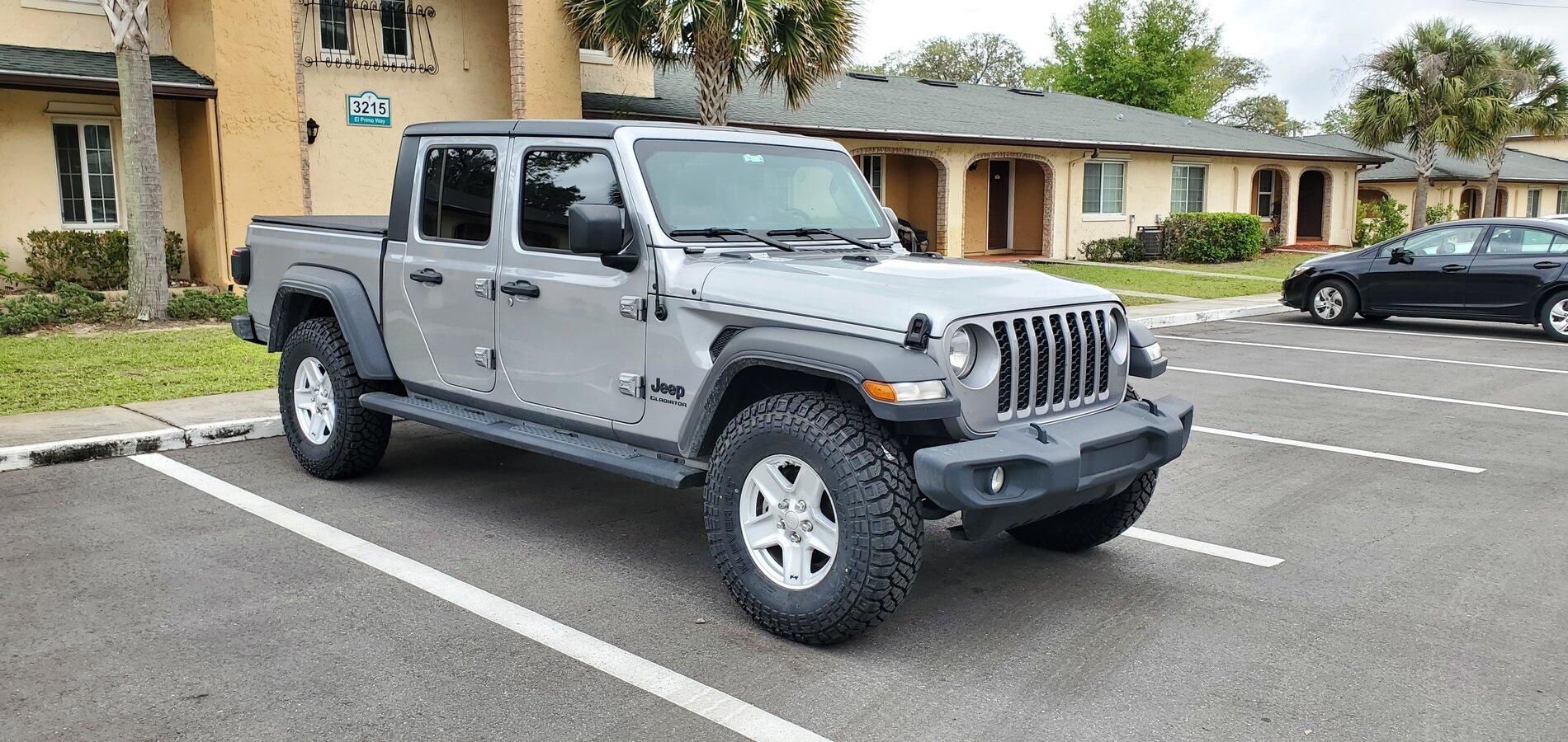

Those are the 35x10.5r17 Kenda Klevers on a sport s max tow with the wide axles, stock wheels. I too didn't want them poking past the fenders and am quite happy how it sits.
Jeep Gladiator Can some of the more experienced 20210322_142000
