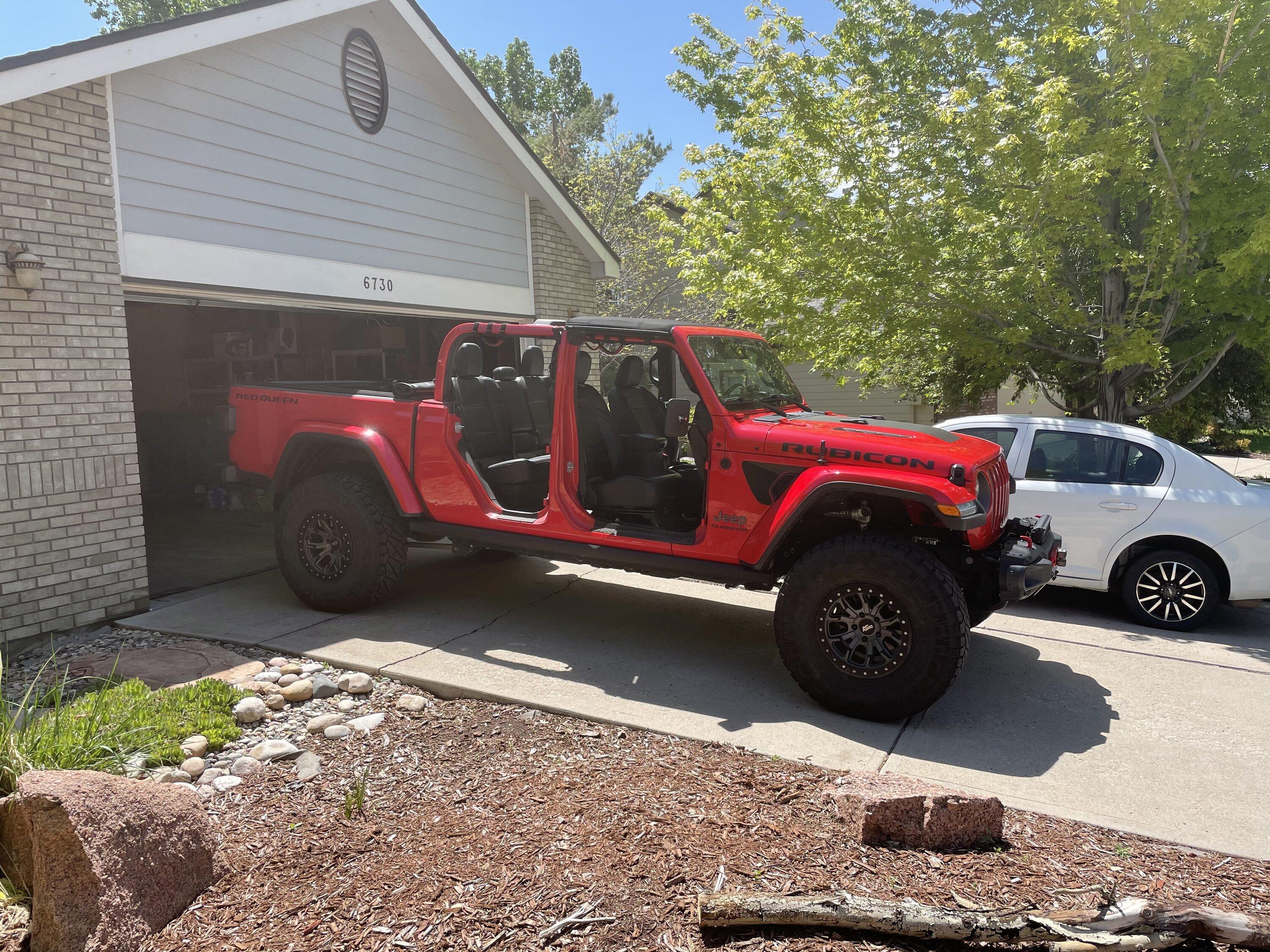

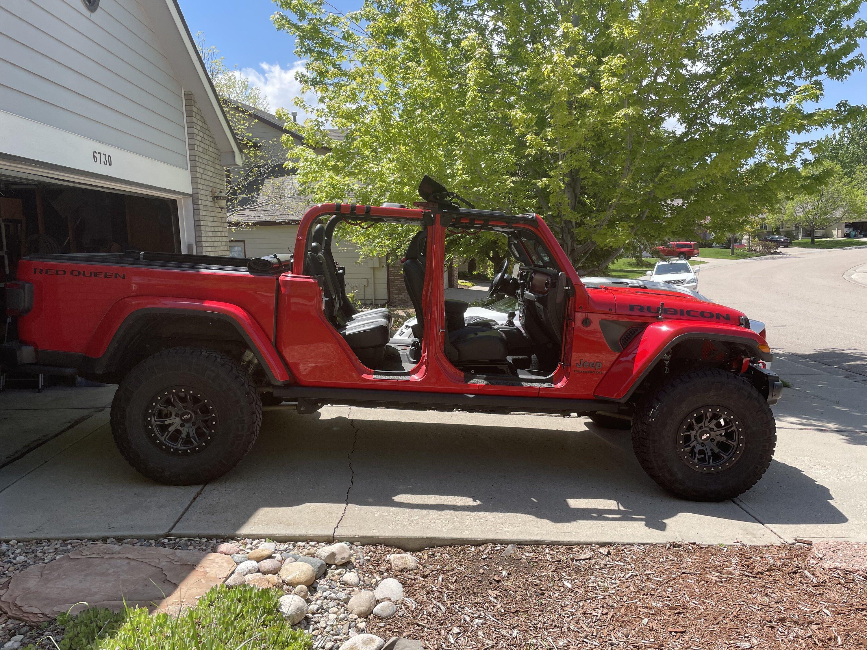

Yes you can remove the rear and reinstall the flip top. One caveat though. The back is pressed around the hard top weather seal and the c clamp that’s used to hold the sunrider down. When the rear is removed the weather strip is gone. You will have to make up for it. It’s about a 1/2 inch thick. I have done a small towel or some left over weather stripping.

Easy. 6 bolts and slide forward to clear the hard top and access the two front bolts holding the hard top. Pull the top off and slide the sunrider back into place. Reinstall the 6 bolts.
