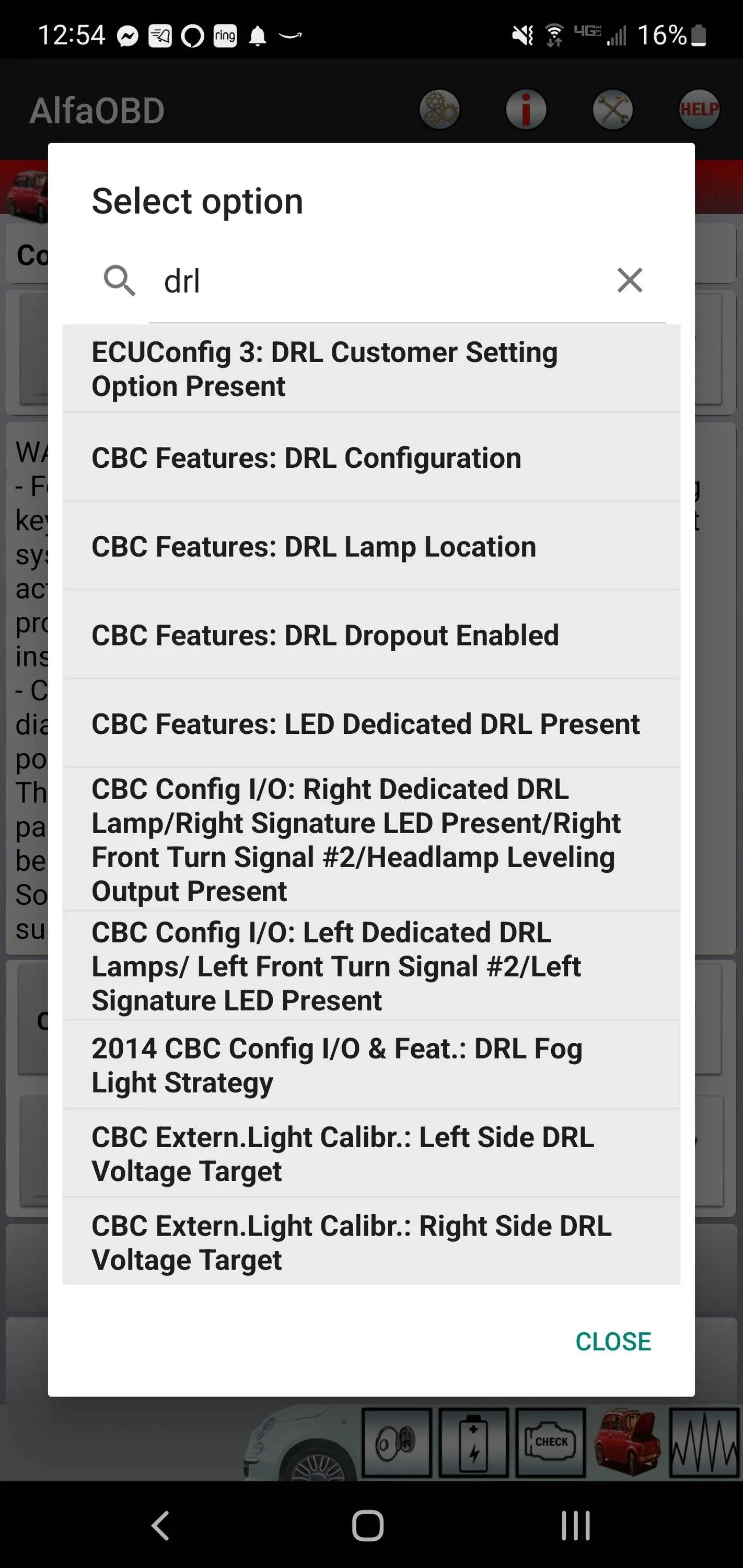

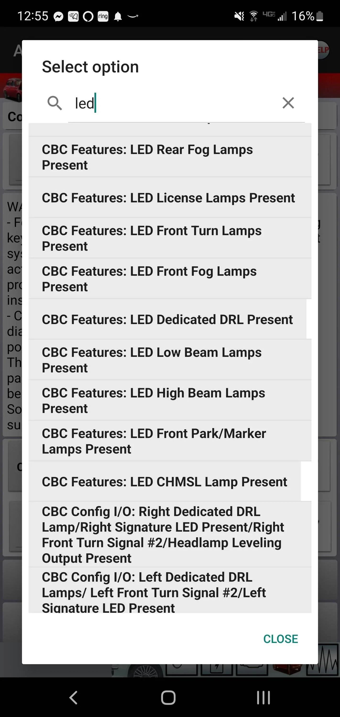

There seems to be something I'm missing....I've told the BCM about the LED front turn and park/marker lamps. Also set DRL location to dedicated and drl config as Optional.
The upper strip turns on with headlights. Turn signal works. They do NOT turn on with headlights off. Anyone know the settings I'm missing?

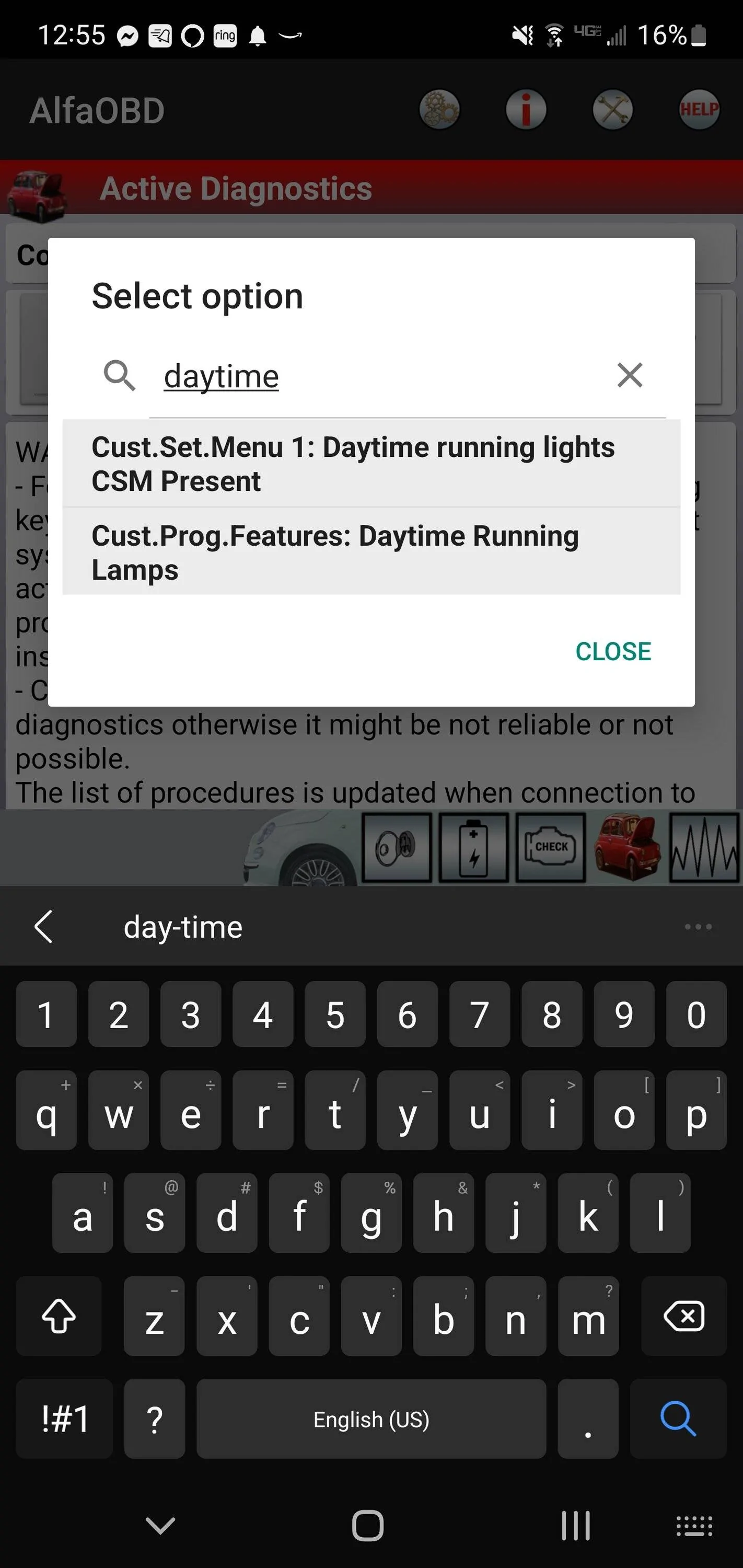

Anyone with OEM LEDs from the factory. .is this something you activate in the Uconnect....optional setting to turn on in daytime?

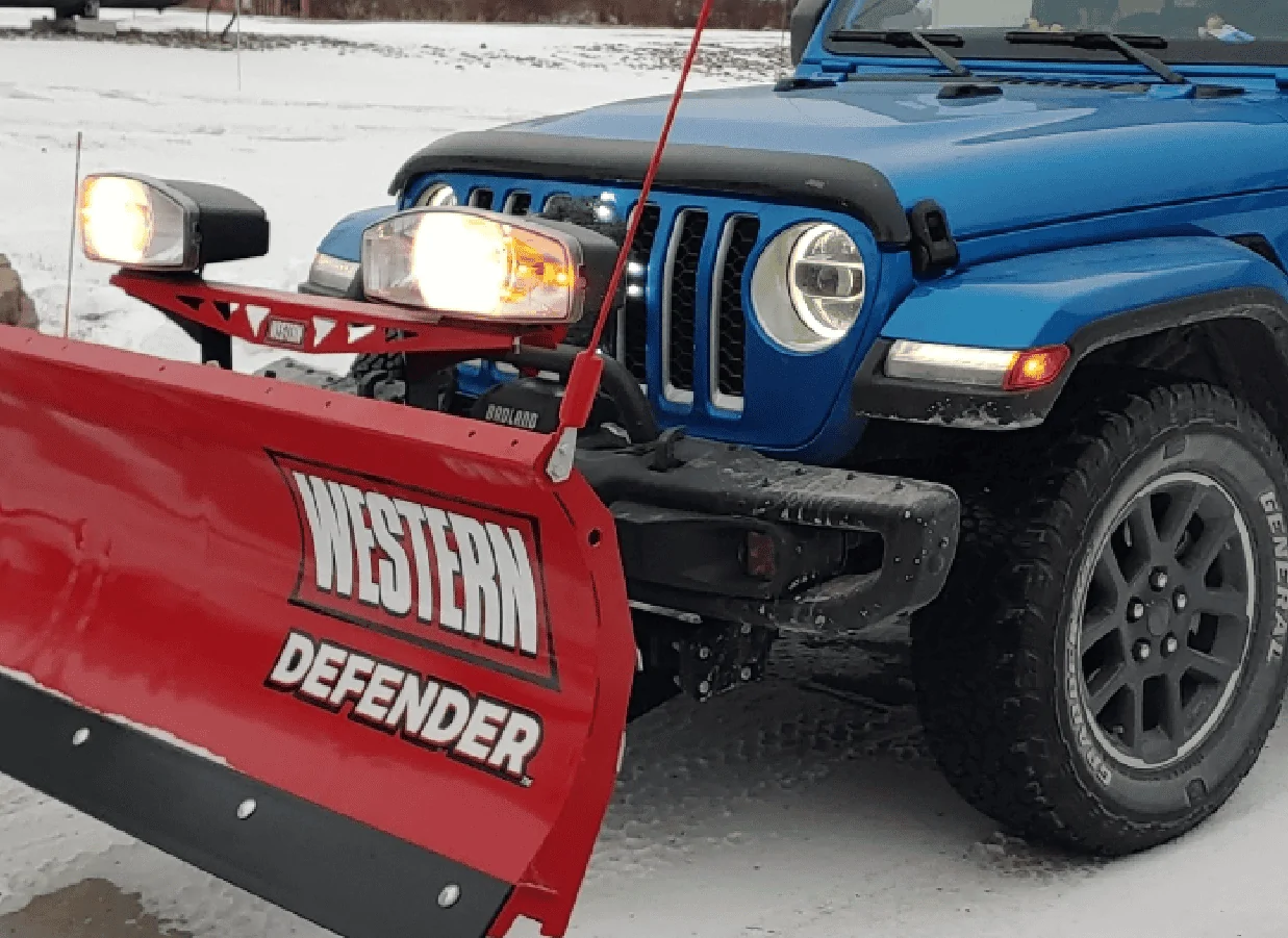

My original owner manual said that they'd come on if the transmission was in any gear other than neutral or park.
But in reality, they came on even in park.
Book said "the DRLs are active when the headlights are not on". Oh, really? (see pic below)
I was trying to check the wiring harnesses I'd made for my snow plow and was a bit confused at first -and just accepted that they changed their minds or the book was wrong. The later released read differently.
Sitting, idling in PARK, they are on (truck's headlights are taken over by the plow's electronics)
