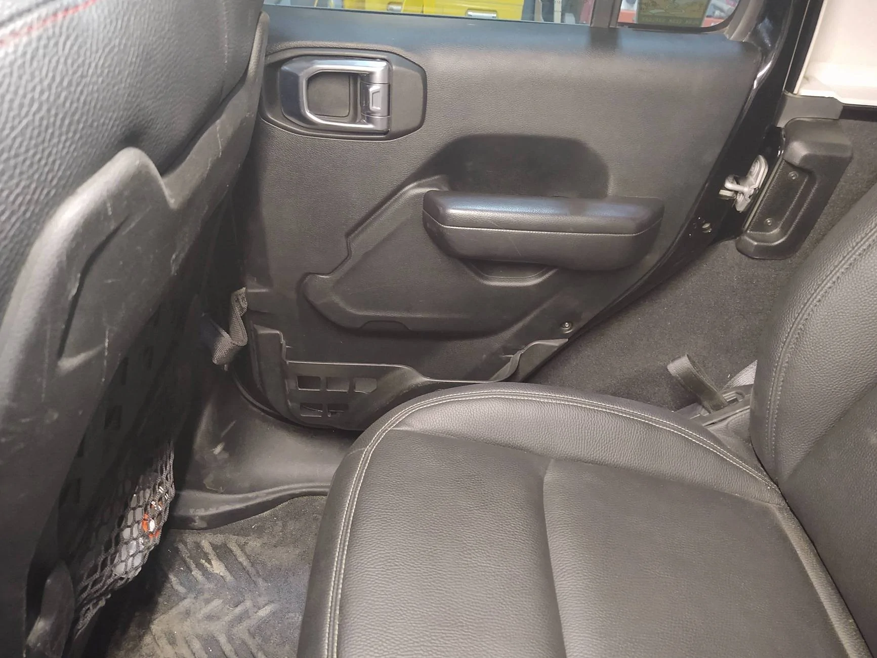

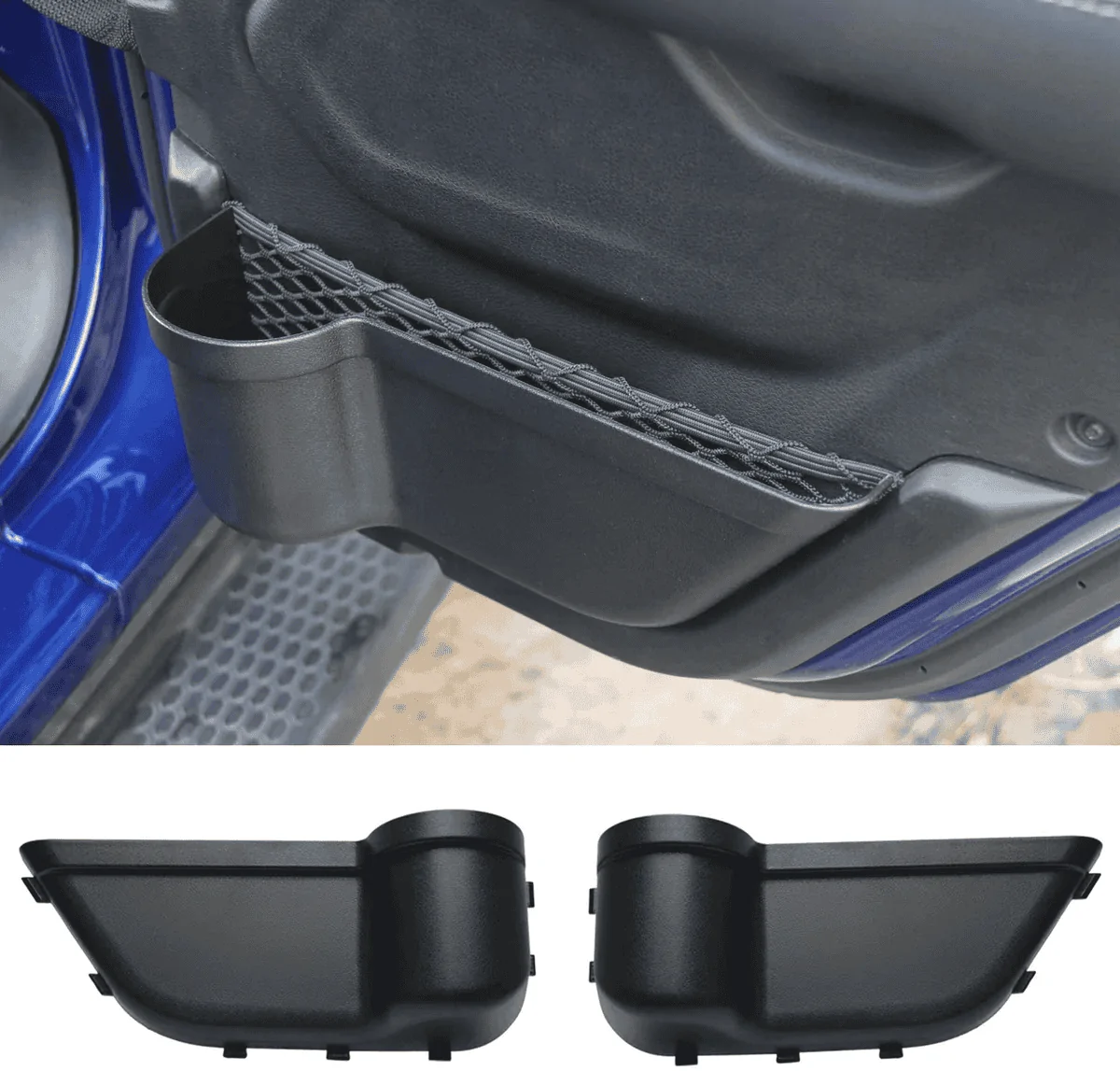

Anyone done an install on the unofficial use style yet? Really dont want to drill any holes into a 24 vehicle if I dont have to.

I have two sets out for delivery today. You don’t really have to drill holes to install them, you have to drill out the plastic welds that hold the trim piece that the nets mount to. Once installed there are no new holes visible.
Here is a Link to the installation video over on the JL Forum.

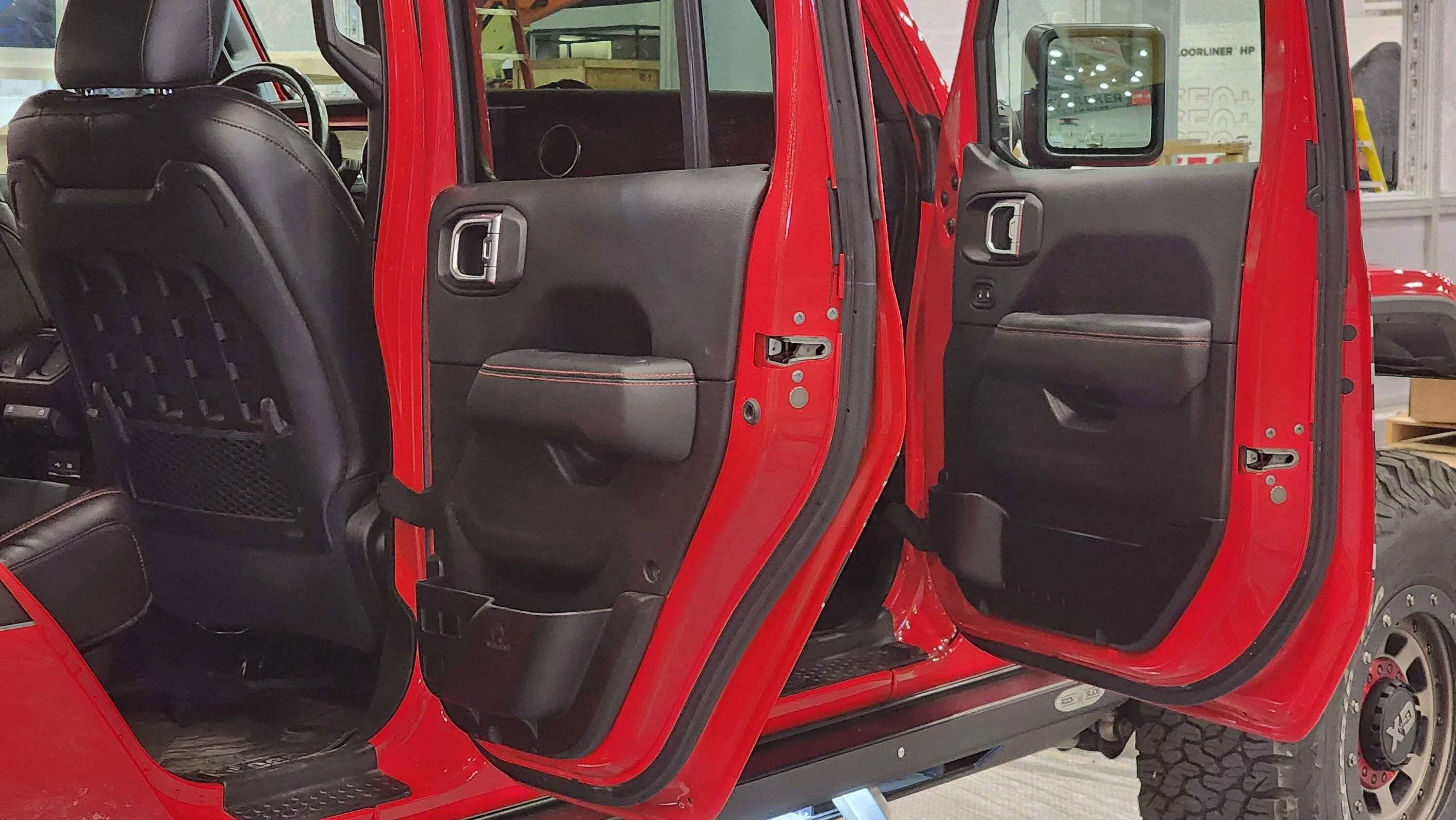

Finally installed official use only door pockets today. Each door took about 15 minutes to pull off, drill out each plastic weld, install the new pockets using hardware provided and reinstalling the door. One of the easiest installs I have ever done. Super factory looking.
