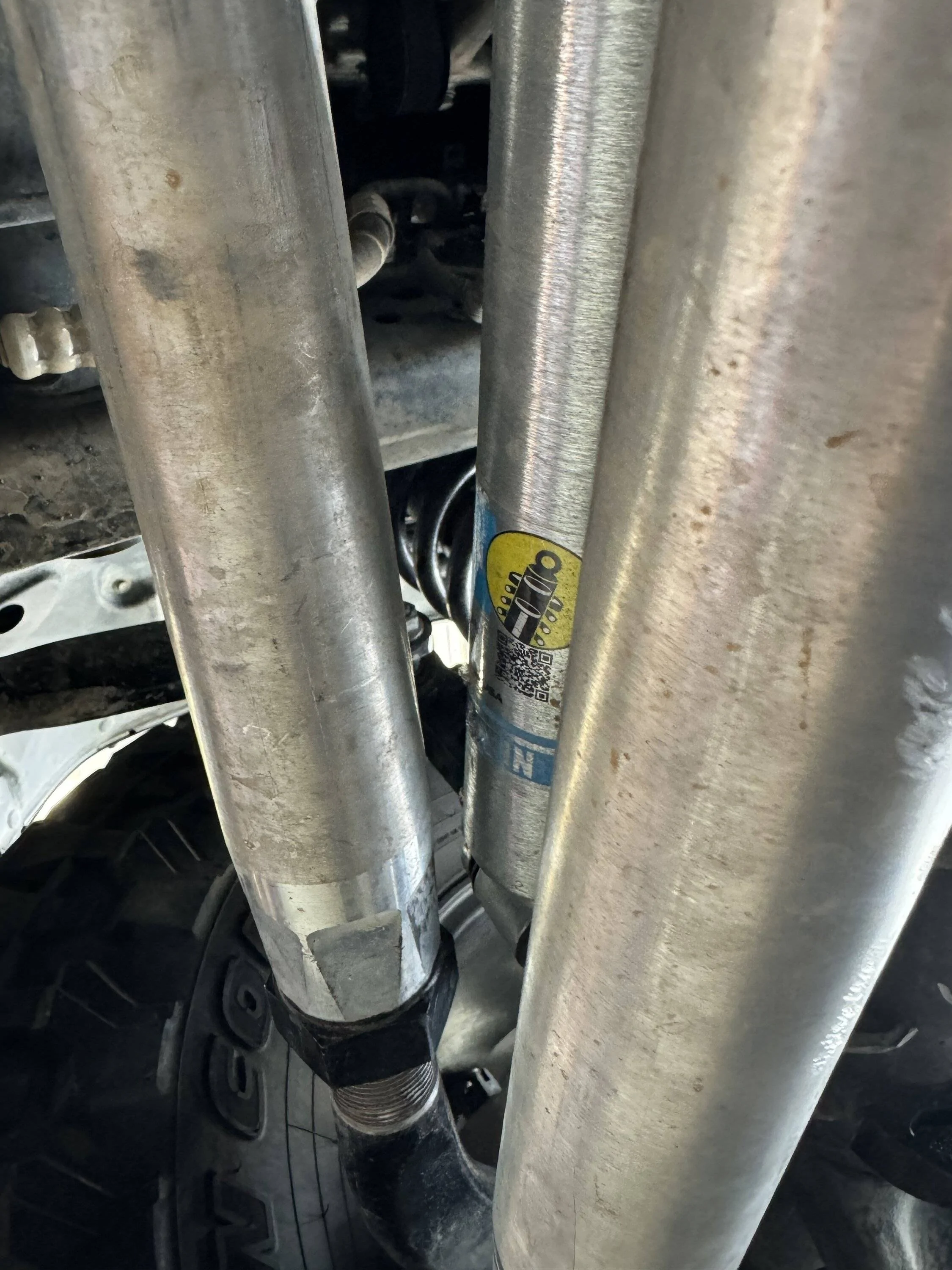

Well I'm a fan. Order came well packaged and everything is very well put together. Not sure if some of the other "more pricey" options come polished or what the extra coin covers but this unit is stout. The only thing I did not get was any type of instructions or link to some online, but there are plenty of tutorials on the U-tube. Mine also came with decals and the tools to attach to my ratchet to torque them down. As for my stabilizer clamp, I also went with the TMR unit and it is SOLID as well.

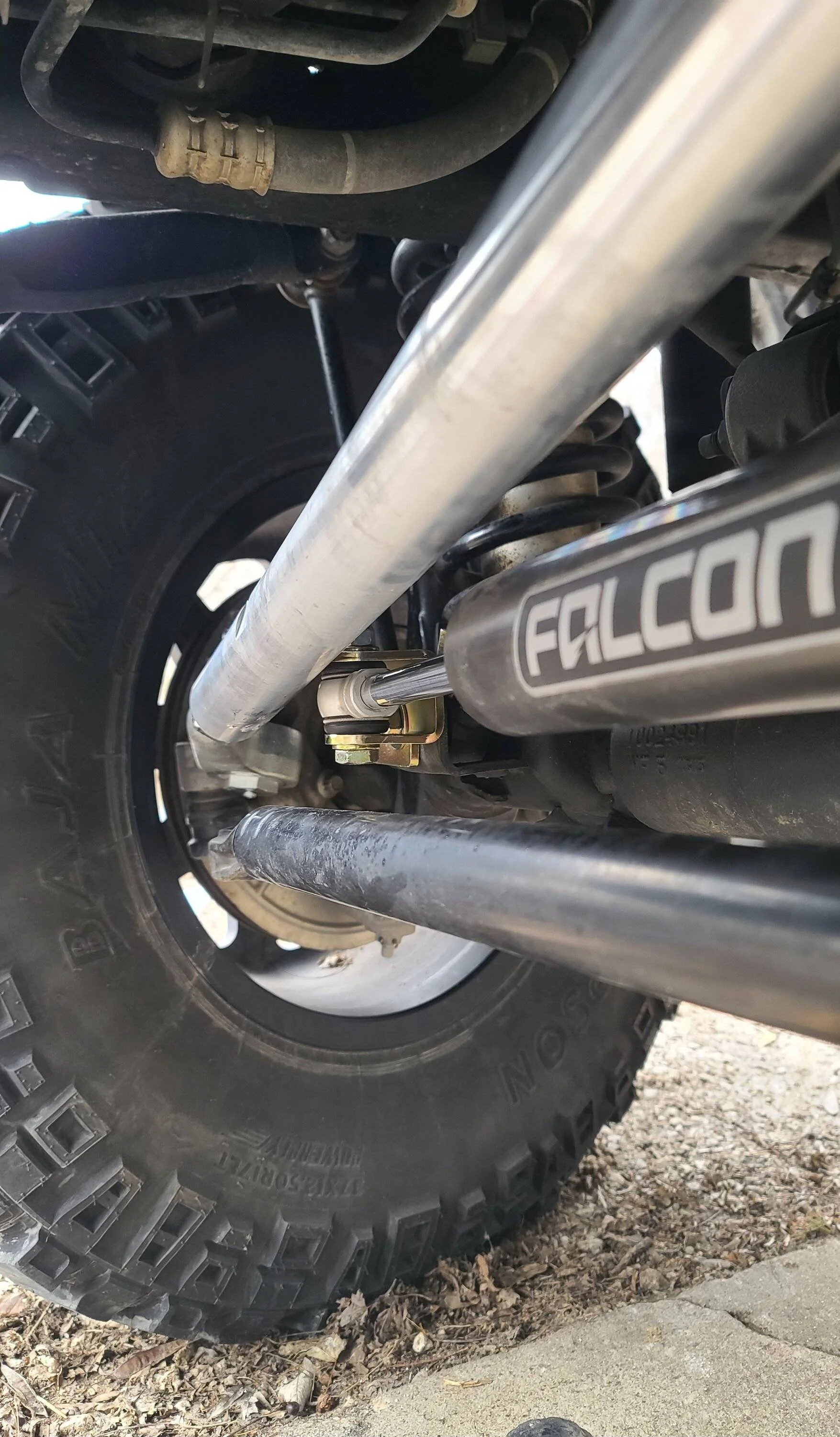

Jeep Gladiator CavFab JT 2.5 Ton Steering Available NOW! IMG_2011

Nice to see real world install, and no interference with stabilizer relocation like people have noted with the Rock Krawler bars.
GMag
George
Oct 20, 2022
39
75
So Cal
2022 Gladiator Rubicon
Yeah, I was actually worried because the shock body would come real close to the stock tie rod with the Synergy relocation kit, but the TMR clamp gave me plenty of clearance even with the much beefier tie rod.

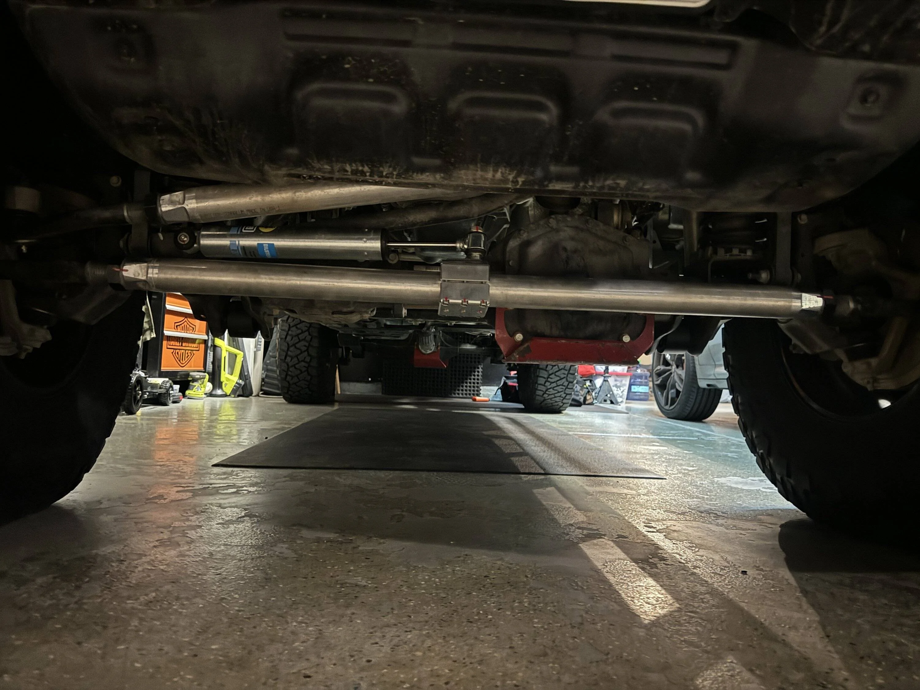

I did not find the tie rod to be an issue. It clears slightly on hard right turns. The issue for me was the drag link. Terraflex and Synergy track bar bolt mounts both hit along with the Clayton mount on a hard left. I cut the Clayton mount and moved the holes and it was closer, but still hit. I finally made a mount for now. Hopefully the rod ends on this one have more of a bend so it clears.
Edit: after reading more, I need further research before moving to high steer. RK recommends against it until 4.5" lift or higher.
How close are you to the drag link on a hard left turn?
Jeep Gladiator CavFab JT 2.5 Ton Steering Available NOW! 20240210_150052
Mine doesn’t get that close and I just added the Clayton mount so I can keep an eye on the torque for my Track bar. (Trying to chase down a light click sound).
[/QUOTE
I just added the Clayton stabilizer bracket myself so that I can torque the track bar bolt easier so you worried me but I double checked it and I have almost a full inch space between the two.
Jeep Gladiator CavFab JT 2.5 Ton Steering Available NOW! IMG_2162

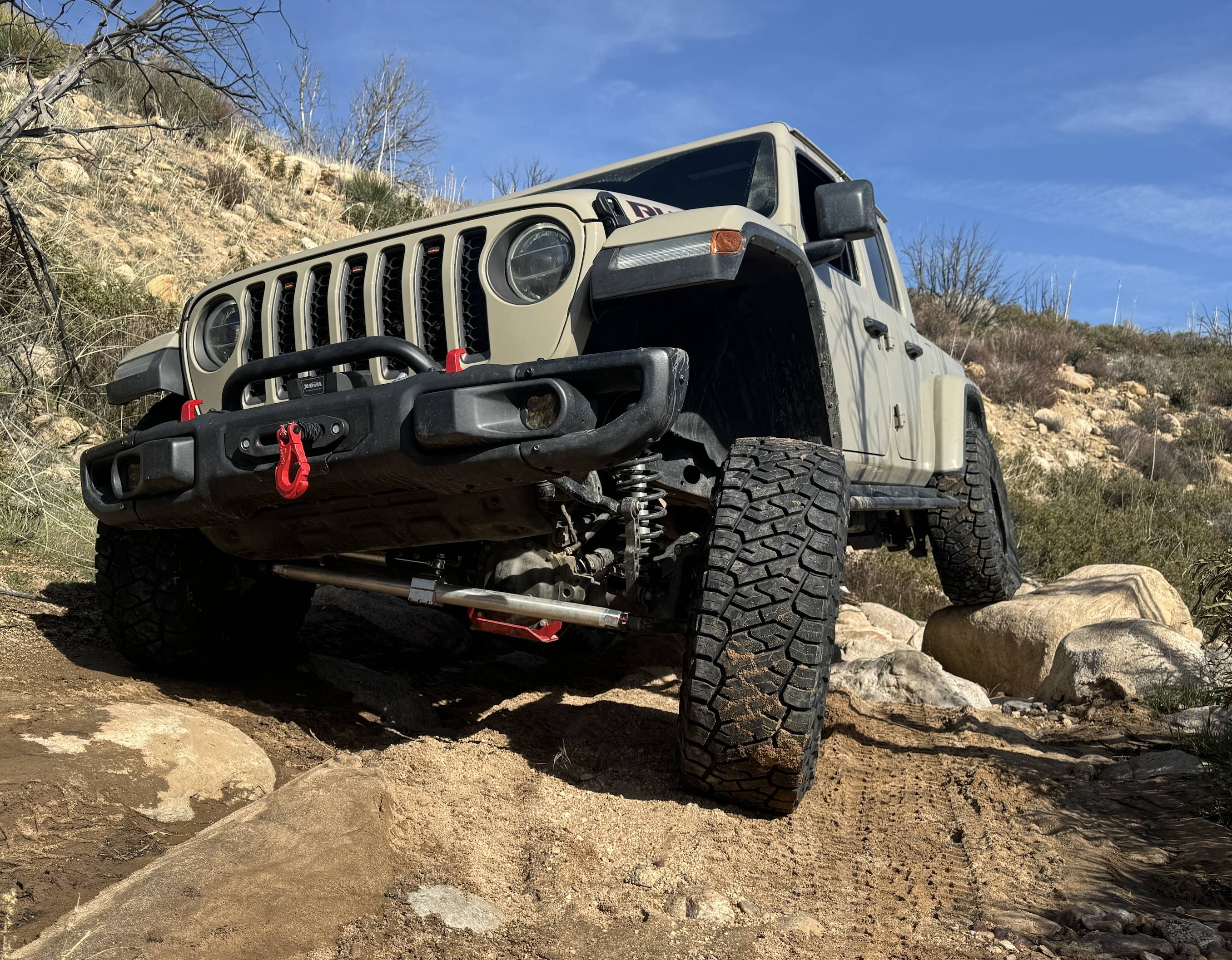

Bump! Starting to see more and more CavFab JT steering out and about
Jeep Gladiator CavFab JT 2.5 Ton Steering Available NOW! IMG_2833
