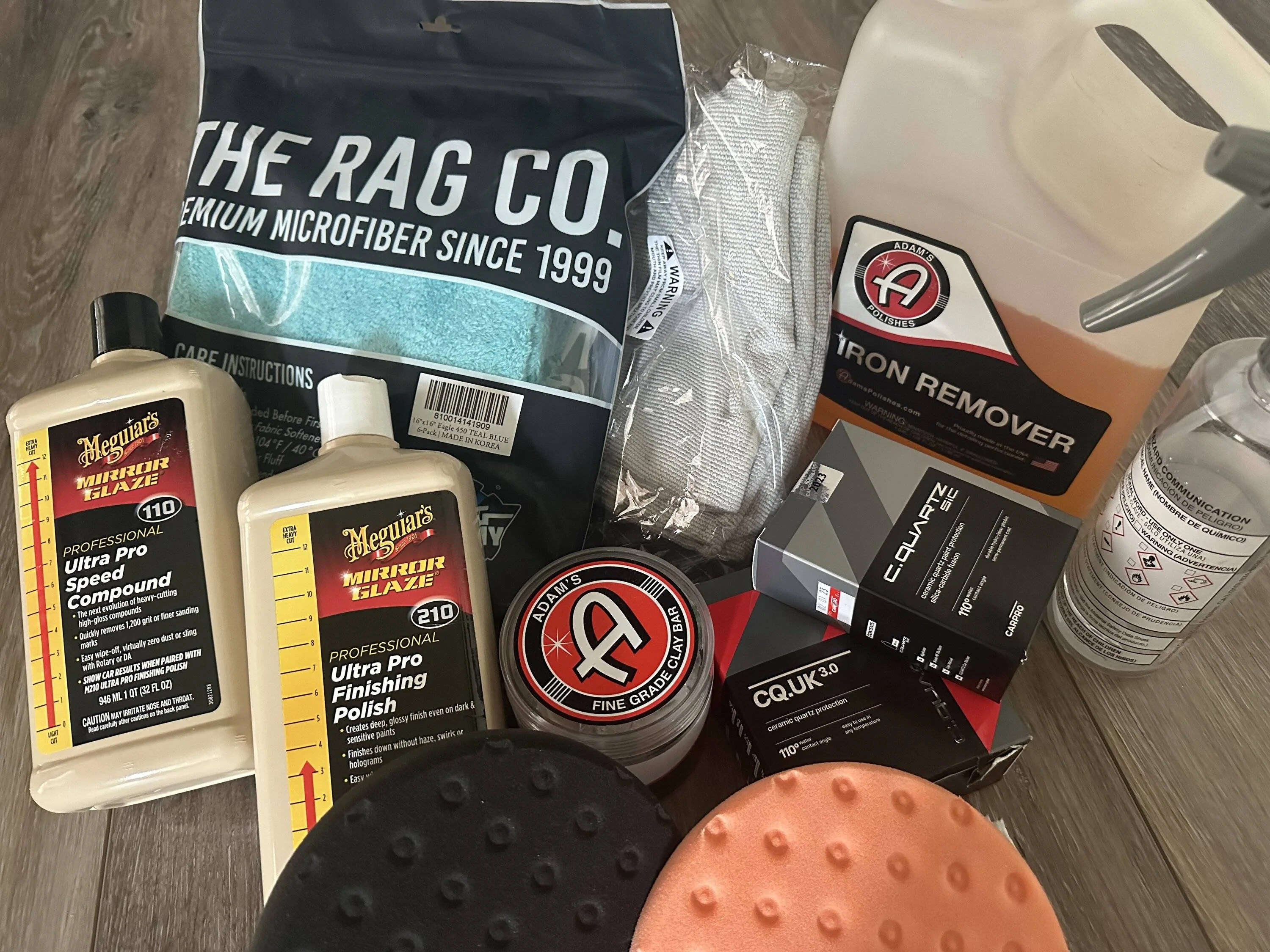

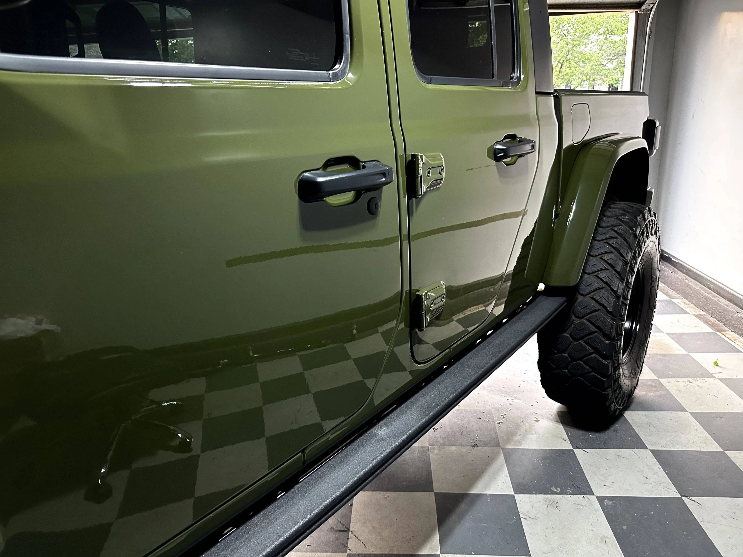

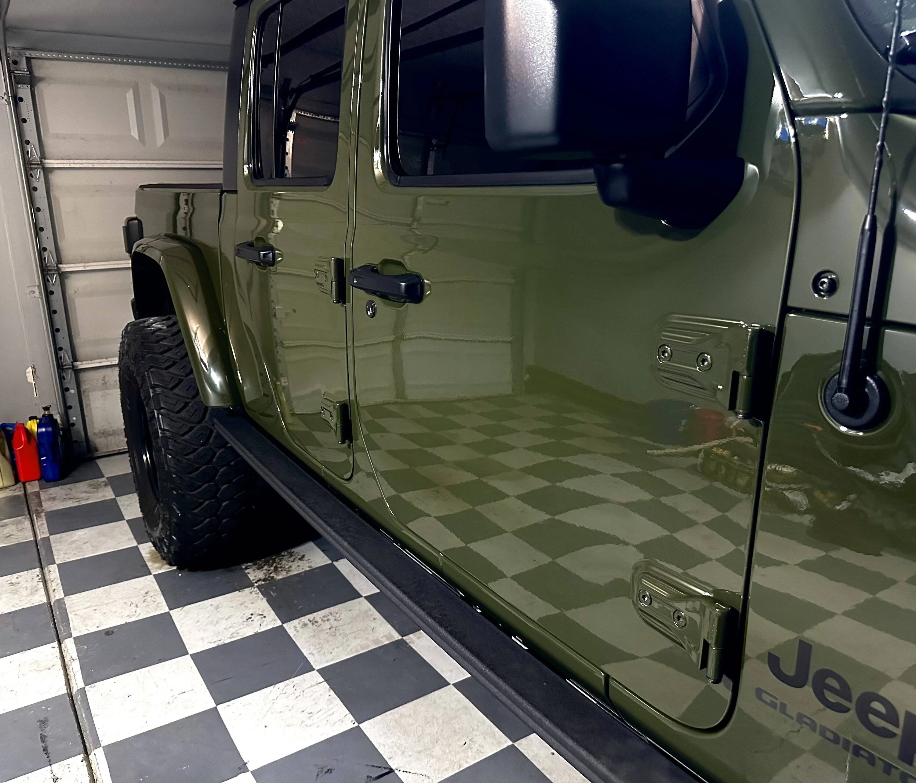

These are the products I used to do my own coating. It’s not my first time applying a coating so I am familiar with most of these products. There are plenty of step by step threads and videos about this process that you can find on YouTube so this post is not that. Just sharing what I did since I had some time off.
Jeep Gladiator Ceramic Coating? 2054069C-C5F9-465A-BC92-3C31E02E8E73

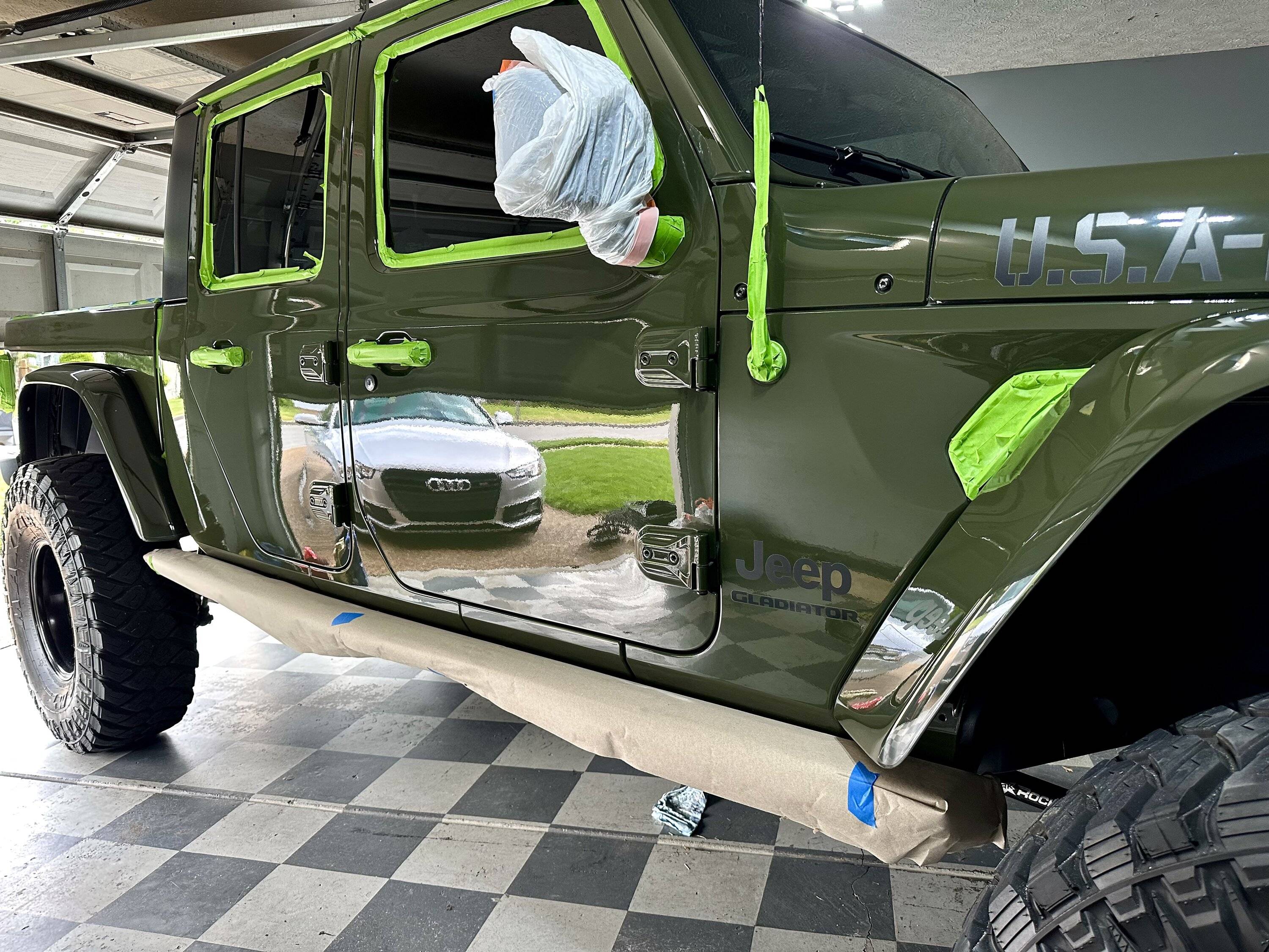

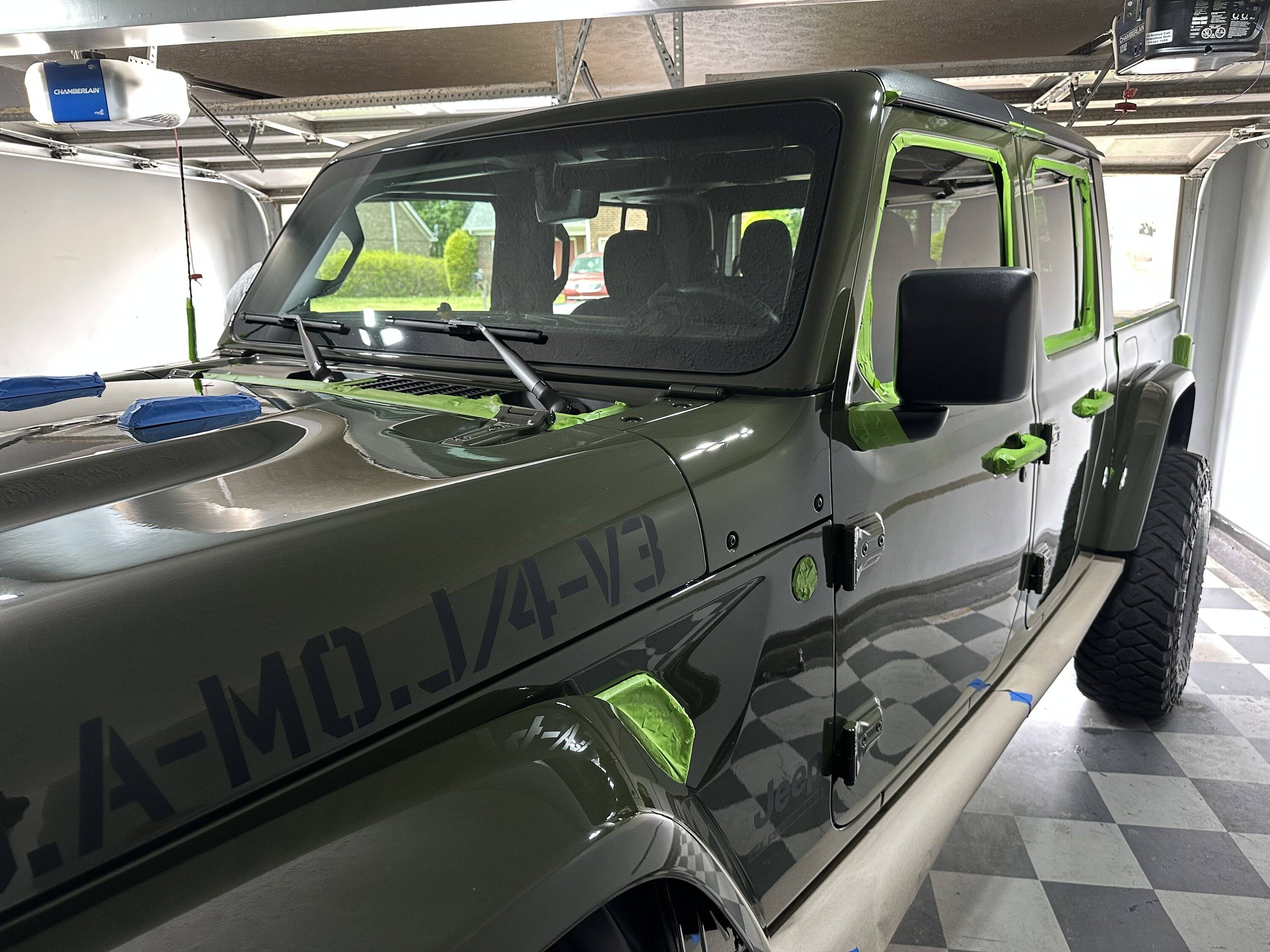

taped off the black pieces during the paint correction. Meguiars 110 and 210 are really nice to use, nearly dust free.
Jeep Gladiator Ceramic Coating? 0F5E9BB5-1FC5-4151-BA26-A8E4BE76793C
after polishing, I wiped everything down with IPA, to get a clean surface to apply the coating
Jeep Gladiator Ceramic Coating? 6AA25A68-095B-4840-BB47-0404C418F3F4
Jeep Gladiator Ceramic Coating? AC6A1252-C8DF-4FCF-ABF1-8210E050BDF2
Jeep Gladiator Ceramic Coating? EE9B1C04-E26A-49CB-A2CE-3B687C777149

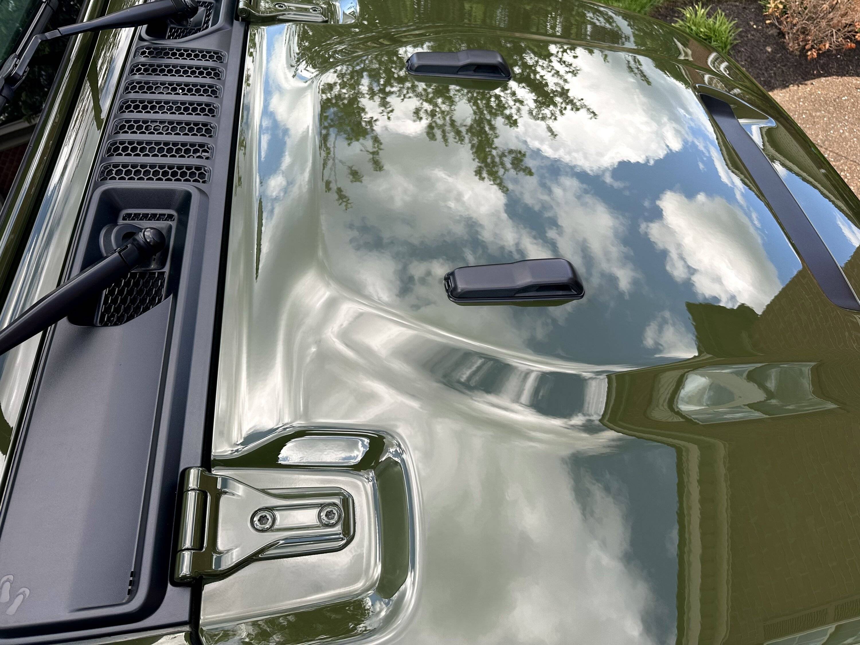

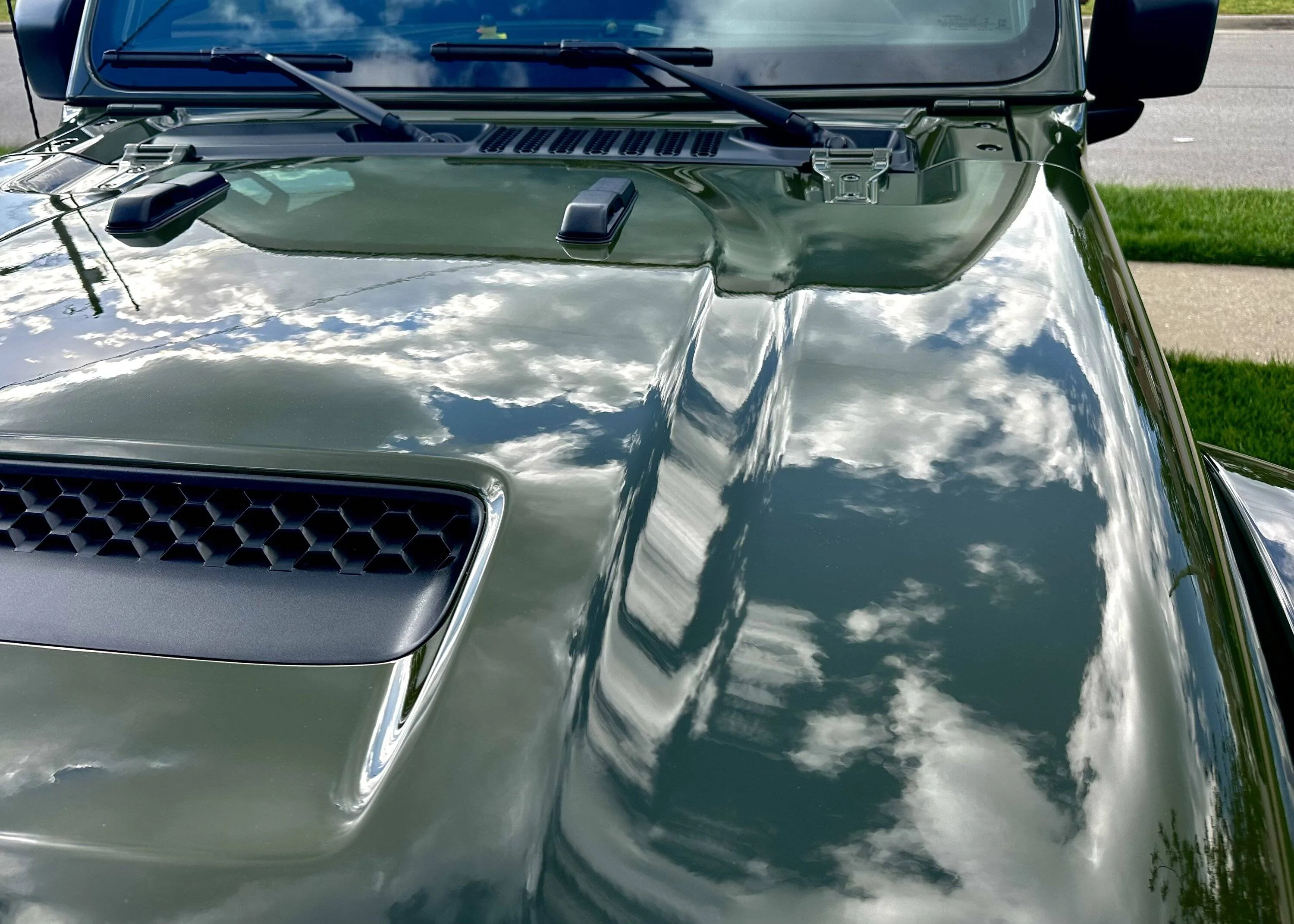

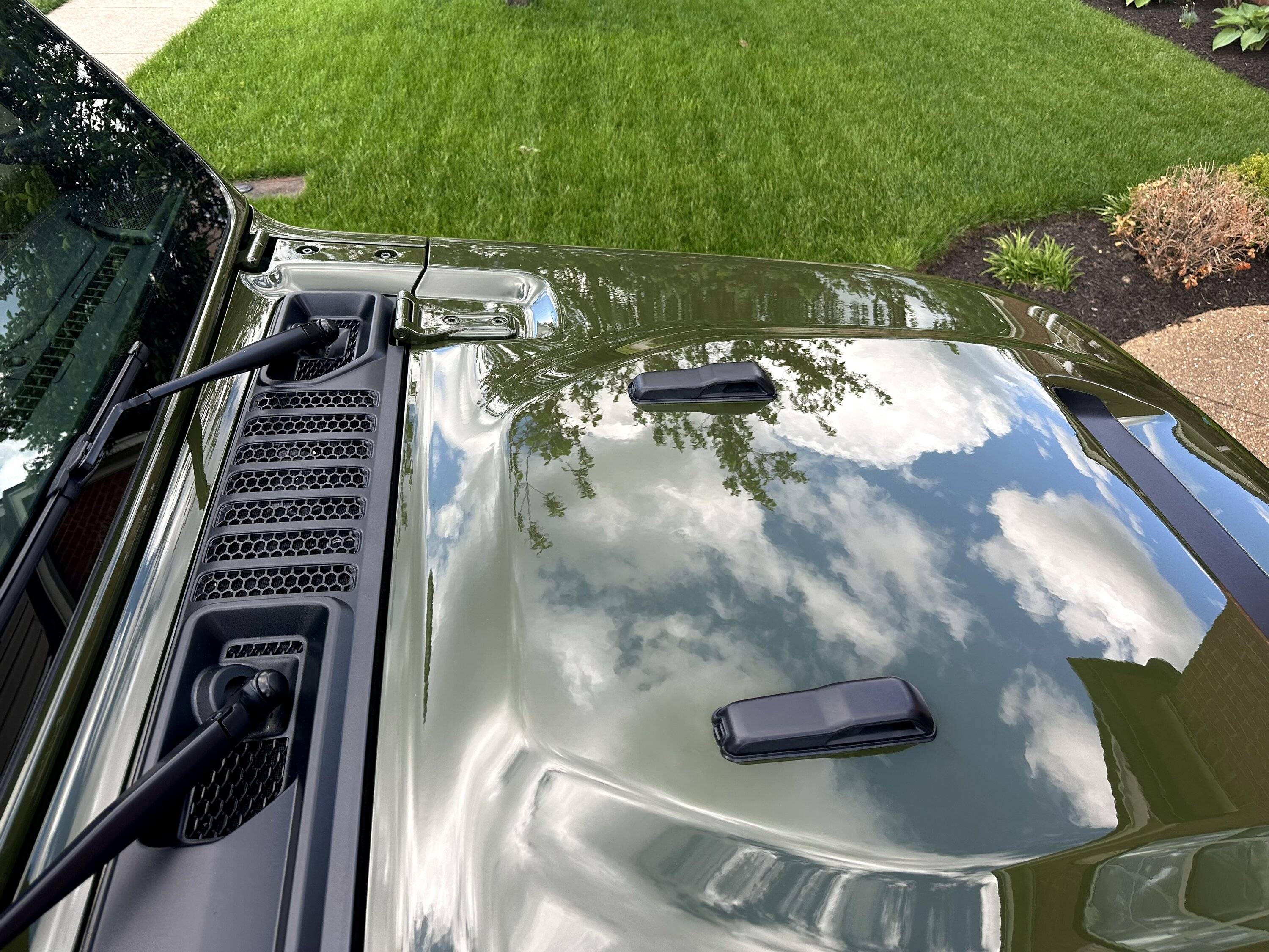

I ended up doing two coats of Cquartz UK 3.0 and then topped it with one coat of Cquartz SIC. I have used Cquartz UK on other vehicles with great results so I stuck with it, but I have never tried SIC. I didn’t think UK could get any more slick then it was but there is definitely a more slick feeling after applying SIC. Feels like it has just been waxed.
I also applied Cquartz UK on all the black trim and the hardtop as well.

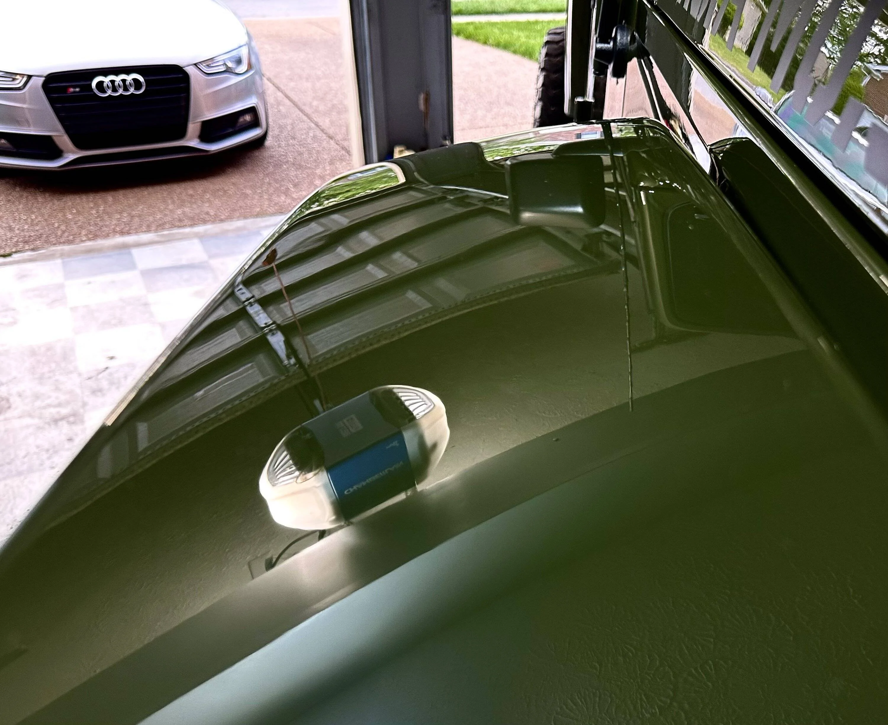

The paint is definitely in better condition than when I picked it up from the dealer.
Jeep Gladiator Ceramic Coating? 962F4B3A-EAED-4722-B9F9-4FEEFC0ACC7A
Jeep Gladiator Ceramic Coating? 56B095D9-561F-47FE-A56D-1CDF2F318C61
Jeep Gladiator Ceramic Coating? 8A262E89-CED0-4C56-8AAB-797FC879897E
Jeep Gladiator Ceramic Coating? 3CBAF77D-0727-4300-B66C-3E0E1361C466
Jeep Gladiator Ceramic Coating? 25D3D18E-A656-4BB6-9606-78BD3844E846
Looks great! Well done!

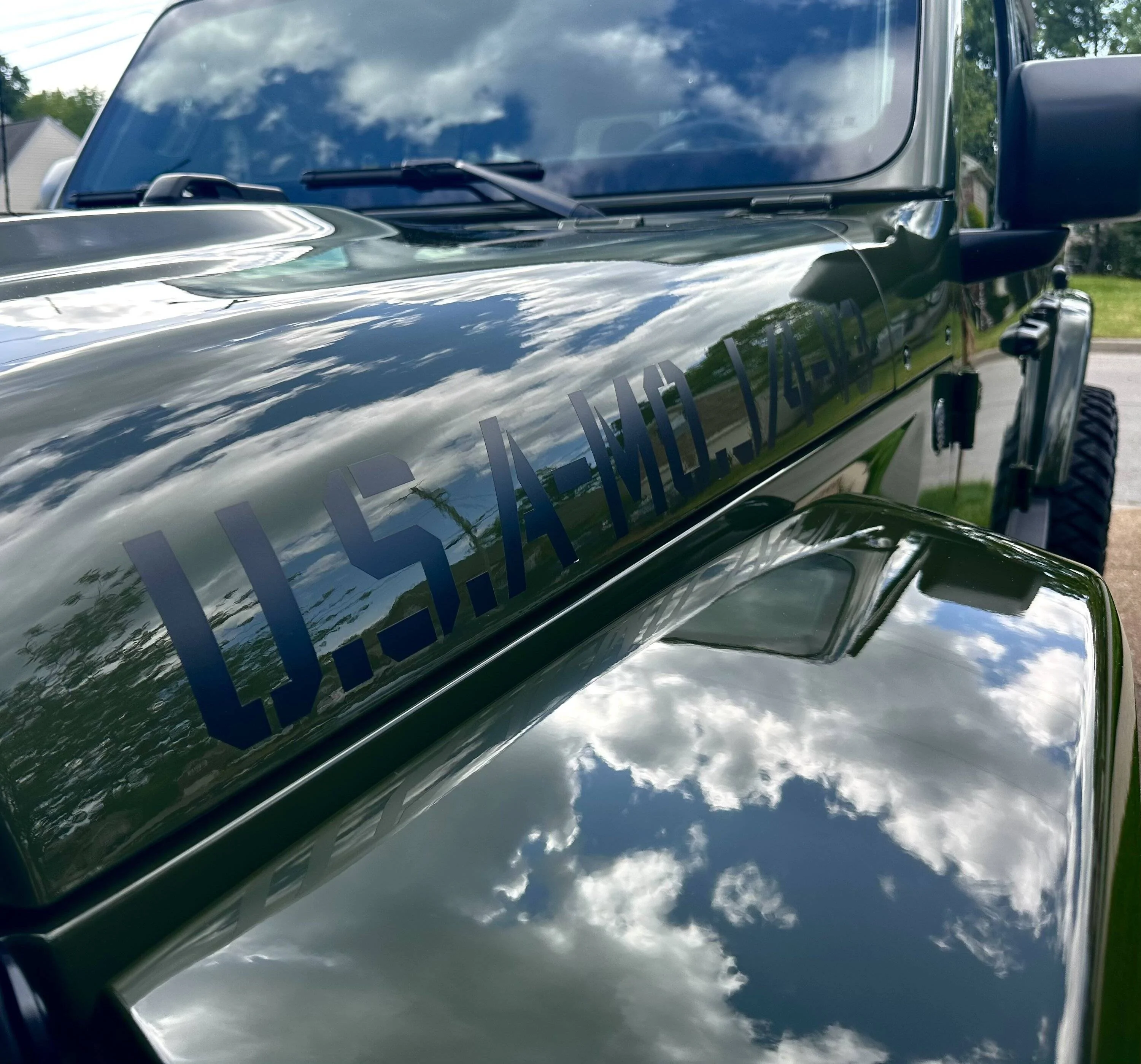

Really incredible work. I’m convinced after having corrected the orange peel on my SG, and seeing the results from others who have, that it’s the only way to pull the kind of depth you’ve achieved seen in the above from sarge. Going to give SIC a try next round, been a UKQ fan for years. DLUX is worth a shot on plastics/wheels/etc. it’s good stuff as well and has kept mine looking better than new for 50k miles.
